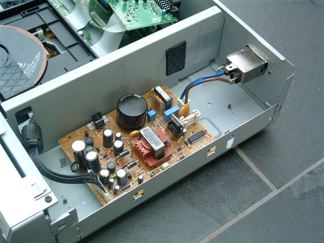

Saffier,
This is just a standard implementation of a dual polarity power supply.
I used simple fixed +8V and -8V regulators (from Digikey).
I enclose a link to a similar circuit using adjustable regulators.
http://www.aaroncake.net/circuits/supply3.htm
With fixed regulators you do not need the resistors or variable resistors, and instead connect that pin to ground.
I did add extra 650 ohm resistors from the outputs to ground to provide some extra load.
For
NJM7800FA +8V reg, pin
1. IN
2. GND
3. OUT
For NJM7900FA -8V reg, pin
1. COMMON
2. IN
3. OUT
Data sheets are here:
http://www.njr.co.jp/pdf/ae/ae06006.pdf
http://www.njr.co.jp/pdf/ae/ae06009.pdf

Linear Power supply
Thanks Eric,
This should do it. I'll get started in the next weeks. The last BG's have to be done first.

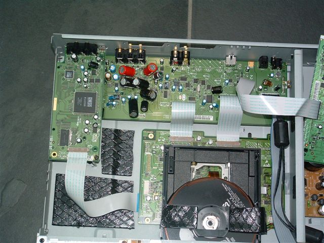

Continued audio tweaks
Bypassed #2613 with 0.1 uF MKP, and #2610 with 0.33 uF film caps.
Added 2x 650 ohm to new +-8V ouputs to add 10 mA more load to 8V regulators.
Added relay to control new +-8V supply, driven from +12V switched SMPS line. This turns off the new supply when the player is turned off. This prevents lockups when off overnight.
Replaced #2314 with 47uF BG FK to improve DAC reference.
A little confused
Hi, eganz,
Thanks for all the work you've devoted to this machine and to apprising us of what you're doing. I was ready to return my 963 as "not quite good enough" before I found this thread; now I'm making a list of parts to order.
I'm a tad puzzled by your last post, however. You say you bypassed #2613 and #2610, but on 19 January you said you'd replaced those with Blackgates. Did you bypass the BGs, or am I mixed up?
Also you say you just replaced #2314 with a 47uf BG, but isn't #2314 one of the 1,000uf caps on the video board? Do you mean #2614, which you listed as bypassed on 19 January?
I'm not sure I'm ready to build a new linear supply for the line stage, although I'd like to eventually. Meanwhile, does it make sense to replace the diodes in the existing power supply with faster, soft-recovery ones? This is easy and cheap, and has been hailed in other contexts as a dramatic improvement.
Also, what did you finally do with #2633 and #2637? You reported that bypassing them made the midrange sound glassy, but I haven't seen that you replaced them.
I'm sorry if I sound like an ignoramus; it's just that I am. Thanks for your help!

ewent,
Yes, I added bypasses to the BG at #2613 and #2610.
#2314 is on the audio board next to the DAC.
I have not experimented with replacing the diodes in the SMPS, as this might lead to instabilities.
#2633 and #2637 are unchanged.

Talking about diodes in the PSU, in the analog PSU there is a diode bridge, is it also possible this bridge to cause instabilities?
I tried doknet.nl instead of docnet.nl .Just ordered the service manual.
What about the type of relay, will a RELAY PC MNT DPDT 1A 12VDC (Digikey #Z106-ND) do the job?
Can I take the supply from the SMPS 12VDC at the cap #2215?

ewent,
Ignore the capacitor on the video board. I am talking about #2314 on the audio board. It is 47 uF and is connected to pin 13 the AD 1955. It is next to cap #2625.
saffier,
Ultrafast or soft recovery diodes would certainly be appropriate for the analog supply.
E
saffier,

Ahaaaaa!
I see! said the blind man. Found it in 20 seconds alongside #2625, just as you say. It never occured to me until your last reply that there would be another #2314, so I guess I didn't look very hard. I'm sorry, eganz. Thanks again for all your help!
+13V unregulated supply
Hi Eric,
Received the service manual today from doknet.nl , things get clearer now.
Just one question I cannot answer myself.
You stated a couple of post ago:
'Bring the unregulated +13V to input of +/- 8V supplies.'
Where does this +13V unregulated supply come from?
I know how to connect the regulated +/- 8V and ground, but the +13V got me confused.

Yesterday evening I did the second batch of BG upgrades. Instead of ST I used a FK 220uF 16V cap for slot #2235.
Innitialy the sound was disapointing to me, but after running 5 to 6 hours it gets better and better. The detail and sound stage is great, much more air to the music. Piano and violins sound more real. Percussion sounds fantastic realistic.
Some other ideas from Audio Consulting's Serge Schmidlin:
We keep the original SMPS and change the cap in the 300 VDC supply for a 33uF oil.
Going even further, we suggest to use a 10uF oil cap, a 20 Hy choke and then the 33uF oil.
The original diodes in the 300 VDC section will also be replaced by 16 ultra fast ones.
