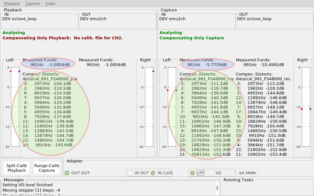

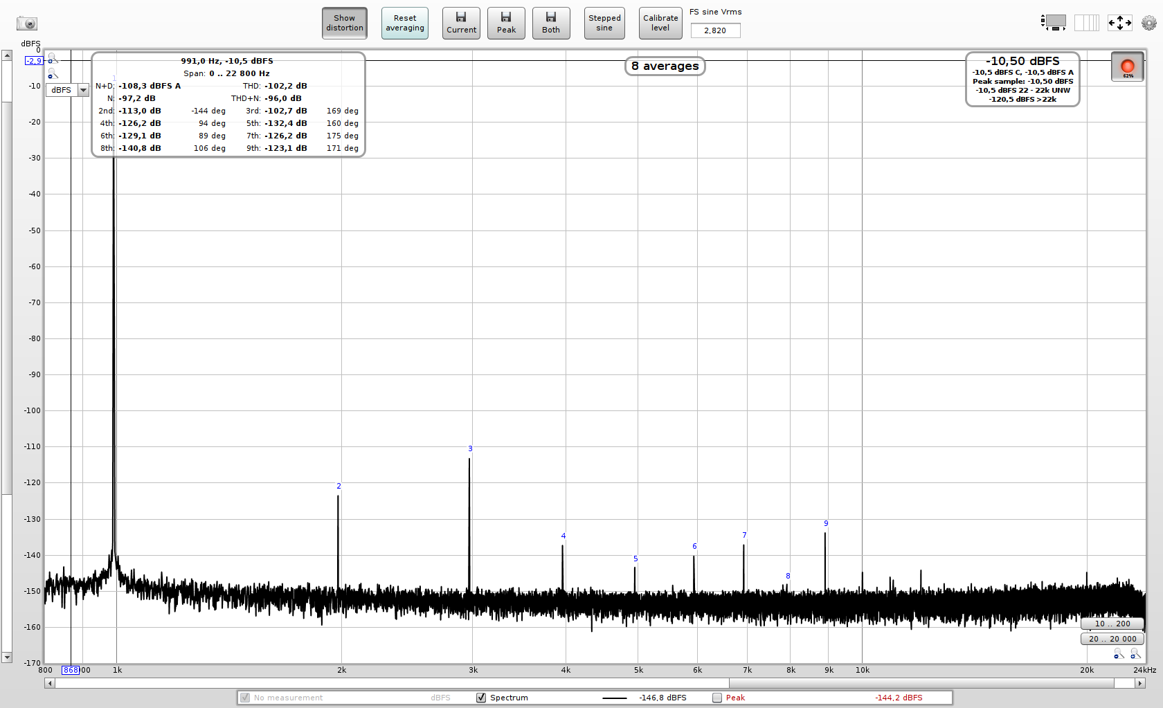

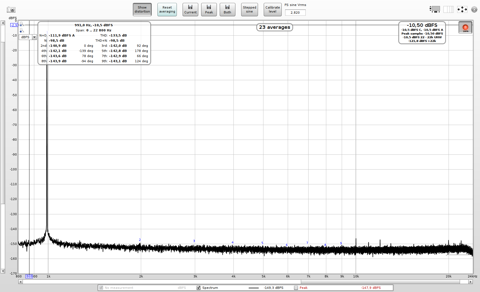

Attached is my soundcard DAC/ADC separated distortions with DAC at -1dBFS and ADC left channel at -5.7dBFS. When adding +5dB to the ADC left channel, the distortions of DAC and ADC are almost on par.
The three other screenshots show combined distortions (DAC + ADC) compensated on capture side. The spectra are for the right capture channel - the first is the voltage-divider loopback for which the distortion profile was measured - nicely compensated. But then the divider is replaced with a RC filter yielding exactly same output level - the compensation is gone in the wild. The low-pass filter (basically DUT) rotated the DAC harmonics, completely changing the previous combined distortions.
