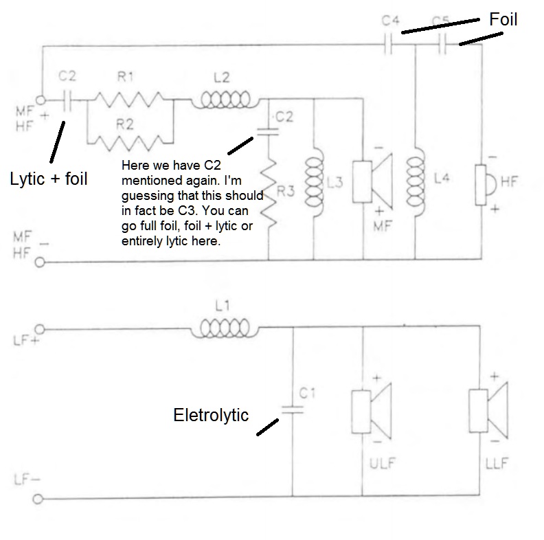

According to the B&W service manual all of the capacitors used in the design are of the electrolytic variety. These are perfectly acceptable but do not stand the test of time particularly well. The DM640s design is 20 years old. I would recommend you change the electrolytics for either new electrolytics or go for film caps.
The service manuals can be found here.
Service Manuals
As a recommendation I'd keep C1 and the C2 that is paired with R3 as electrolytics, but replace C4, C5 and the C2 that goes before R1 with decent film caps.
If the price of C2, as an 85uF film cap, is a bit much (and I agree it is expensive) I'd buy a 70-80uF electrolytic cap and parallel it with a film cap to make up the remainder.

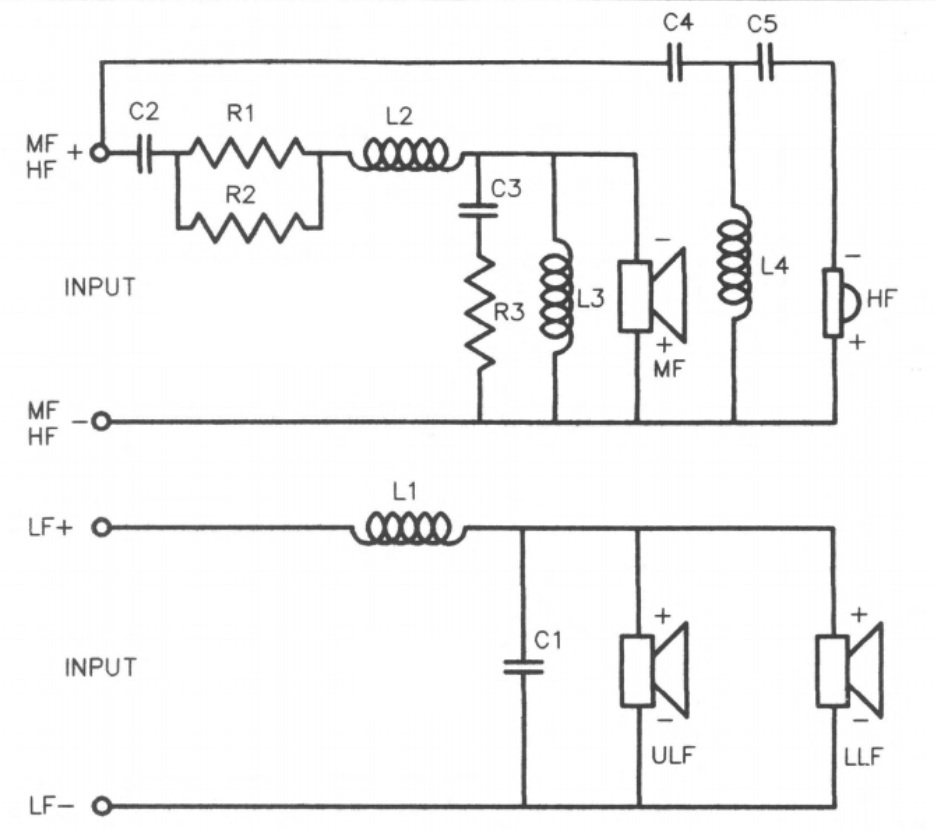

Hmm C3 doesn't exist for me at all in the service manual for the DM640. The manual for the DM640i however does list C3.
I'll do this the easy way.
DM640.
DM640i.
The 640i lists C3.

The resistors are most likely paralleled for increased power handling. It is also possible that a 4.1R resistor was not available so the parallel pair was necessary.
L2 and C2 form a 2nd order electrical low pass filter that cuts out the highs from the midrange driver. Introducing R3 reduces the effect of C2 and allows you to shape the roll off characteristics. Depending on what parameters C2 and R3 have, they could alternatively be considered a zobel networks. As R3s value is 1ohm it's unlikely to be classical zobel.

I was thinking L2/C3/L3 actually form a 3rd order filter.

L1 and C1 form a second order electrical low pass filter to cut out the highs from the twin bass drivers.
L2, C3 and R3 form a second order electrical low pass filter to cut out the highs from the mid range driver.
C2 and L3 form a second order electrical high pass filter to cut out the bass from the mid range driver.
R1/2 are used to reduce the output level of the midrange driver to suit the rest of the system.
C4, C5 and L4 form a third order electrical high pass filter to cut out the bass/midrange from the tweeter.

If you read this in a hifi magazine somewhere then they could have very well got it wrong. The design is a pretty standard three way concept that appears to be well thought out and probably well implemented. The crossover clearly shows both bass drivers being driven from a common point. If this were a 2.5 way desig, or a 3.5 way design that used a high xover point to the midrange, then the twin bass drivers would be fed a different signal.
With crossover components as large as those the xover point between the bass and midrange will be quite low, simulation shows that the bass drivers have been rolled off at about 300hz, which ties in well with B&Ws listed xover frequency of 300hz. The rest of the filters appear to be well designed too with no obvious peaking anywhere and providing the drivers are well controlled it should work well. The upper xover of 3khz is a bit high for my liking with a 6" mid, but tweeters back then might not have been quite so capable down low around the 2khz mark. B&W do seem to prefer using higher xover points though.
Without knowing how the drivers measure, the design probably goes for 2nd order acoustic filters between the mid and the bass and 4th order acoustic filters between the mid and the tweeter.
Considering some of the horrific measurements of designs that I've seen from that era, the B&W probably sounded rather good in comparison and should sound rather good today.
