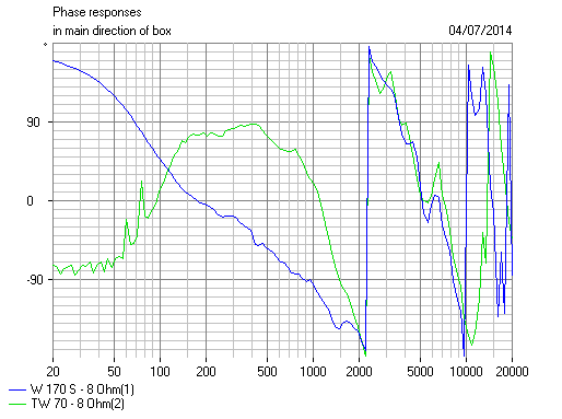

There IS a good reason to recess bass on the baffle if you wire the tweeter with negative polarity. And you sometimes might have to do that to get any sort of phase alignment on a flat baffle as I discovered with 8" bass.
Strangely, if you time align, you don't need the notches to line it all up. Troels is doing that sort of thing these days:

sreten, let's not get into one of our famous spats here.
A centimetre of alignment can make 40 degrees difference to phase at the sort of 3.5kHz crossover you might use with an 8" bass: H1659-08 U22REX/P-SL
If that means you fit the driver to the back of the baffle, rather than the front, I'm willing to consider it. I've done designs where it helps. 😀

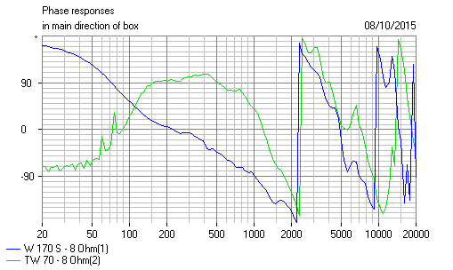

In an ideal world, we'd always time align I suppose, but that is not what we do. We tend to use flat baffles. And I assure you that Harbeth speakers are well designed, not just whim to fashion.
Alan Shaw also likes the high 3.5kHz crossover as it goes. It makes tweeters sound better.
I won't bore everyone with an example where recessing the bass helps phase, but I have one. It's an asymmetric crossover, FWIW. But if phase is aligned at crossover, lobing is horizontal, simple as that. 😀

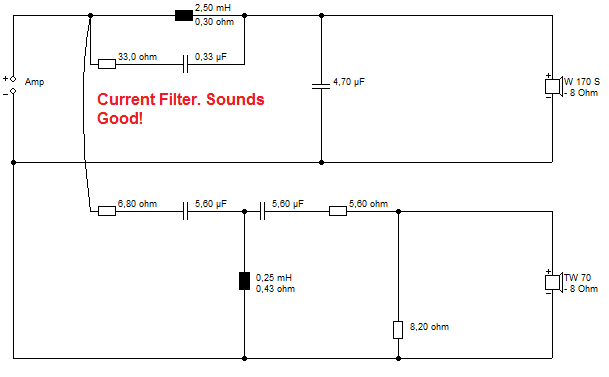

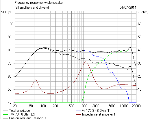

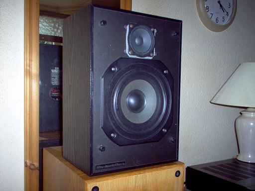

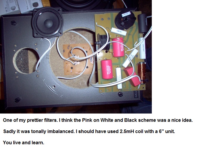

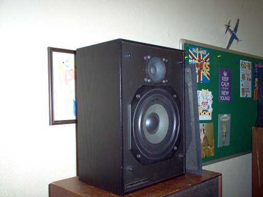

After that wander off-topic, I thought I'd update you on progress on the Mordaunt Short MS15. Which looked like this when I picked it up:

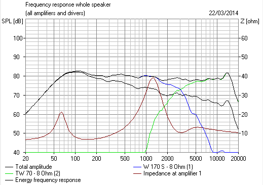

I decided the LCR section was completely unnecessary, and easier replaced by a tank notch on the bass. I went conservative with 33R on the bass notch since I was guessing on 5kHz for a 6" bass. 15R would probably work better if it's accurate.
But with LOADS of stuffing, and the 2.5mH coil rather than the suboptimal 1.8mH original, it's now sounding very good indeed. Very pleased with this design which also uses the Visaton TW70 cone tweeter. The tiny 10L box sounds very good on bass too. 🙂

The MS15 was an awful design IMO. You really can't run a 6" paper bass off a 0.4mH coil. Too much cone breakup at 5kHz. That's really what I was trying to correct. I was also trying to emulate a WLM Stella to some extent.

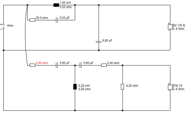

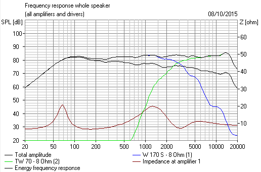

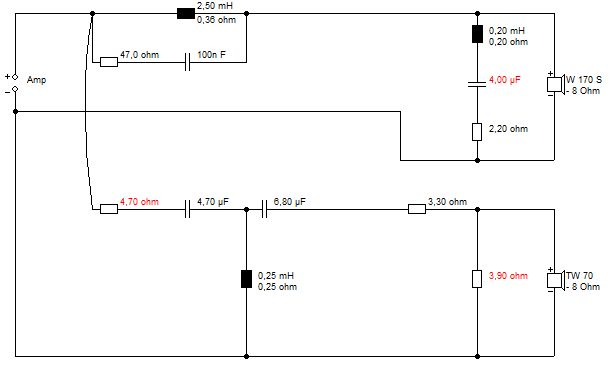

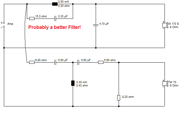

FWIW, I've abandoned that MS15 as being a thoroughly bad job. Cabinet too small at 10L. Broken and unfixable. 😡
Well, I've surprised myself! Seem to have fixed these at last. 😀
That big 2.5mH bass coil and 4.7uF just wasn't making an involving sound on the 6" bass.
http://www.diyaudio.com/forums/multi-way/221923-upgrading-mordaunt-short-ms15-bookshelves-6.html#post3980894
So I took it down to 1.5mH and 6.8uF plus the same tank notch of 33R and 0.33uF which now acts at 7kHz. Once you rest them on something, it adds a couple of dB to the modelled bass below 300Hz and it all sounds right. One of the ancient basses sounded rough when loud, so I rotated it 90 degrees to stop the voicecoil rubbing. I think I am totally happy with these now. 😎
The Visaton TW70 Cone tweeter has a bit less top than the Monacor HT22, but was small enough to fit.
