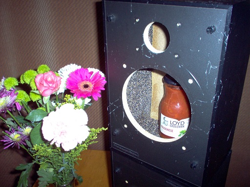

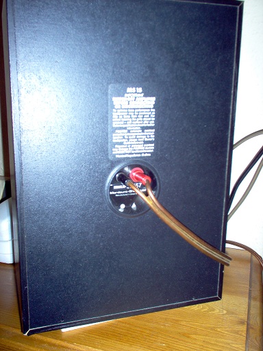

These were a fun buy. 20 year old MS15 speakers, designed by Robin Marshall at a guess. They have his style. 😀

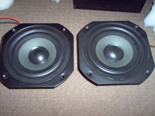

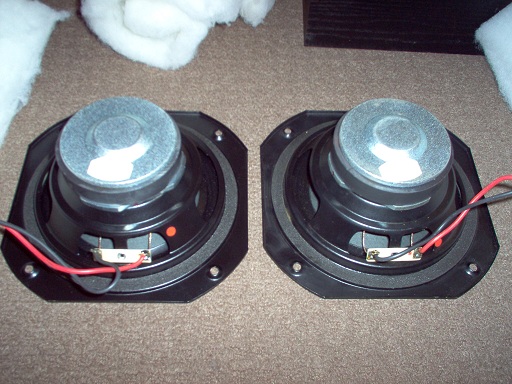

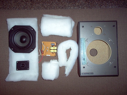

Inside is a simple 1st order bass, second order treble filter with those polyfuse things. Elac 180NS10 paper bass unit and small (ferrofluid?) polycarbonate tweeter. Lots of stuffing and a 3.3uF non-polar electrolytic capacitor which I replaced as a matter of course with polypropylene and got a cleaner sound straightaway.

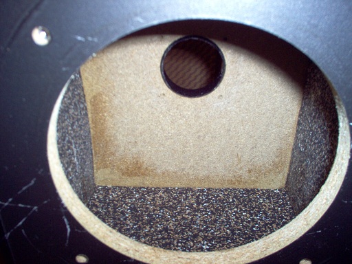

Sound is a bit muffled and it tends to sibilance at high frequencies, which I would think is cone breakup from the bass around 5kHz. I'm going to get rid of some stuffing and damp the side and top panels next in BBC style.
To this end, I've got some 4.5mm Regupol rubber and cork floor underlay and some rubber sheeting. Bass cutout is 147mm, PCD 185mm, tweeter cutout is 50mm with room for up to 72mm diameter replacement. Cabinet is 325mmx230mmx160mm, 7 Litres in golden ratio internally. Been modelling a second order crossover which looks much better too. 😎

These bass units are remarkably like the ELAC ones you quote from eBay. Just bigger dustcaps as far as I can see.

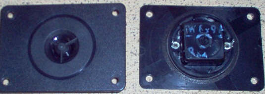

Only marking on the tweeter is TW6x9 and it's a one piece moulding AFAIK. Sound very smooth, so will persevere with them. All units are 6 ohms resistive.
Edit. Oh wait. The tweeters twist apart into two pieces of faceplate and motor/diaphragm. Hope I haven't broken the wires! LOL

Yup, it does look like an Audax TW6X9 plastic tweeter. I guess that is good. 🙂

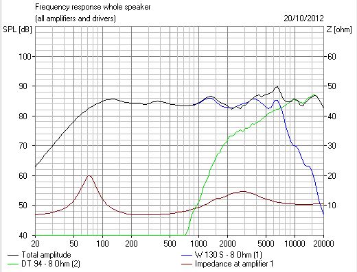

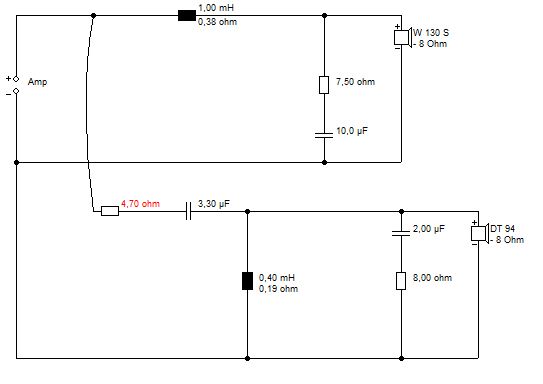

I tried to allow for acoustic centres of 50mm and 10mm here. A bass Zobel worked out best on phase and flatness with more inductance. Didn't change much else apart from increasing attenuation on tweeter and tweeter Zobel for 0.1mH. Might work. Should get rid of some sibilance with more bass riolloff, and up the bass a tidge which won't be a problem.
Now must get on with ordering the parts. The crossover board has lots of room.

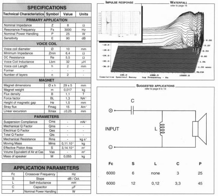

Fs is high and they are designed for a 3rd order roll-off with a single capacitor.

3rd order acoustic at 5k or beyond makes perfect sense Sreten. Back when i was a teemager these tweeters were good value, but a little difficult to use. I remember thinking that they would work better in a 3way crossed high. I found them to sound pretty good as long as their resonance was far enough out of band. However i did cut out the part in front of the dome, and that couldve made things worse. Also from recall these domes had a small nipple at the apex of the dome.
Interesting remarks on the tweeter. It looks like it has sharp natural rolloff at 3kHz and at 0.03mH vc inductance and flat won't need a Zobel. 🙂

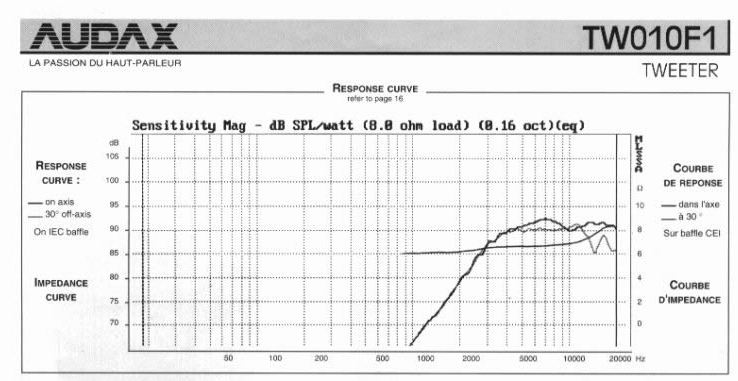

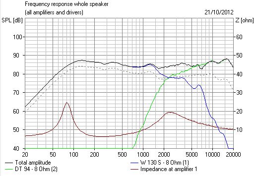

This is the Audax TW010F1, but very similar apart from the faceplate. This could work very well with the woofer which will peak around 1.4kHz on a second order. A question of suck it and see, I think. I'll leave the tweeter crossover essentially unchanged. Happens it looks very good with the Visaton TW70 too, if this all goes pear-shaped.
I enclose some data for future reference. 😎

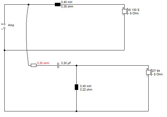

Is it with real drivers measurements?... Been modelling a second order crossover ...
Nope. Just trying to sim a paper woofer with similar electrical characteristics and align it for the acoustic centre which you can measure from front of baffle to pole gap. 😀
Bit rough and ready, but hey, what else an you do? Listening tests will show if phase is right, because imaging gets good when it is.
In fact, I'm revising my ideas on this, because the tweeter is not really much like the plastic dome Visaton DT94. I think I'll need more rolloff on the bass. Bass filters are quite predictable, IMO, as long as you account for woofer voicecoil inductance.
Don't assume the Z plane distance is to VC gap, its usually less than that, closer to 4/5 the cone's depth. That pole gap rough estimation comes from HF drivers and horns pro stuff quick set up practices where the scale and assembly are much different.
Like I say, Salas, it's all a bit rough and ready. Bass filter is going to be 1mH series, 8uF and 2 ohms shunt by the look of it. Had to resolder a broken wire on one tweeter. Teach me to take it apart. 🙂

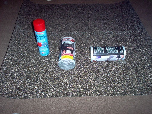

The aerosol carpet glue was more fun than a box of frogs. Most of it went on me! But job done with the rubbery and cork stuff, I think. Waiting for glue to dry. 😎

yes the FR looks fairly good. I couldnt find or recall the details at the time, but my comments about the obvious resonance if crossed too low or shallow are still relevant, in my mind at least. I have no idea what causes the effect i perceived. All i know is that i didnt like their low end reproduction. Whilst theyre a classic high value tweeter, they were cheap, so hardly flawless.Interesting remarks on the tweeter. It looks like it has sharp natural rolloff at 3kHz and at 0.03mH vc inductance and flat won't need a Zobel. 🙂

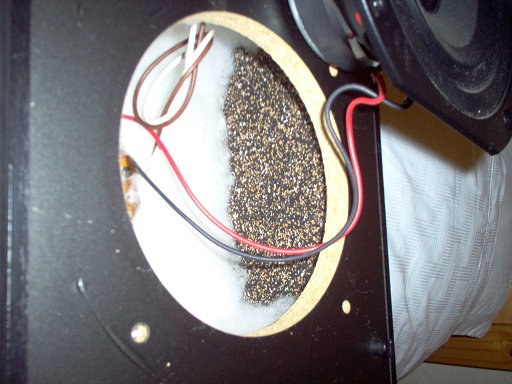

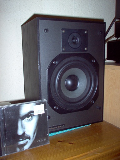

Got them back together with the cabinet changes. 😀
4.5mm rubber and cork panel damping underlay on the top, bottom and sides. A single sheet of BAF wadding on the back. The BBC idea is you add damping to the smaller, more rigid panels. The front and back panels will flex more with added mass, so don't damp them.
Bass is LOVELY and smooth and deep, 4cm from the back wall as recommended. Midrange seems to have more detail. The side panels are a lot more inert. This is really what you'd do with bass reflex on accepted ideas, but this is closed box.
The top end is still letting things down a bit. Sibilant. Might be dried-up ferrofluid, or the cheap tweeter itself because the treble crossover is OK. More work to do. Enjoying this. 😎
After extended listening, I have put all the the wadding back in the (closed box) cabinets. It's one of those tradeoffs that seem abound in audio, and a bit frustrating TBH.
The speakers were just TOO LIVELY without it, and fatiguing in the midrange to listen to. Maybe it's the paper bass and the lack of rolloff in the cone-breakup region due to the simple single coil bass crossover.
Maybe what I have done is balance the relatively lively paper bass with heavy damping from the wadding. It might work better with less wadding on a plastic cone. This is a shame though, because the bass is just not as clear with all the wadding.
Ah well. They are decent little speakers anyway, but I don't think I want to fiddle with them any more. Other fish to fry. 🙂
