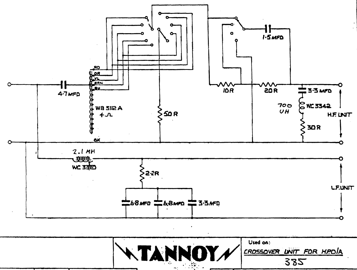

The first thing I recommend is separating the two halves of the crossover and feeding signal in via two sets of speaker terminals.

Thanks Andrew for the quick reply. Instead of modifying the original crossover, i am putting together a new set using sonic caps, mills resistors and foil inductors. Can you help with redraw the schematics for the "flat" position (this is how i listen at home and like it this way) and without the switches, Thanks again.
Join the Tannoy Yahoo group, everything you need to know can be found in its archives and if that is not enough someone will run you through what should be done.
The main thing other than bypassing the switches would be to hard-wire the xover rather than trying to pump all those watts through pcb traces and changing the caps.
Unlike Andrew bi-wiring is IME fairly pointless, especially in view of the other improvements which can be done to the standard Tannoy xover.

Note that you have a tapped inductor in the treble circuit. Unless you normally listen on the second position from the bottom (green tap) it will be hard to duplicate the circuit response without this part. Also note that the bottom of the inductor goes to ground (black) although the drawing doesn't show it well.

Yes!!!
Do not damage the autoformer in any way or remove it from the circuit.
They are rarer than hens teeth and essential for the xover to function as planned.

I guess I will have to stick with the original crossovers and just upgrade the parts then. Many thanks for the info. Save me lot of time doing research.
