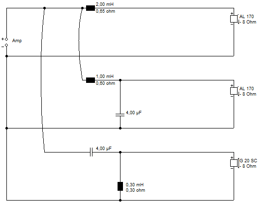

This crossover is probably an inductor for the woofer, an inductor and capacitor in series for the mid, and a second order filter for the tweeter. Depending of how the three drivers over lap each other in the music you can move their crossover points up and down for less over lapping by adjusting the value of the capacitors. The tweeter has no resistor. You may want to add a 1 ohm resistor to the tweeter and see how that sounds. You can add it between the wire and one of the connectors of the tweeter.
Its a 2.5way and the x/o is certainly not as described above.
Lower unit is rolled at off at ~ 600Hz by the cored inductor.
Upper unit is a 2nd order filter to roll it off at ~ 3KHz.
Tweeter has a 2nd order filter to bring it in at ~ 3KHz.
Probably the mid/treble low pass filter is applied to the
bass/mid driver and the bass driver with a series inductor,
in parallel, if it isn't, it is probably worth trying this.
Replacing a cored inductor for a 0.5 way driver with an
expensive air core is not going to be as effective as
you might think, compared to a bass/mid.

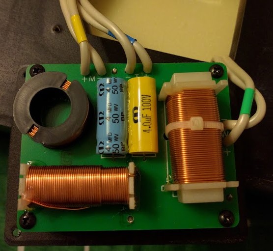

You can replace the capacitors with the better ones like Clarity Cap ESA 250V or V-Cap OIMP 250V.You don't need to replace the capacitors with the greater ones (bigger size and more expensive unless you like the sound from the capacitor which has greater voltage like Mundorf). If I were you, I will left the inductors untouched because every inductor has its DC resistance.If you change these inductors with air-core inductors which have different DC resistances you changed the sound of the whole system.Your speaker may not sound good after it has been modified unless you have software and measurement microphone to measure your system and do some adjustments.
Well, one thing is for sure. That crossover is hideously cluttered! 😱
Those coils must be interacting with each other a LOT! Not good...😡
FWIW, soaking the whole thing in hottish water softens the hotglue enough to get most of it off and disassemble.

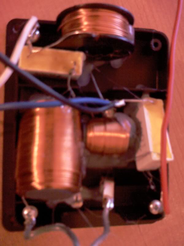

Heya I finally find my old docs and photos, hopefully they are of some use.
How to
Unscrewed all the drivers and removed the cables (+ and - are marked.)
Unscrewed the cross over back plate.
removed the 4uF cap.removed the 8uF cap. replaced with cw 8uF and two caps in parallel 3.3uF and 0.68uF
(Audio-Grade Polypropylene Axial Capacitors)
Cladding
The cladding inside the silver 8i's is just foam... replace it with actual audio cladding for a couple of quid using the foam pieces as templates for the audio cladding.

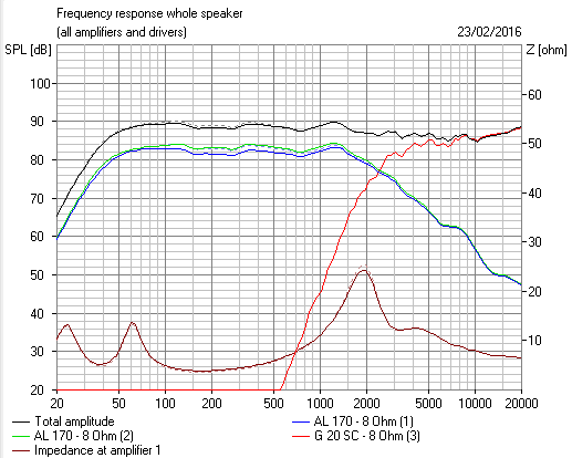

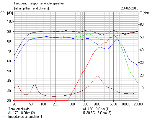

I can see some problems with this speaker. Specifically the two metal basses have significant output at 5kHz into harsh breakup region.

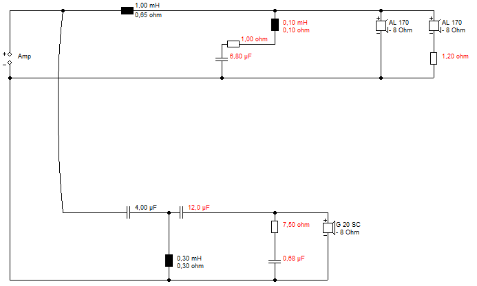

Below is what I think we decided was the simplistic crossover. TBH, I think it might work better with an MTM or here a TMM parallel arrangement and a 6kHz LCR notch if the basses share a cabinet volume. The 1.2R is just a modelling marker to separate the response graphs of the basses, and is not fitted.
The rest, 12uF and Zobel, on the tweeter filter is optional. But does something good IMO. I wonder what the DC resistance of the basses is? Must be around 10 ohms IMO. Fiddling with component types will make far less difference than a redesign IMO.
