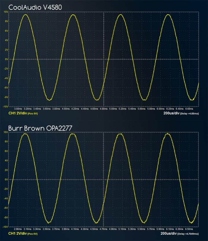

Hi all,
even this topic is rather old i want to share you my experience with the BCD2000.
Actually i changed the output-stage from Cool-Audio V4580 to Burr Brown OPA2277. Even if main params did not changed, the sound is a bit "creamier" and punchier now. (Which means, it is not better but different) This might come from the rather slow slew-rate, which is at 0.8V/µs. Max output is at +18dBu @ 1kHz. (Same as the old one)
Even if the OPA2277 has a little more voltage-noise, the THD is less at all. I measured some specs of both opamps and can say, the 4580 is not that bad, even the rest of the design in the Behringer-device...
So changing the opamps wont make it any better, just different. If you like the tuby-kind Burr-Brown-sound, give it a try.
The only strange thing is, why Behringer put the output-stage right on top of their SMPS (PSU).
Chris
