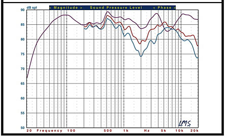

Here are a couple of measurements I came across.
The first is Violet curve: pseudo-anechoic response on the tweeter axis, averaged across a 30° horizontal window, combined with nearfield responses of the woofers and port). All measurements were taken at 1 meter.
Pseudo-anechoic response, off-center in the horizontal plane, at 45° (red) and 60° (blue).

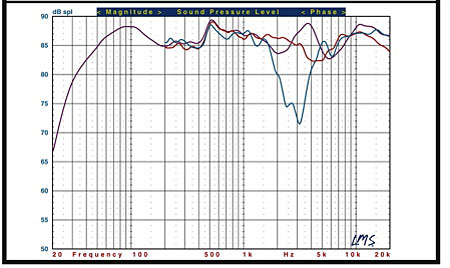

The second,pseudo-anechoic response at 15° above (red) and 15° below (blue) the tweeter axis.

B&W are well known for their kooky crossover designs that like to fit into a simpler is better plus we like to cross 6-7" midrange drivers over way higher than they should
As you can see, the measurements above highlight this quite nicely and their 800 series is no better. B&W do however engineer nice cabinets and drivers. Upgrading crossover components is really pointless in my opinion and if any improvements are to be had going this route then they are going to be very minimal and mostly in your head.
What these really need is a crossover redesign and get that cover down to around 2kHz.
