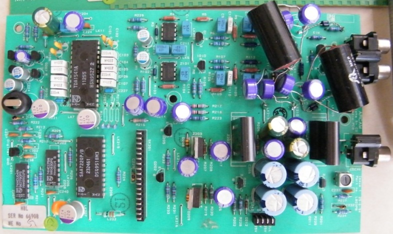

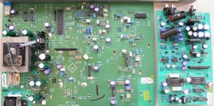

Today, Just finished my own AA5+
the upper (Analog/Out-put) board
"replace all resistors in signal part and feedback loop
""replace 4 single opamps
"""replace all decoupling cap
""""lift 3 resistor and get 3 line from link pin to TDA pin 1,2,3 for making the nos DAC.
the lower board (PS and Digital)
"replace all diode in PS part to schottky type
""replace filter cap (Rubycon ZL and Nippon chemicon KZE)
"""replace all electrolytic caps(Decoupling caps)
the result
the sounding is not likt the original AA5+ ,
new sounding like the combo CDM9 transport+ good nos DAC
very glad, but I think about the next step more improve the sound , may be must improve the chassis and tranport with damping material and add some weight.
