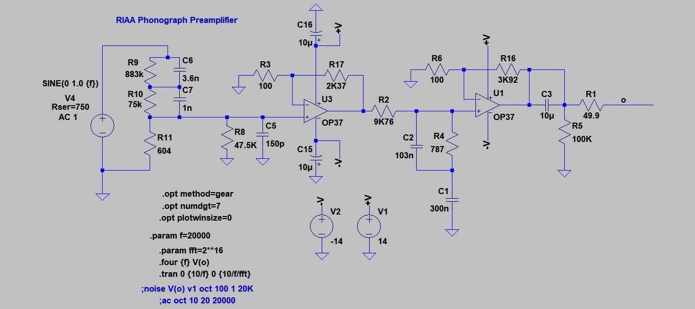

I am thinking of using some ready made phono stage preamp kits sold by Aliexpress to carry one some RIAA projects simulated on LTSpice.
Some of them are interesting to use as a base to experiment with several circuit geometries and values, having first simulated them in LTSpice.
Let's begin with this Aliexpress RIAA Kit.

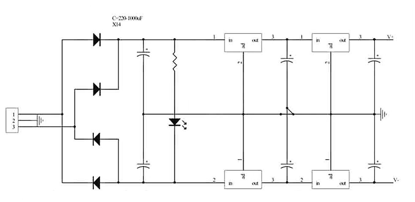

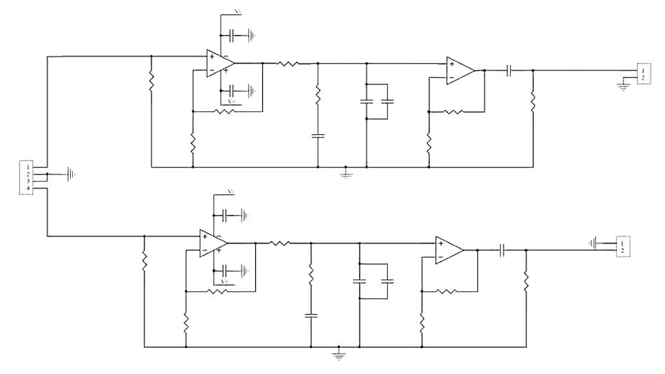

See below the basic schematics for power supply and RIAA preamp. The preamp is a classic passive eq two stage design.
As some time ago I did a lot of LTS simulations with several circuits, I will definitely try the parts Walt Jung recommended for passive RIAA preamp.
But the kit as it is has only ONE major problem: The IC they used: OPA2134. You won't get good quality for phono preamp.

The larger modifications will be to the kit power supply, as I don't think is as low noise as this preamp demands.
I'm open to comments, critics and feedback.

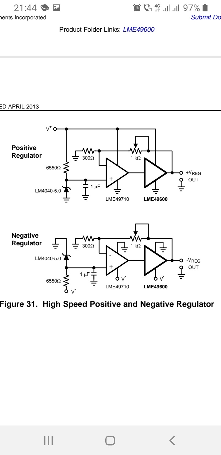

You don't need a fantastic power supply with these Ic's they have enough PSRR and CMRR to work without any regulation once the ground traces are drawn correctly.

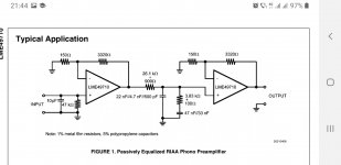

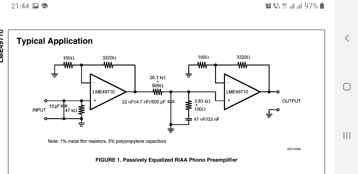

Your schematic is basically following lme49710 app note.If you want to go that route you could build their fanciest regulator , but I strongly advise you to start by supplying your preamp with unregulated supplies to make sure it is done correctly.If it's executed the right way you won't hear any noise with just a simple rc first order filter like 100ohms and 220uF capacitor.
