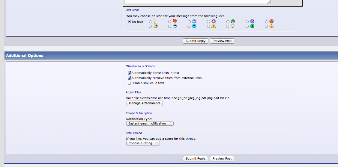

I have trouble with contact , in private , ZEN MOD, the GURU ( I KNOW HIS HIGH value!!😎
can you kindley indicate to me ( very inexpert of forums ,sorry!) which buttons I must push/selectionated, to contact directly , in private, he?
