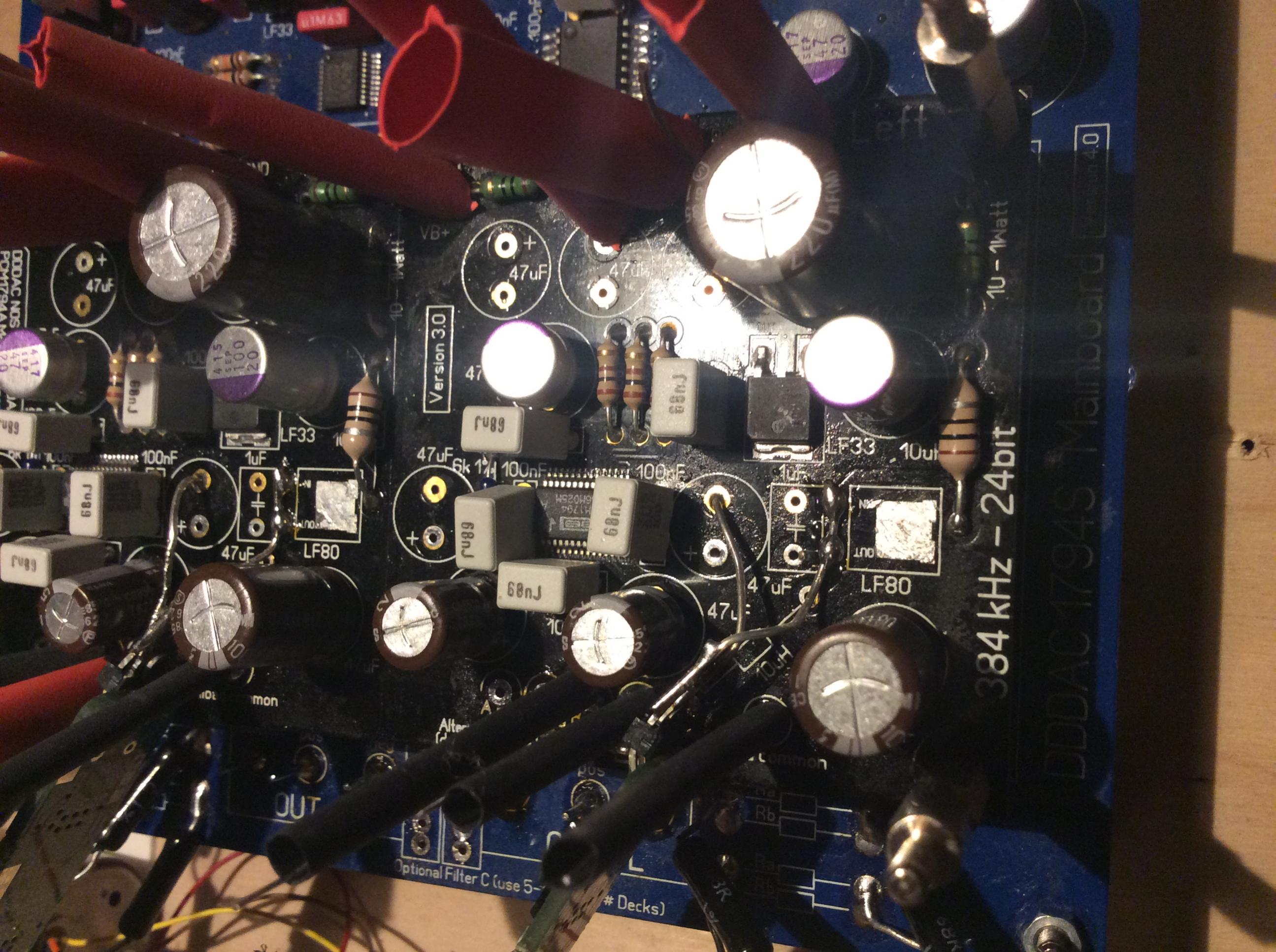

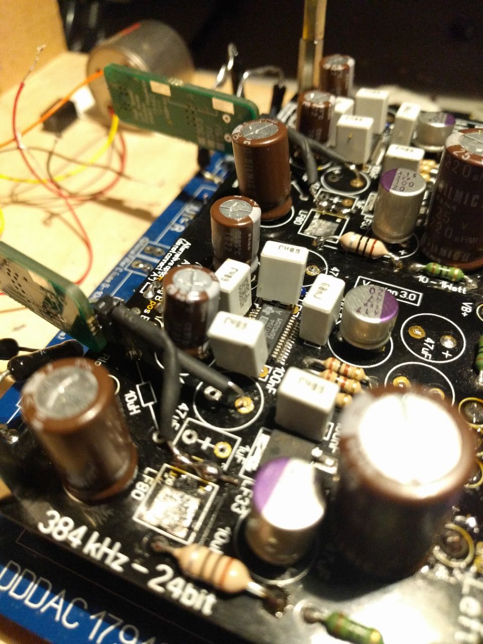

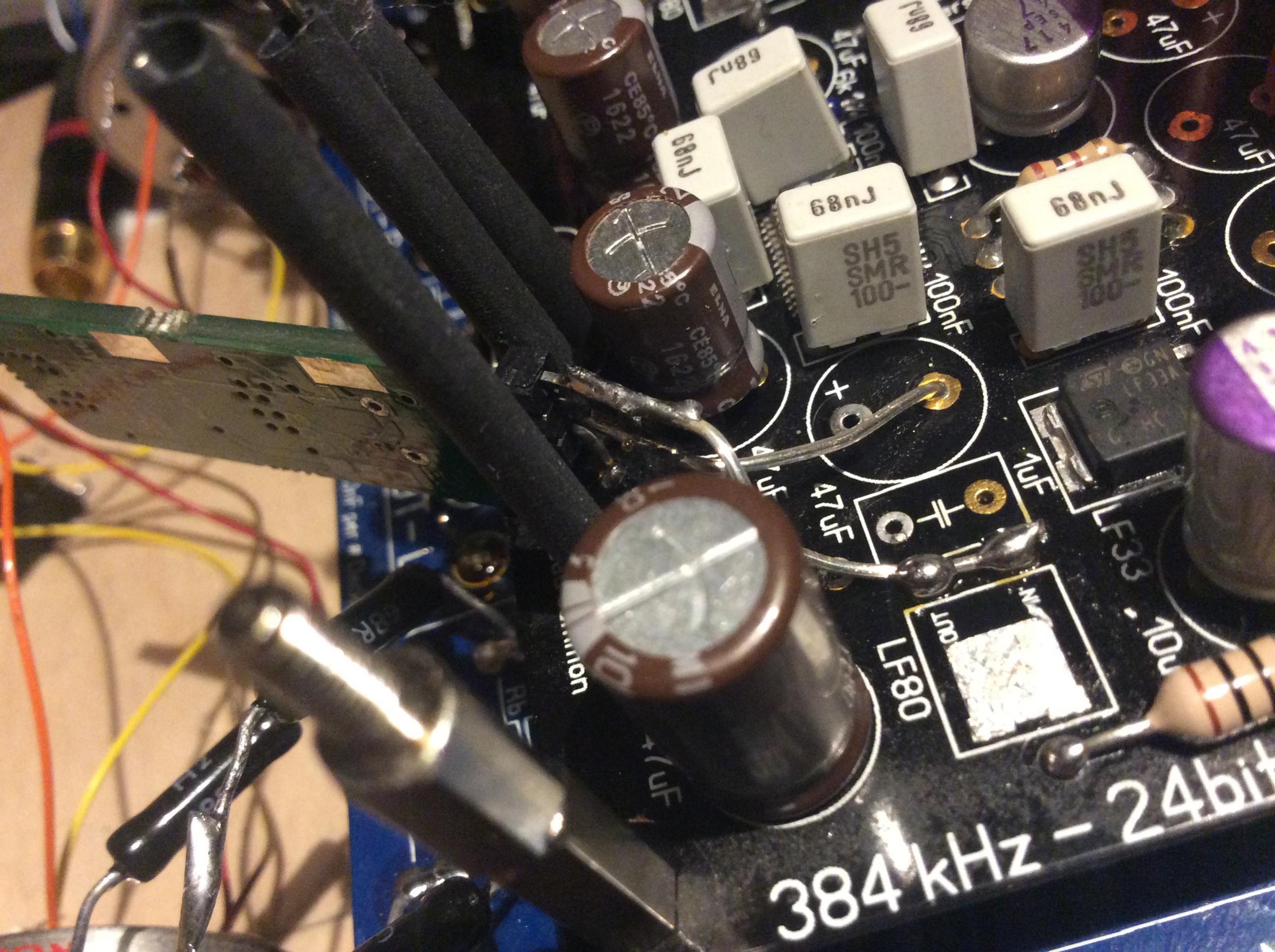

Hello guys,
I just got some 8v tentlabs shunt regulators, after installing them I measure about 4.5 dc one side and 4.6 dc the other side. The sound as a result is quite distorted. I redid most if not all joins and read the tentlabs pdf, as far as I can tell the wiring is correct. The psu is the the one from the kit powering the motherboard and one dac board with shunts, it powered four boards before I installed these shunts. Varying input v also changed nothing and is set at about 12v, 11v at shunt input.
Was wondering if anyone had any ideas 🙄:confused
I'd remove them from a DAC deck and then connect them to a power supply with "simple" load... a few watts resistor of some 200 ohms or something similar.
Allright, thanks.
Measuring between out and ground yields ~8.2v, so they seem fine... only had a 68r lying around, with it as load or just the multimeter in between both yield the same voltage. I mustve screwed something else up.
Tomorrow Ill go over the joins again and maybe try a different dac board.
The next few things I'd check are:
1. Is the input voltage at least 10V DC?
2. Is the impedance the shunts need to "drive" too low, i.e. maybe you have a short somewhere as seen by shunts' output.
Good luck,
Nick
Good luck,
Nick
Well, tried another board. Same results. Input voltage from 11 to 14 same results. Disconnecting one side's regulator had no effect on the other. I could not find any shorts. Music plays, just distorted. Between the out pin and ground still measures 4.6volts pretty steadily.
My vcom caps are 47uf the big one close to the regulator is 100uf and the biggest one is 220uf. My rload is 135/136r. Could that cause the distortion? these values worked before.
I was afraid an ESD might've killed both chips on the other board, so I was extra careful with this one..
Tomorrow I'll try the other regulators, doubt they are the problem since I measured the ones that are installed right now, but can't hurt to test.
regards,
regards,
Allright, I've found the problem. My shunt board looks exactly like the one in post #3759 from the original thread. It seems I need a 30 ohm resistor to configure this shunt for the chip's current.
Post #3756 from that thread also describes the problem.
Thanks again for the suggestions Nick! 🙂
