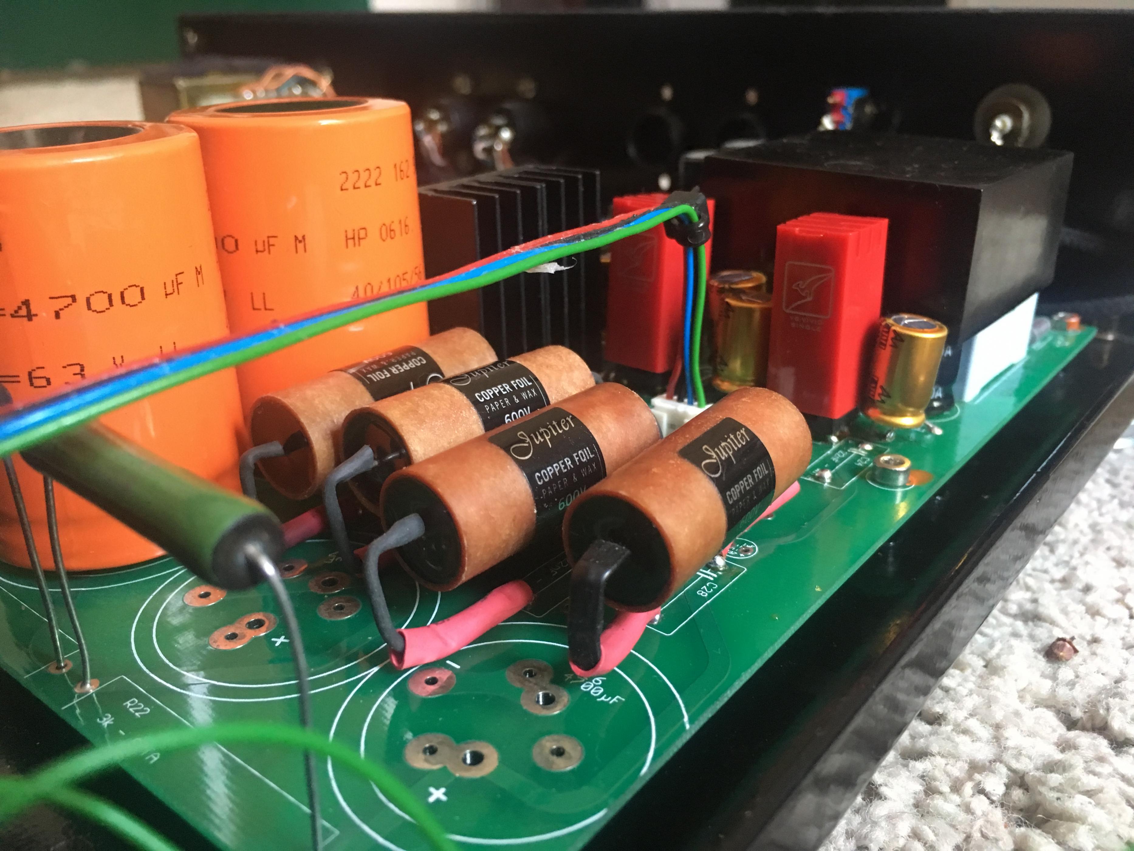

If possible. The problem is the small space for its installation. The 25V model is the most compact I've seen in this series.Just to add more controversy Toni G, my findings 50v caps of the same value mostly will sound better then lower voltage version.
The caps that I want to subsitute are bipolar. The indications of the sheet indicate this. The base plate itself indicates the polarity.Are you sure the elcos are bipolar? They have all the usual polarity markings.
The leads of your opamp decoupling caps are way to long. rather get SMD caps and solder them as close to the pins as possible.
The big problem with the components I want to replace and the extra caps that I have connected directly to the opamps is the lack of space. Even now I have doubts if it is possible to install the audio note without having to use some type of extension cable since its size is greater than that of the original caps.

The new elcos you bought are polarized, not bipolar.The caps that I want to subsitute are bipolar. The indications of the sheet indicate this. The base plate itself indicates the polarity.
Maybe this is interesting for you: https://www.analog.com/media/en/training-seminars/tutorials/MT-101.pdf
you're right. The electrolytic caps are polarized, not bipolar. like the originals...

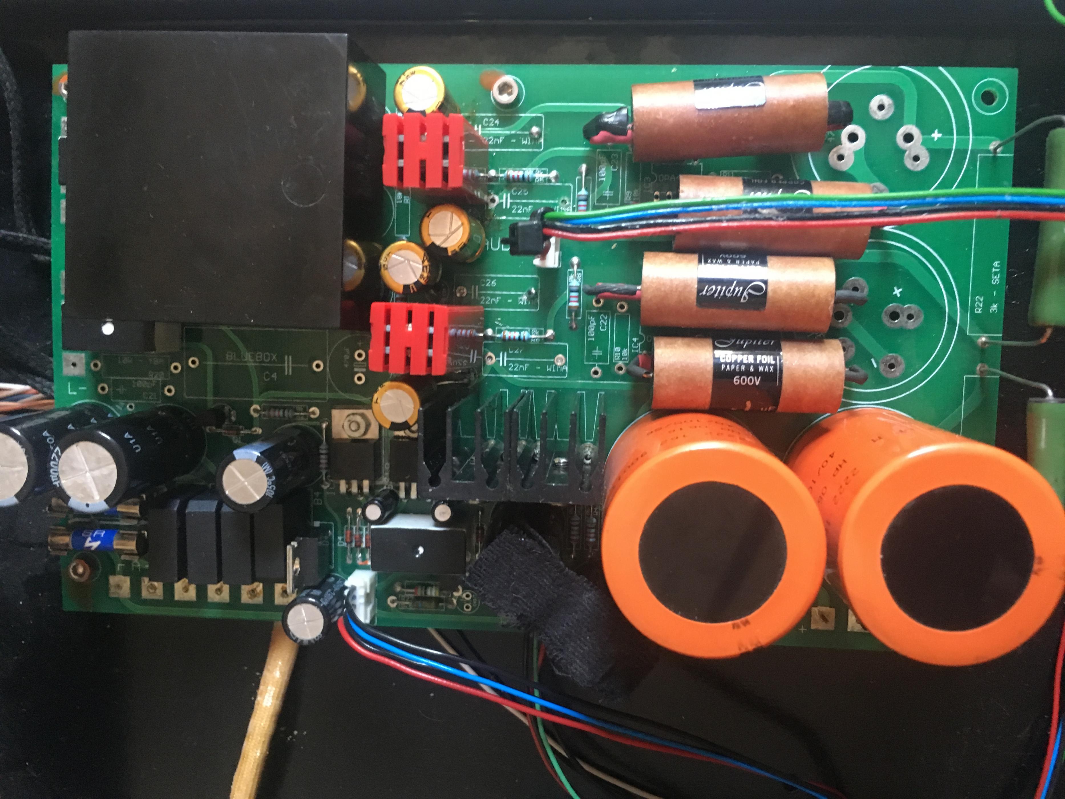

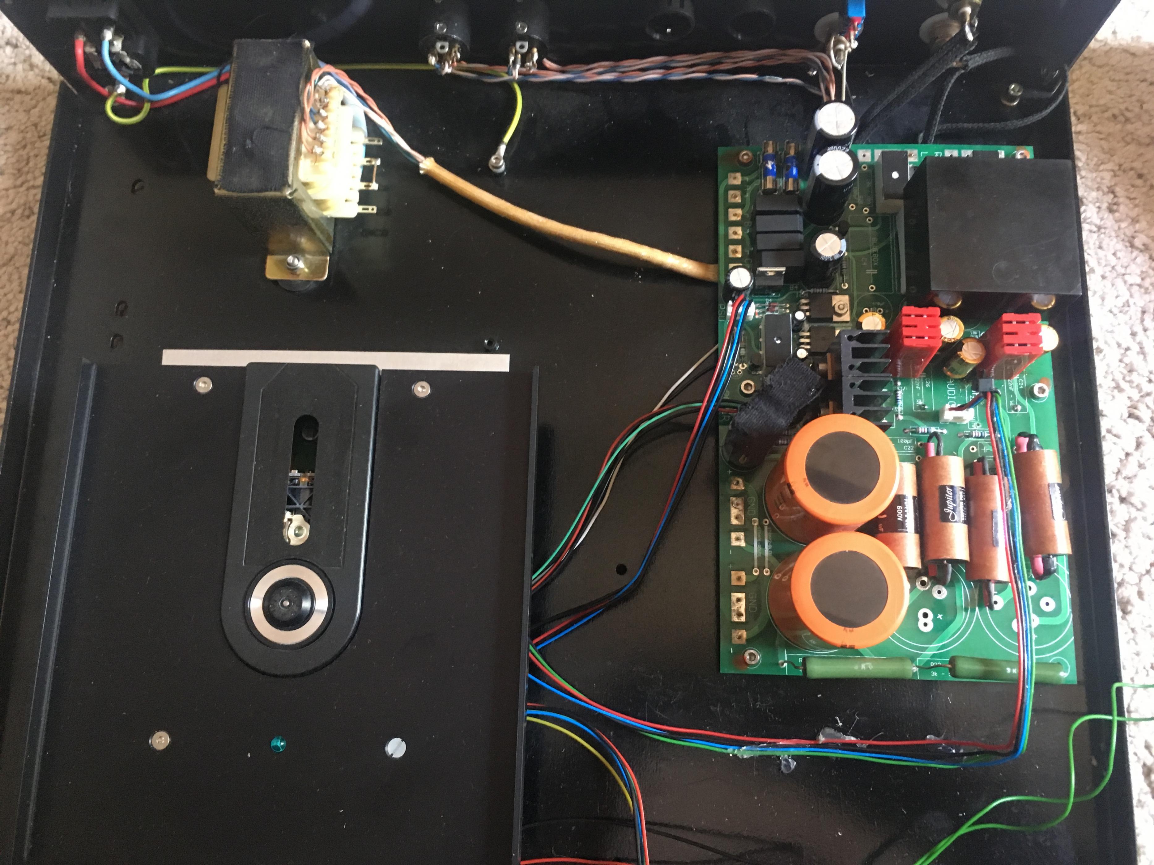

Well, I had previously installed the two Burson opamps. Then I connected two Jupiter caps directly to the caps. Now the important change has been to replace the 4 electrolytic caps factory with the audionote. With one more pair of jupiter caps, all the caps associated with the opamps have been replaced (8 in total). With the audionote the sound has softened and the mid is more present and fluid than the high frequencies. I have not won in detail and extension in the high zone but I have won in musicality. The whole upgrade as a whole makes the sound of the YBA more like the original. It is a finer, more detailed and musical sound than the original. By the way, the work has been done by a professional friend. Some welding points were quite complicated for my experience.
BR

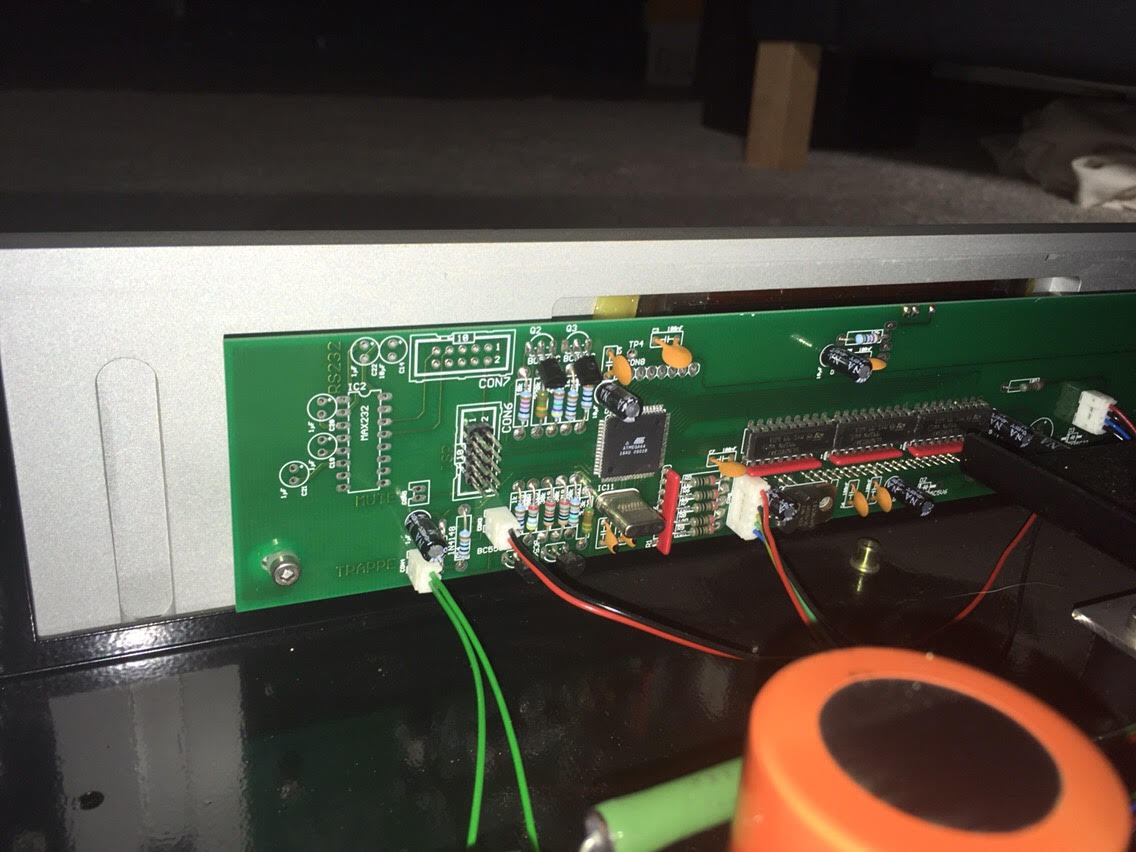

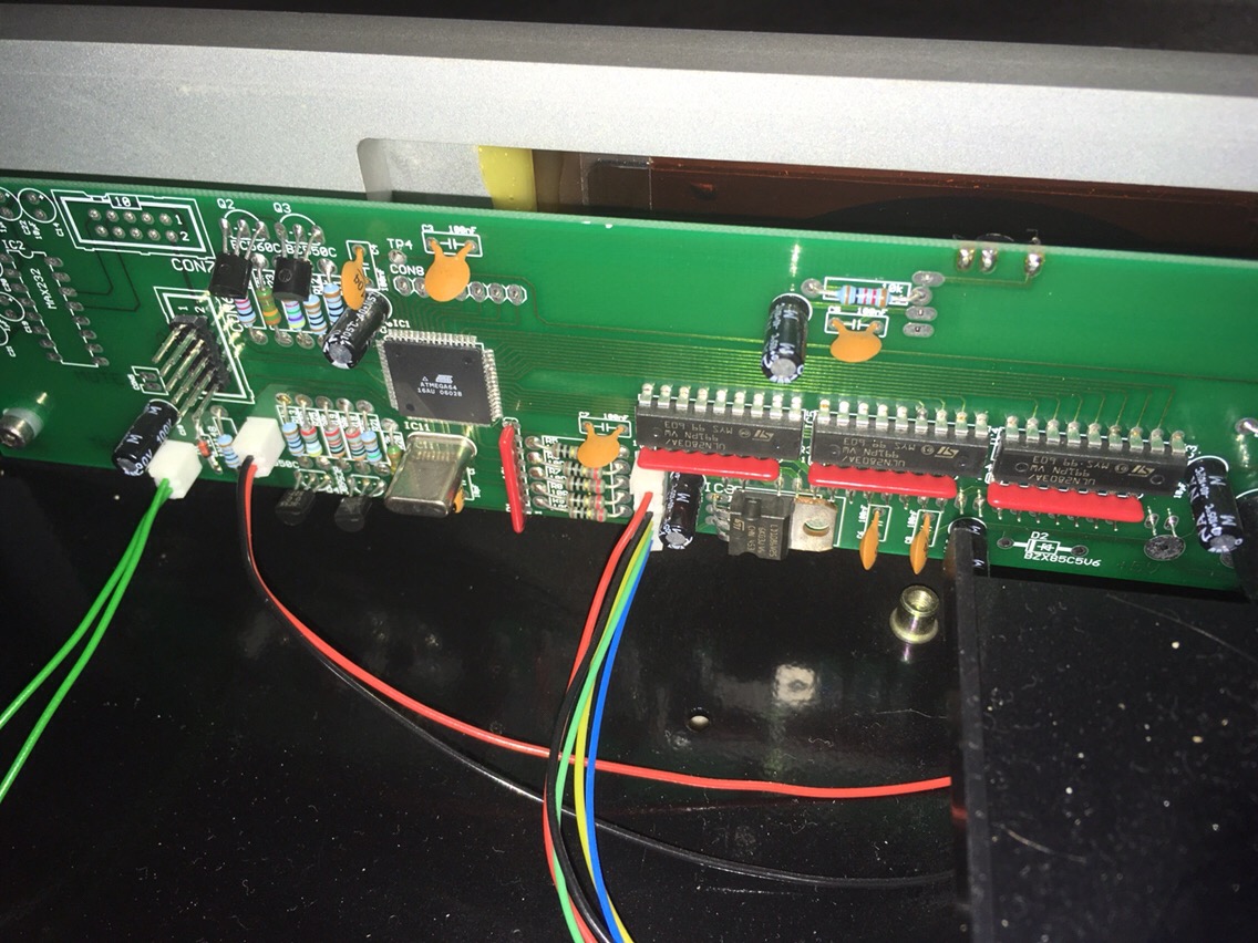

After several days listening to the CD, I am very happy with the results. I am surprised at the influence of these components on the final result of the sound. In this situation, I would like to receive suggestions from other components that could be replaced to improve the sound. As with the opamps, I have seen regulator upgrades. Any suggestions for improvement seeing the photos of the printed circuit? Can there be other candidate caps to be replaced?
If your happy with the sound you should leave it as is Toni.
Too much mucking around might turn the sound around.
An up graded clock for the cd drive should be a better move for now.

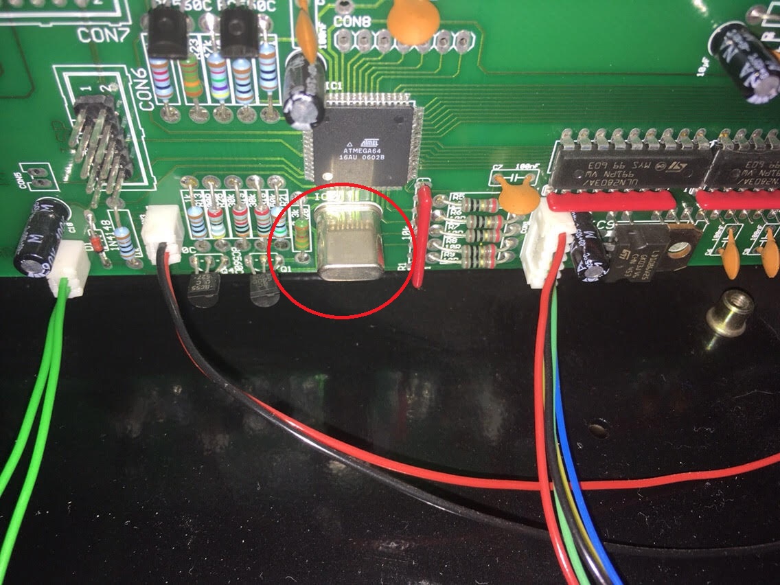

Thanks for your opinions. The idea of improving the CD clock is interesting. I attached some photos of the digital block and pointed to the clock on my CD with a circle. I don't have technical knowledge to make a clock change but I do have a reliable technician who can do it. Is it a complicated operation? In Parts Connexion I have seen that they have watch kits.(NewClassD Digital Clocks)
How can I know which one is right for my cd player? Any other alternative?

Hi Toni,
No need to spend crazy money coz it won't get crazily good.
That crystal should be 11. something mhz, it should be written on the xstal.
Go to Tentlabs.com to have a look or you can email Guido Tent to seek for his advice.
