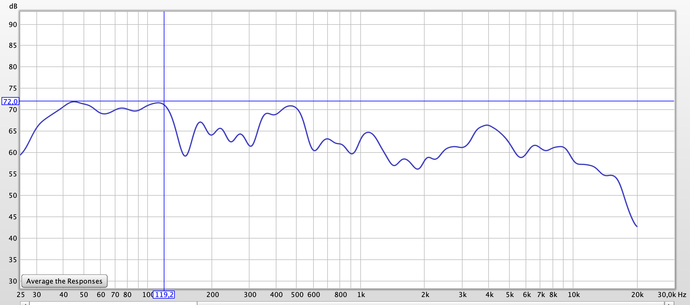

Took a measurement with REW of the Special 25. Mic placed at listening position.

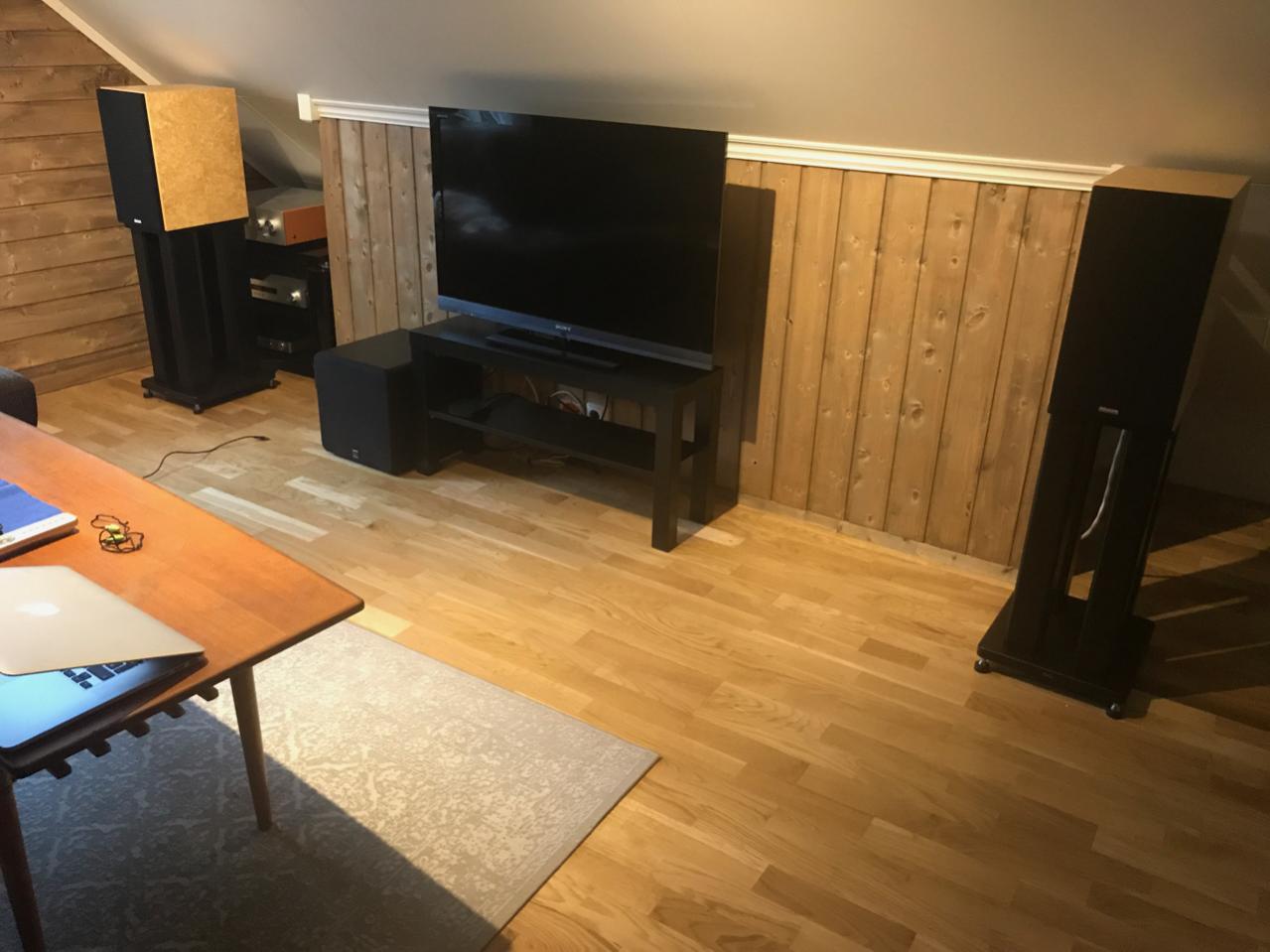

Used calibrated USB Umic-1. The listening room is quite small from front to back wall, but wide. Ca 3,5 meter from the front (knee-wall) to back wall. Room is ca 6,5 meters wide. There is some space behind the speakers, ca 70 cm further from knee-wall.
Listening position is 3 meters from the speaker. The subwoofer in the pic is turned off when measured.

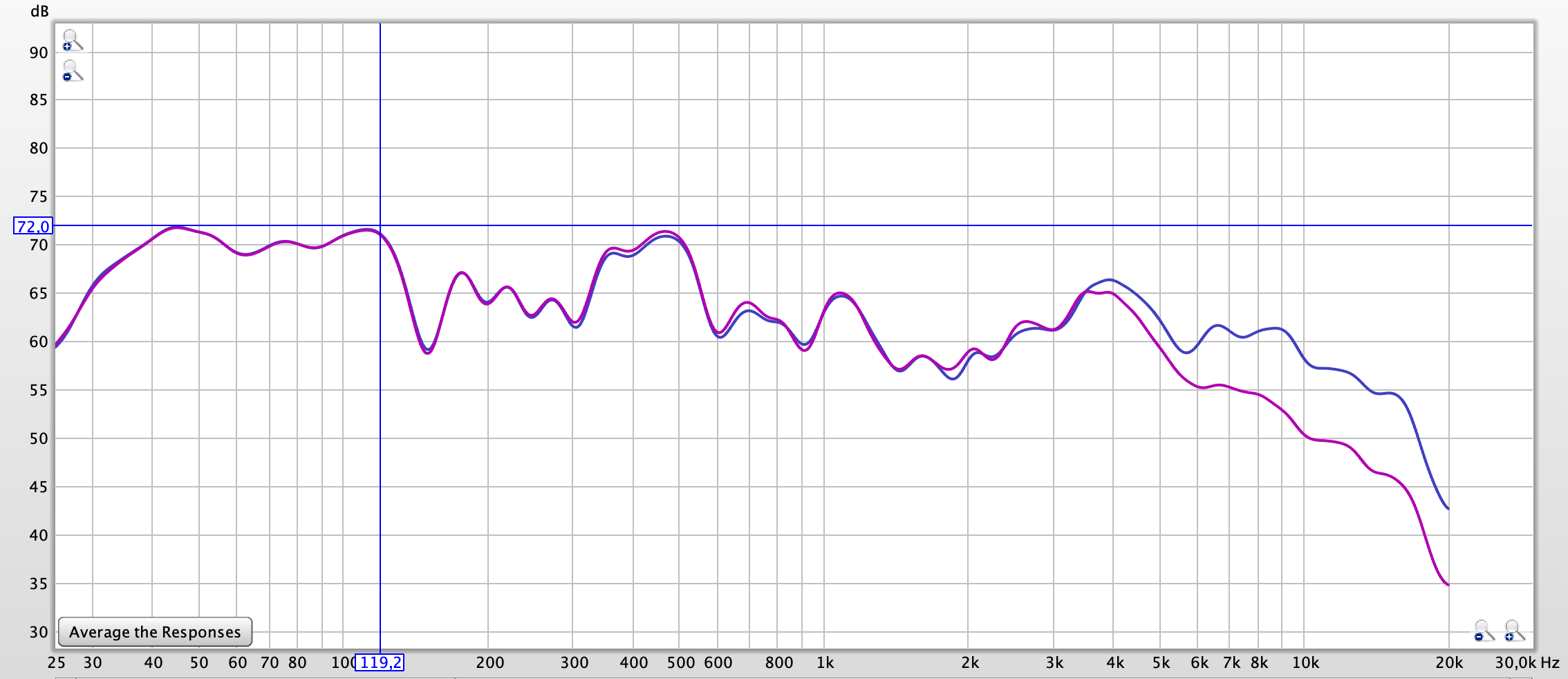

Also measured them with two layers of paper taped on the inside of the speaker-cover, covering the area of the tweeter. Shown in the graph as purple plotting. Blue is without speaker cover.
This is far field measurements, so of course room depentent. But there are some
rises in the response that is corresponding to the "harshness" when listening.
The wide rise from 330-550 Hz, and the peaks at 1 KHz and 3,3-3,5 KHz.

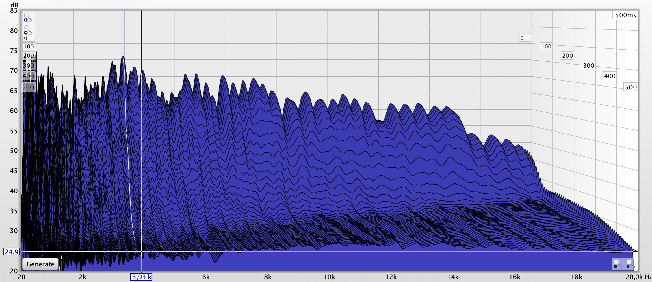

The waterfall plot is without speaker grill cover.

Hi, do you experience the tweeter balance as being too loud in respect to the rest of the band? If so, I am sure you will get it sorted only by modifying the original xo component values with different ones. I could help more if I had a schematic of it.
It is important to know if they really have those "peaks" or whether the lower ones are just the normal response inbeween dips caused by room placement. And the dip between 1 and 3 kHz could probably be caused by false tweeter polarity. I would play around with that before changing part values.

yes, from the upper midrange and upwards. I haven't found the schematics for the xo. All i know its a 1. order. and what's described by Tecknik1 in this thread.
From 6moons.com review: "The filter’s slope is 1st-order, i.e. a very shallow 6d/octave rolloff set at a very typical 2.400Hz for a 2-way." 6moons audio reviews: Dynaudio Special Twenty--Five
Regards
Charles
The room placement is far from perfect, but it what is possible. Cant put them too far from front wall, then they will be too close to listening position, and tweeter level even higher... I tried them in my other setup that is in a much bigger room. Had the same impression of the sound signature there too.
What do mean by false tweeter polarity?
