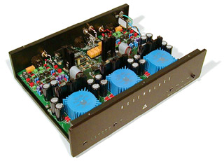

I am the happy owner of an Assemblage DAC 3.0 (the daugther company of Sonic Frontiers, that unfortunatly are now closed).
The DAC is based on 1704 DA's and originally with either a PMD-100 or 1704 filter chip - the last one giving you 24/96, but you loose HDCD.
Now my question is if there is another chip that is pin compatible with the PMD100 giving my 24/96 and HDCD as I dont really like the sound of the 1704 filter chips.
I, was by mistake, under the impression that I could just swap the PMD 100 for a 200 - but no, requires completely different circuit and is a 100+ pin chip.
Any help would be appriciated, as I really love my DAC..

Are there any 24/96 HDCD encoded DVD/DAD discs available?
To be honest - I dont know, but that is not the point.
I would like to have both HDCD and 24/96 - now I can only have one of them.
I was thinking more in terms of the possibility of replacing the filter chip DF1704 with DF1706 (24/192) and the dacs PCM1704 to PCM1796 (also 24/192) - but even if theese chips seems to be pin compatible, I dont know if it can be done.
Also, will I need to change the CS8414 input reciever - and if so, to what? Have not been able to see if a newer model giving 24/192 exist. The CS8414 is only 24/96 for sure..

Ahh but it is the point. If all you need the PMD100 for are the 44K1 discs, then you have more options. The PMD100 demoboard had two digital filters to allow easy comparison between the PMD100 and a standard filter. Using the same principle it is possible to run the PMD100 alongside filters like the NPC5842/3/7 series or the DF1704/6 series with the PMD100 decoding HDCD material and the standard filter dealing with everything else.
The datasheets will tell you what you need to know about the PCM1704 and the PCM 1794 and the main manufacturers of digital input receivers are AKM,Cirrus Logic and Texas Instruments.

You would need an input receiver that supports single-wire 192khz e.g. the CS8416. This would probably need some changes made to the PLL section.
Then you would need to decide how you want to set up the relationship between the two filters.
The above two modification could be done with minimal alterations to the DAC 3.0 pcbs and the addition of a daughter board or two. Any thing beyond that, e.g. replacing the PCM1704 with the very different PCM1794, and you might as well design a new DAC from the ground up.
