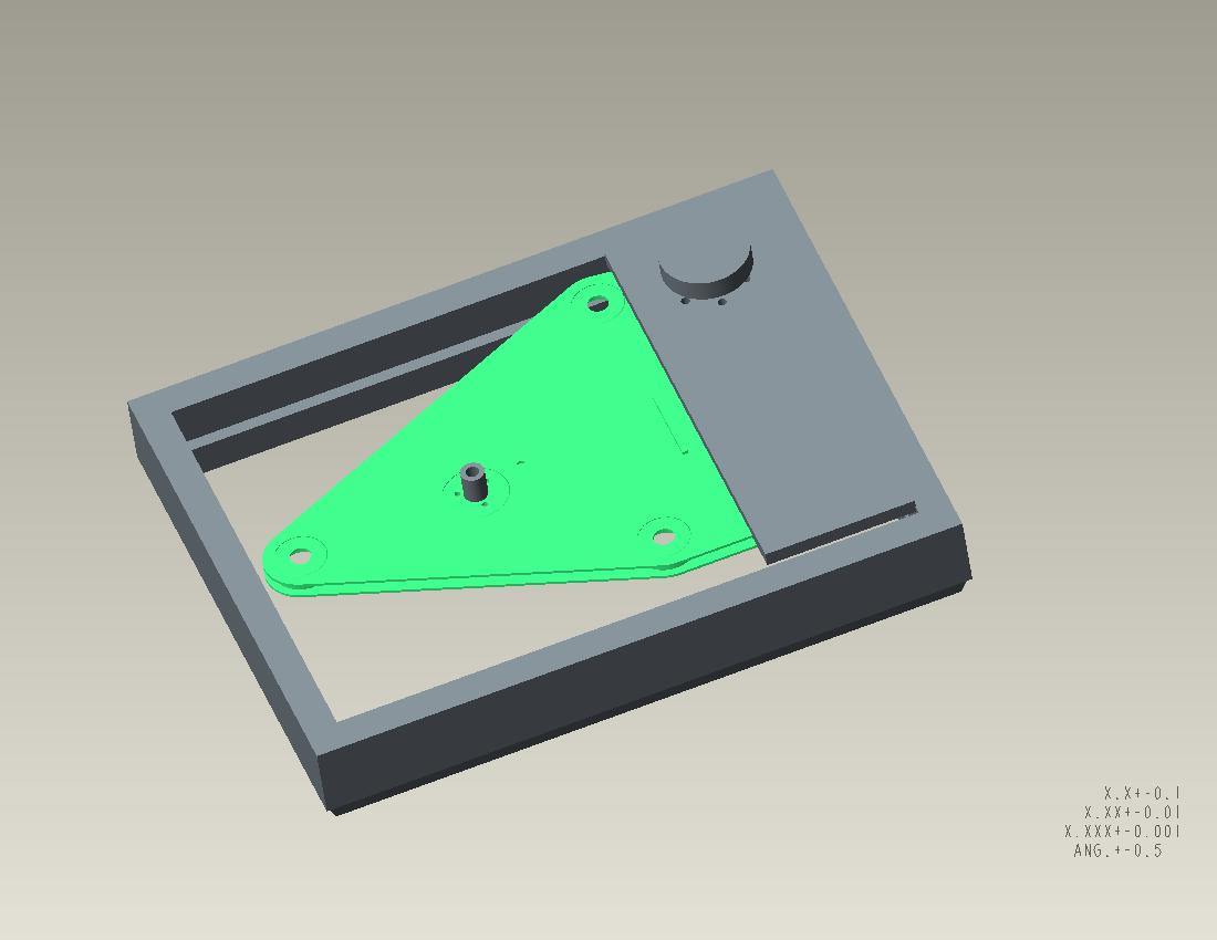

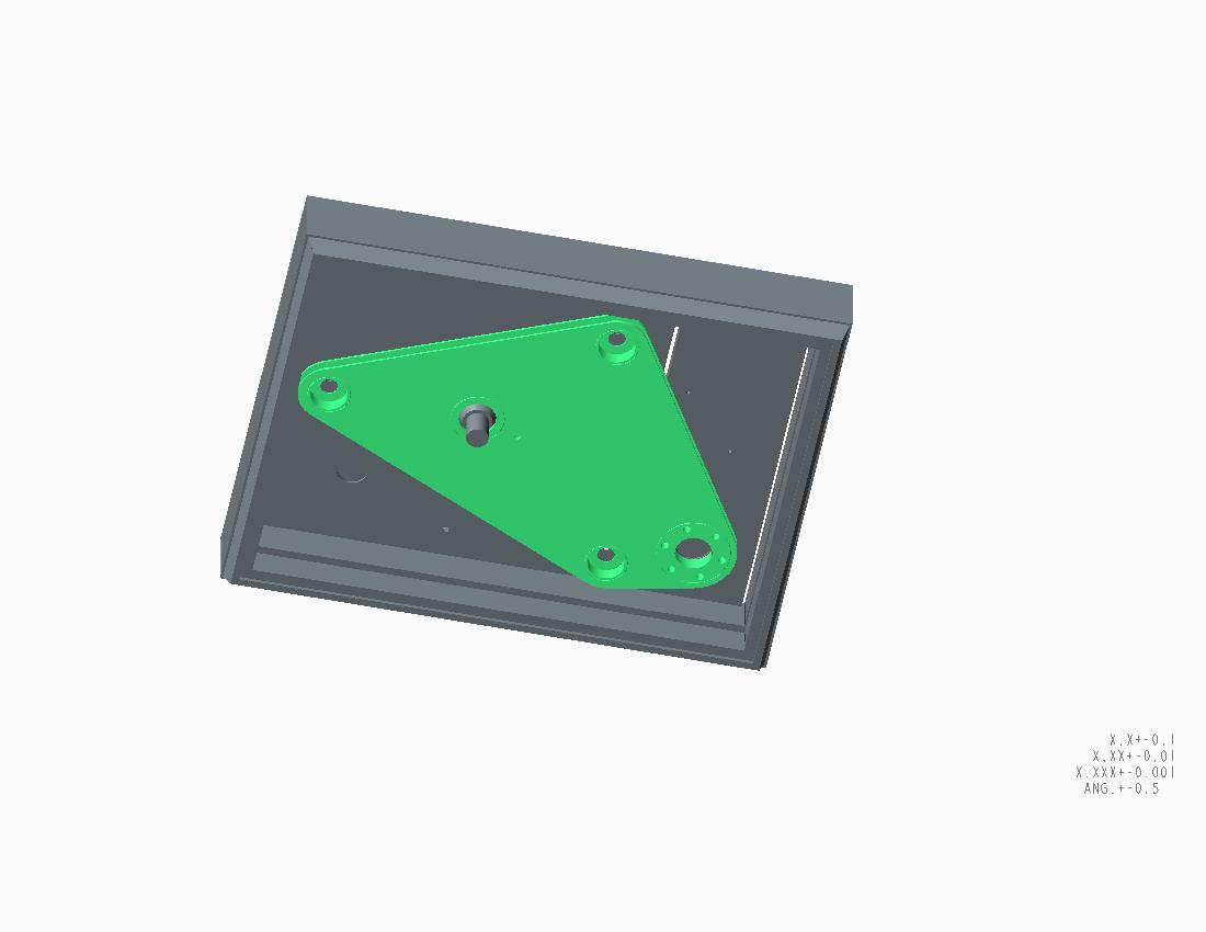

As for the subchassis the first one is not pretty but is functional.

Is the subchassis not much heavier than the original?
Mounting the tonearm directly sounds like a great idea, only i have come to the conclusion that a softer decoupling tonearm board is essential to the Linn sound and generally helpful in other tts too. Rigidity isn't always everything.
Its a similar weight. The pressed steel subchassis weighs 800 grammes. I'm working on a new design now, which will be around 1kg. Think that will be ok.
