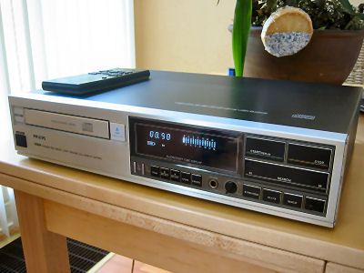

Does anyone have a MKII spare? If it is defect than it's fine. Yesterday I bought a second CD304 again in silver with remote ( original one )
What can I use from my CD4xx donor. it's a 16bits player with a CDMII mechanism. but does also has no digital out.

retro-audio73 said:Well It doesn't give the right SPdif to tricker my ext.DAC
Of course it doesn't, it isn't biphase mark encoded but then I'd already told you that. Just get a player with SPDIF built in, it is so much easier.
zanash said:I thought you realised you need to then convert to spdff or what ever....sorry my fault
Wouldn't have made much difference. The output on pin37 is not in a form suitable for conversion to SPDIF.
The Sound from pin 37 is like a data modem, Sound loud and does not do anything to my ext DAC. But all the commands that I give does set-off a different patern in noice. To bad that it cannot be used as a SPdif. or at least a signal that my ext Dac might like.
Wel for now I have no other option than to trust the information given and keep playing with my CD304 till someone proof otherwise. Or I will find a MKII DAC.

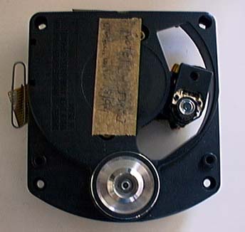

I just modified the laser from an CDM4 back to a CDM-II. After some adjustments it seems to work fine.
The point was that I would like a different laser in my CD850 and not that crappy plastic one ( original in CDM-4 )
Both players seem to work fine and this might be proof off compatibility!!
But it took me a periode of time to change all the different parts of mounting al the frame works.
