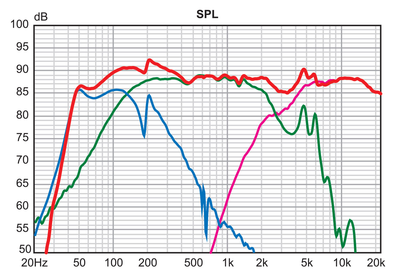

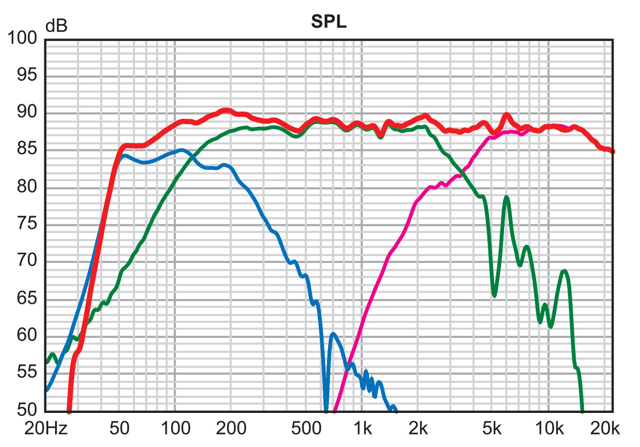

Measuring (and modifying) several models of well-known hi-fi loudspeakers, I found that almost always the main problem was the crossover. Modifying the crossover will always make bigger improvement than any messing with the enclosure. Only the cheapest loudspeakers have meagre enclosures, where additional bracing will indeed bring improvement.
Here is one example what can be done for improving the vintage Mission 753 Freedom.
This is the measured frequency response of the original (with separate freq. responses of the drivers, shaped by their filters):
And this is with modified crossover (midrange low-pass filter only) which, surprisingly, is cheaper than the original one!
Resonance at 200 Hz was eradicated with a simple lump of foam placed in the canal behind the midrange enclosure.

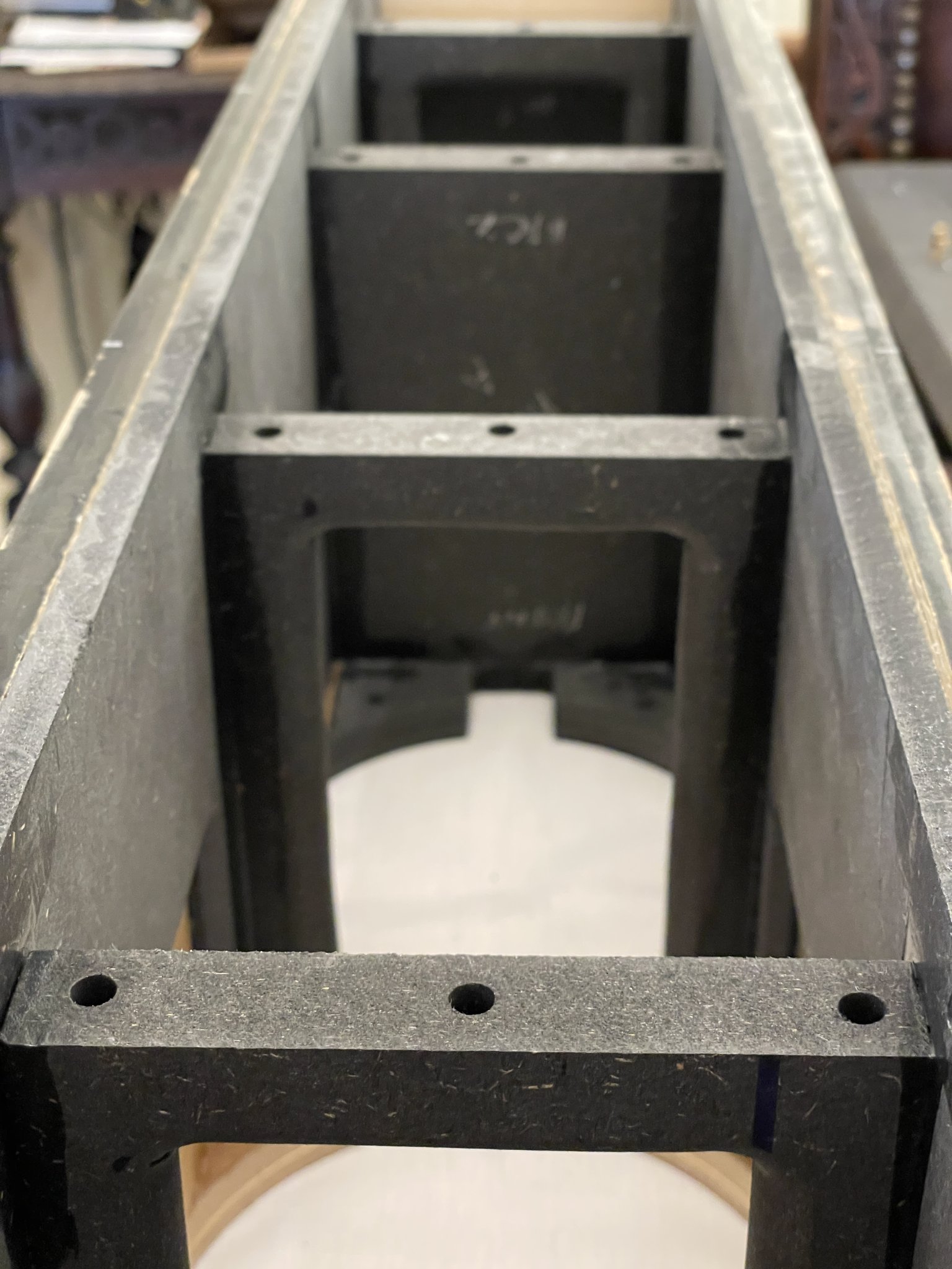

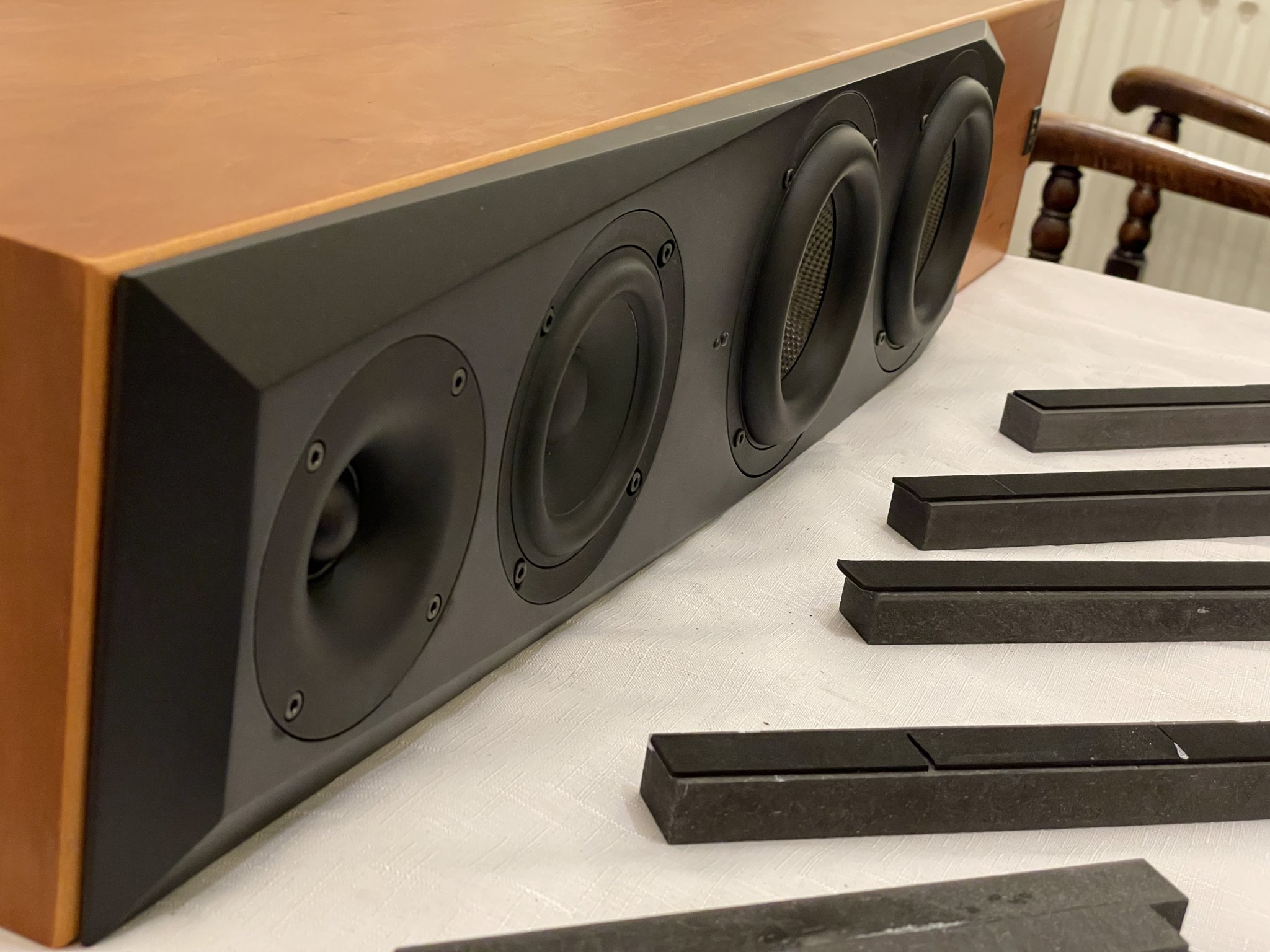

Have a look at my recent conversion. I started with exactly the same objective: use existing cabinets to avoid/minimise woodwork. And I also ignored advice. Lesson learned: it was actually more woodwork. less (simpler, easier, quicker) woodwork if building from scratch.No money in selling Mission 761s I'm afraid...

Still, enjoyed immensely and learned a lot.
Thread '3-way to active - Hypex FA253 - learning project'
https://www.diyaudio.com/community/threads/3-way-to-active-hypex-fa253-learning-project.421061/
