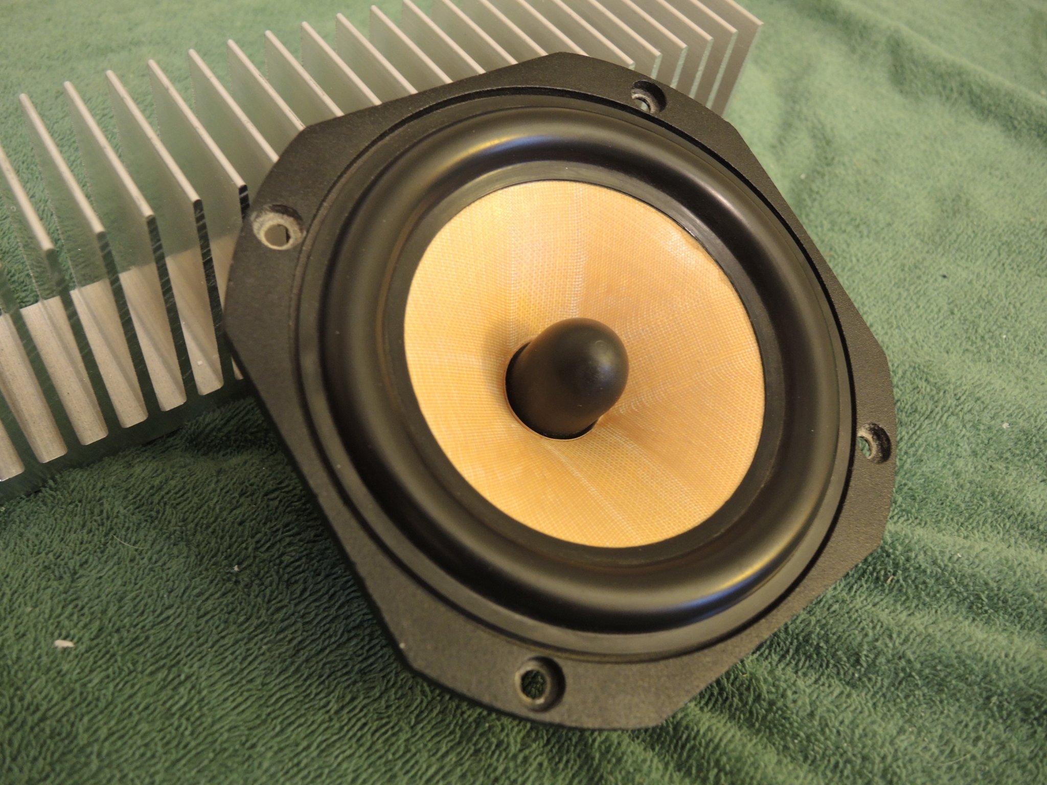

I'm working on new speakers and building a Amplabs lateral amp for a second system. My old Focal 7N driver will finally get to be used and I have high hopes for the Lateral FET amp.
