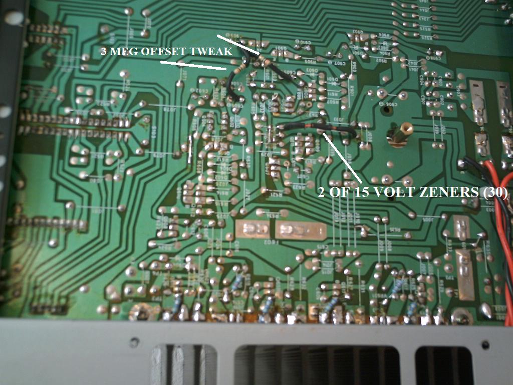

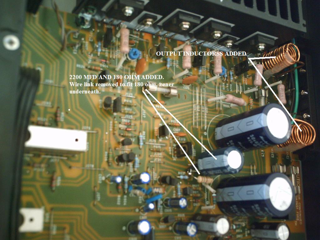

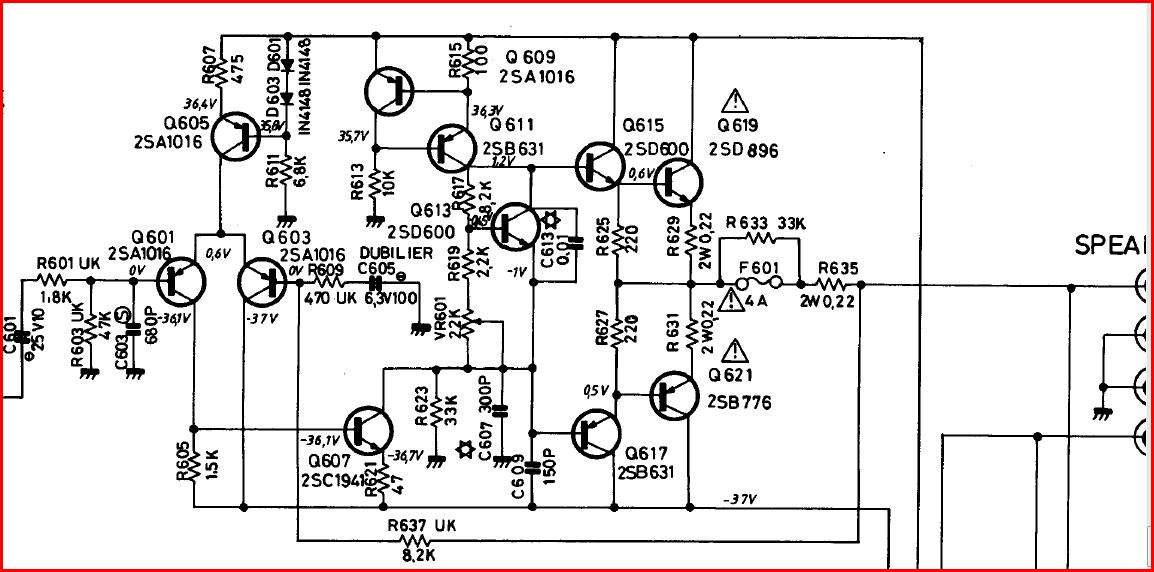

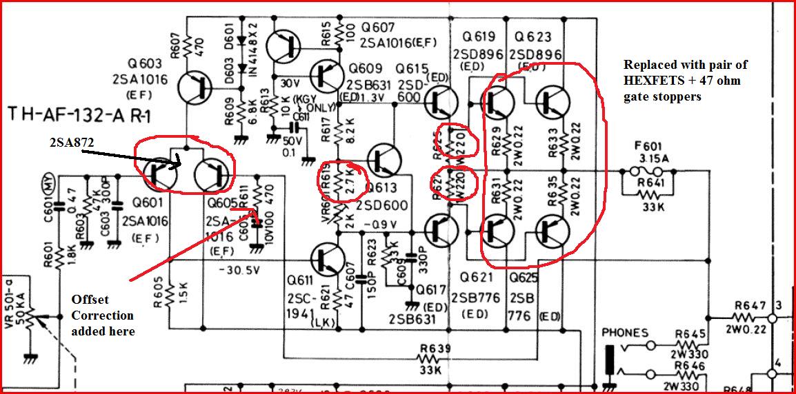

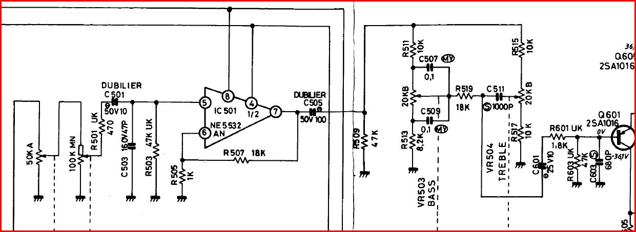

Updating an old Rotel RA820A to use HEXFETS's amongst other mods :)
Hi ilimzn... thanks for the interest and observations. I realise such a basic design as this is capable of many tweaks and alterations, and your suggestions re the input stage are very valid.
It was all just done as a bit of fun rather than trying to turn it into an "audiophile amp".
thanks 🙂
Oh, I know, but it's even more fun if it ends up working really well while keeping it simple... and some of these simple amps actually show how far you can get with the KISS philosophy.

To say that 80 mv offset is appaling.is a joke Rotel must have made thousands of them
jim the notifier.
It's an old budget design, and by todays standards (and my standards) 80 mv is not acceptable.
I haven't designed any amps commercially, only for my own satisfaction.
This one holds the offset to around 0.3mv,
