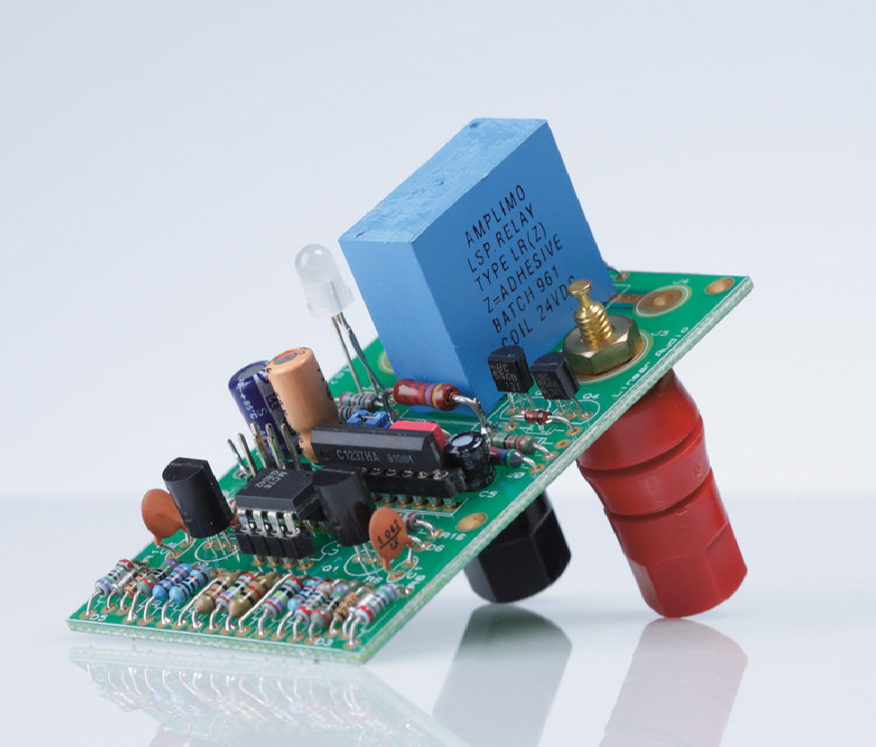

I've built one on a perf board, with external relay. Nice and compact. Seems to work fine at 65V. I was thinking of doing a PCB but if yours is based on the 1237/7100 maybe I could 'lift it' from you.
This is my 1237-based offset protection, switch-on delay as well as amplifier Safe Operation Area protection. This is the unit published by Elektor Electronics in their May issue.
Details at my website.
BTW, I can get 1237's here in Holland for about $1.50 + VAT at 19% if you need help.
Jan Didden

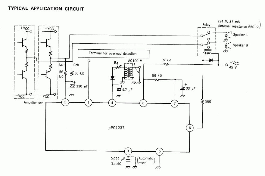

Hola a todos; Por favor si alguien tiene el diagrama interno y un circuito de aplicacion con el upc1237H .
Estoy reparando un Amplificador sansui A-1001 si alguien tiene el circuito seria grandioso.
Desde ya mucchas gracias.
joaquin horacio
Hello everyone, Please if anyone has the internal diagram and application circuit with upc1237H.
I'm repairing a sansui amplifier A-1001 if anyone has the circuit would be great.
From mucchas and thanks.
joaquin horacio
