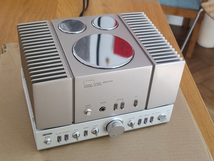

Toshiba aurex sc-m15.
Its working but on low volume one channel cuts out until you turn it a but up and then again works, cuts again on low volume.
Haven't gotten to take a look in it but looked in the service manual searched for the j fets for curiosity.

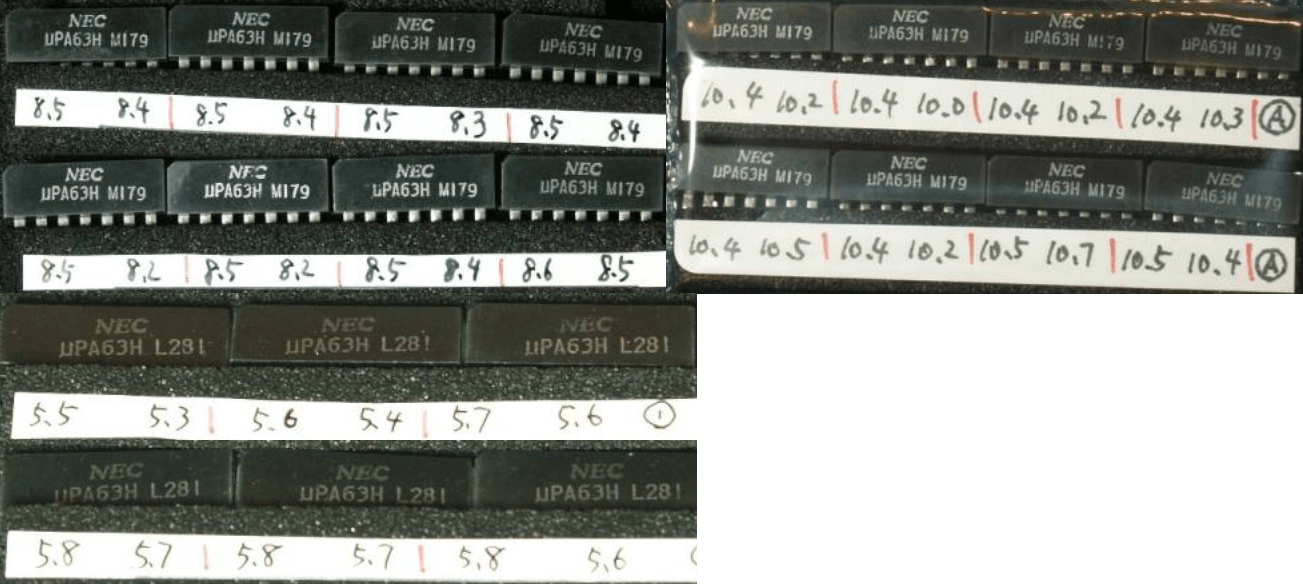

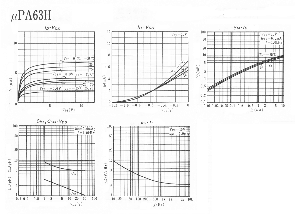

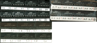

And to finish the specs discussion for these dual FET I will add grades values,
measured in Japan (and which are missing in the d/s):
K1=1.5mA...3mA, K2=2.5m...4m
L1=3.5m...6m, L2=5.5m...8m,
M1=7.5m...11m, M2=10.5m...14m
N=13.5m...20m
Manufacturers usually overlap grades to play it safe.
For illustration - sample measurements for L2 and M1 (sub)grades:
