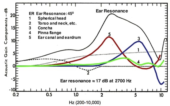

I’ve had this issue for years, discovered it when I started building Full Range speakers. Some years ago I mapped out my hearing by listening to a tone generator and I can point to 3 specific frequencies bands that ’hit a nerve’. Some of these are in the frequency range being discussed here. If I remember, the most irritating centred on 5kHz (e.g. female voice sibilance, but note also there’s an ear concha resonance here too), another at around 9kHz, a lesser one around 2kHz (ear canal resonances are common at this frequency).
I think it’s called Hyperacusis and I believe in my case it’s possibly some damage from listening to my old PMC FB1’s waaaaay too loud with tweeters screaming away….

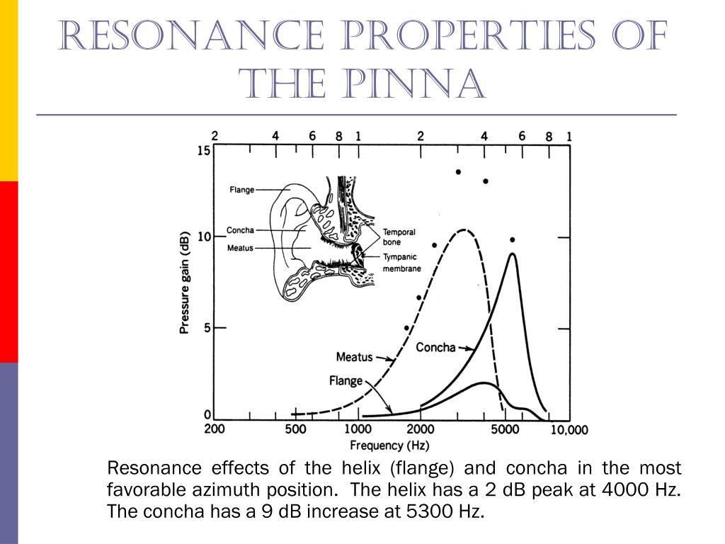

I've had a peculiarity with my hearing since I was a child: I could hear that the television set was on (old tube televisions). Even if the sound in it was at zero, I still knew who in the other room had the TV on.
I am sensitive to the sound in my phone chargers and I could hear a special sound in the power supply of my laptop.
I read once that some people have "Darwin 's hillock" in their ear. It's a rudiment, it doesn't carry anything. It's left over from ancient times. Some people can hear more sound because of it. Check your ear, do you have one of these? I only have it on one, but I have two Darwin's hillock at once.
