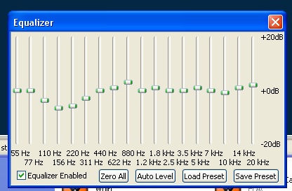

I've been testing out one cab with the driver installed. I have it up against the wall as it's designed to be used. I had intended to use bass boost on these but it turns out that's completely unnecessary!
That said, I get an excess of lower mid region, or so it seems. I'm guessing in reality that because they don't extend that deep it gives this impression. Using the Foobar EQ I can get it sounding fine by dropping the 150-300Hz region by a few dB. With this in effect they (currently 'it') does sound very respectable. Unfortunately this won't apply on Youtube videos or anything else, but this isn't really an issue. It's also possible that by moving the speakers slightly away from the wall I'll get less gain of this region whilst keeping the gain of the bass end but that cause cause other frequency anomalies.

Can anyone shed any light on the excess 120-300Hz energy? If I can identify the cause I may be able to find an elegant solution. At the moment it's looking like using PC based DSP EQ or trying to squeeze an active notch filter into my compact amplifier.
For interest, I attach the EQ settings I came up with for Foobar, before taking the measurement. With this on it sounds rather good but this doesn't apply to DVDs etc.
EDIT *this actually shows on the driver response curve, I hadn't realised how significant it was.
