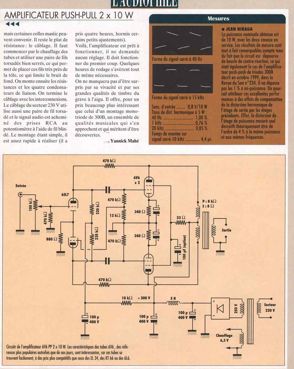

Apart from not saying much of importance I'm posting a paraphase circuit found in an audiophile mag. This one comes with some numbers.

The paraphase Cassiel posted is surprising with the 470K Schade feebacks going back to the para triode plates. Rather low impedance loading on those triodes, but maybe a good way to get 2nd harmonic out of the PI if that's the goal.
Would someone,
Translate the caption at the bottom of Cassiel's drawing? Thank's 🙂
Manually typing it into google translator, which you could have done.
"Amplifier circuit 2 x 10w pp. 6v6. The characteristics of 6v6 tubes, references
more popular than our outrefois Joure, are interesting because these tubes
easily found, at prices more competitive than those of EL34, KT66 or 6L6"
edit: "outrefois" may really be autrefois which is "once Joure" (French is not my language)
autrefois means "in former times"/"in the past"
The text simply says that 6V6 tubes are more easily to find and much cheaper than EL34,KT66 or 6L6 because they were very popular in the old days.
Today this of course doesn't make sense ! This article is from a former french magazine. A long time ago. There weren't any new production tubes on the market so everybody had to use NOS stock.

a 100k pot is bad audio alchemy. Let me put it this way, its dumb to attenuate the amp that is what the preamp is for.
And I don't know why 100k seems to be the first choice for diyers there only 4 instances where 100k really works like it should. this isnt one of them.
remove 100k pot, install 500K pot and a/b removing the 470K resistor in the input grid circuit.
