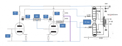

I'm wondering what the sonic advantages are for putting the floating P.I. up first stage versus 2nd stage. I see it both ways in Cassiel's schematics.
All have much lower plate load resistors on the floating P.I. stage. Better drive and bandwidth. Distortion compromised though? I wonder if any recent designs have used gyrator/CCS loads.
I think you have already answered the question..With Pi up front you can have a separate driver so the distortion should be better?

I can see where the driver stage after the P.I. would allow driving heavier loads (bigger tubes) with low Zout. Not sure of the relative merits on distortion for smaller, easier to drive outputs, say EL84. Maybe Steve or Cassiel have some opinions? Maybe better to have the P.I. on second base if you want high gain up front for noise reasons.

If you can get away with one tube why use two - that's my opinion. I never use a lot of negative feedback anyway. And triode wired EL84's sound great with no feedback loop. With bigger output tubes you need two stages.

Looking at the info from Cassiel,
It would seem that we don't need the pot for balance. I guess lower value resistors would give a closer tolerance. This is probably irrelevant with modern parts..?
So 100K anode and 1K cathode? No feedback..

Cathode resistor depends on what current you want the tube to run at. Its the auto bias. Plate resistor depends on B+ available and what load C its gotta drive (slew rate, bandwidth), and also determines linearity of the tube via loading effect.
"It would seem that we don't need the pot for balance."
All depends on how well you want it balanced. For Mu 20 tubes, 5% imbalance without it (unless you build it in with dissimilar divider resistors). How well matched the output tubes are also determines its usefulness. You can use the balance pot to bring mis-matched output tubes back into balance.

Just off the cuff ball park figures..I notice in the info they are bypassing the first stage cathode with a cap..(Gain)
Also they have the cathodes coupled..😕
