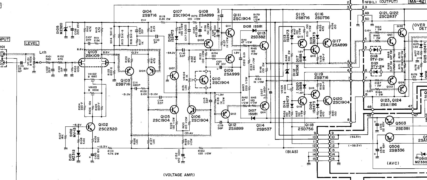

>The crazy amp is supposed to be based on this circuit
I checked it out when analyzing this amp, but I failed to find too many similarities..
This is Mitsubishi da-a30
