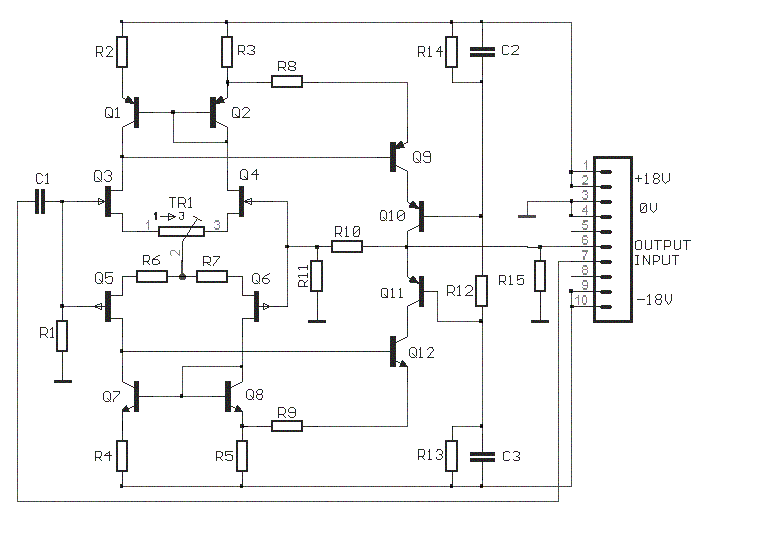

wireless world 1985...
smoking-amp said:Hi Mikek, how does the Linsley Hood design work? I looked thru a bunch of amp schematics by Hood, but don't see anything applicable, must be in a Wireless World article.
Mike,
I saw that circuit years ago and I thought it represented some pretty original thinking at the time. I wonder if removing the curret mirrors would hurt the performance much. Have you built it by any chance?

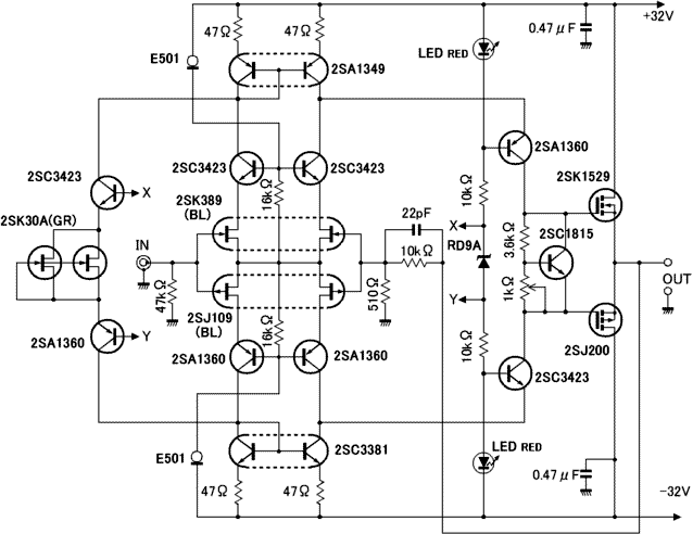

Heavily modified with 2-pole, 2-zero compensation....still THD not impressive...but very easy to stabilise...🙂
jam said:...or try this for size!
AAhh...from that japanese site....tried this...but found currents grossly unbalanced in diff. stages....hood's much better...and simpler...
Note that Hood's design does not balance currents in the diff. stage as effectively as the generic Self design...but it's an improvement on many so-called dual complementary diff. stage designs...

Linsley Hood design
Ah, interesting! Thankyou Mikek. R8 and R9 provide the VAS bias feedback in a convenient manner. TR1 allows adjusting out the offset difference in diff amps. (Q11 typo I think, NPN type) Should be able to tweak this into a more conventional shape to get low distortion. R8 and R9 only need to feedback DC info, so can put caps from Q9,Q12 ends of R8,R9 to respective rails. Now can put another 100 Ohm resistor in each emitter circuit (Q9,Q12) to act as conventional degeneration. Q9,Q12 can be upgraded to fancier configurations, maybe Baxandall super pair or Hawksford cascoded VAS designs. Lots of possibilities.
RE: try this for size
Hi Jam, this schematic is interesting too. The VAS bias current is fed back through an interesting network here. Sort of like using an opto-isolator to sample the VAS current except with no opto! I think I would put a capacitor across the X and Y points to slow down the bias feedback, no need for speed in the bias feedback in either this design or the Linsley Hood design. This design needs some trimpot(s) in the input diff amps. sources to null out the offsets. In either design, I would replace the FETs with some precision matched bipolars like Analog Devices MAT series. FETs are too mismatched. (Would need to add tail current sources and degeneration resistors with these bipolar inputs to get DC input levels to work out.) Also the current gain in this design is awfully low due to the common base VAS stages.
The type of VAS bias feedback network used here could be put to use to make a design that is automatic in nulling the diff. amp offsets by connecting the common mode correction current to one side of the input diff. amp degeneration resistors (ie. at the emitters of the global feedback connected diff. transistors, degen. resistors need to be added) instead of to the current mirrors. This would correct the offsets AND control the VAS bias automatically. Could use an opto isolator instead also. Needs some reworking to get DC operating levels to work out.
