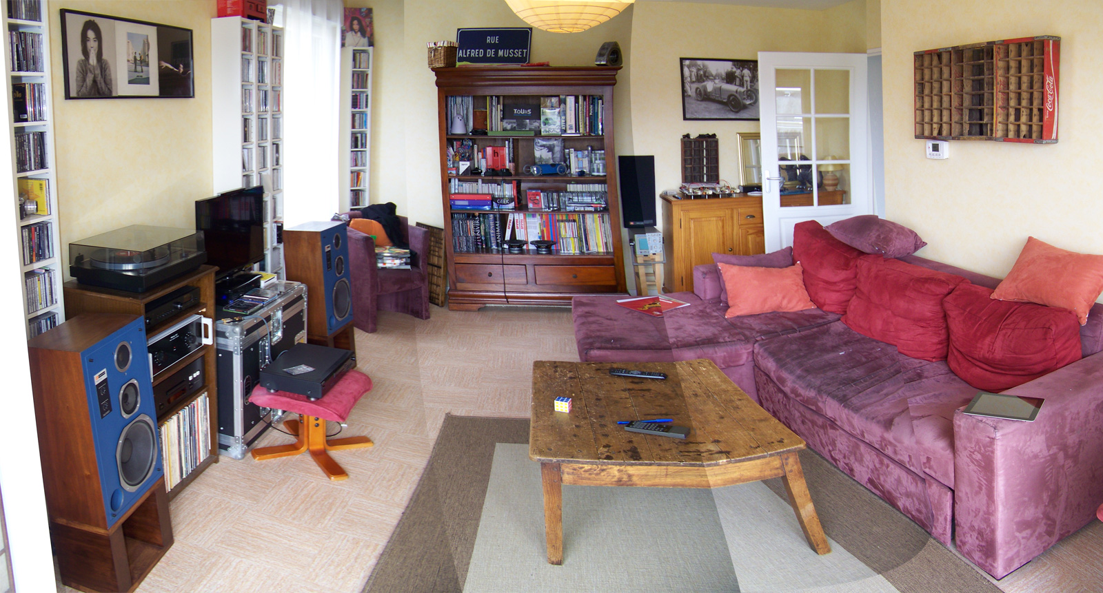

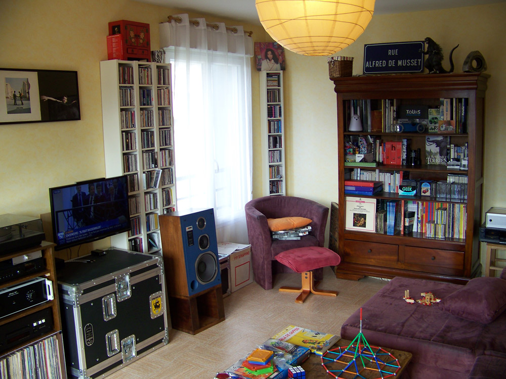

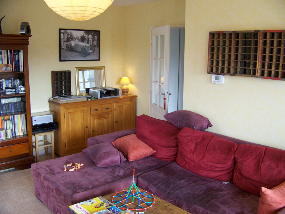

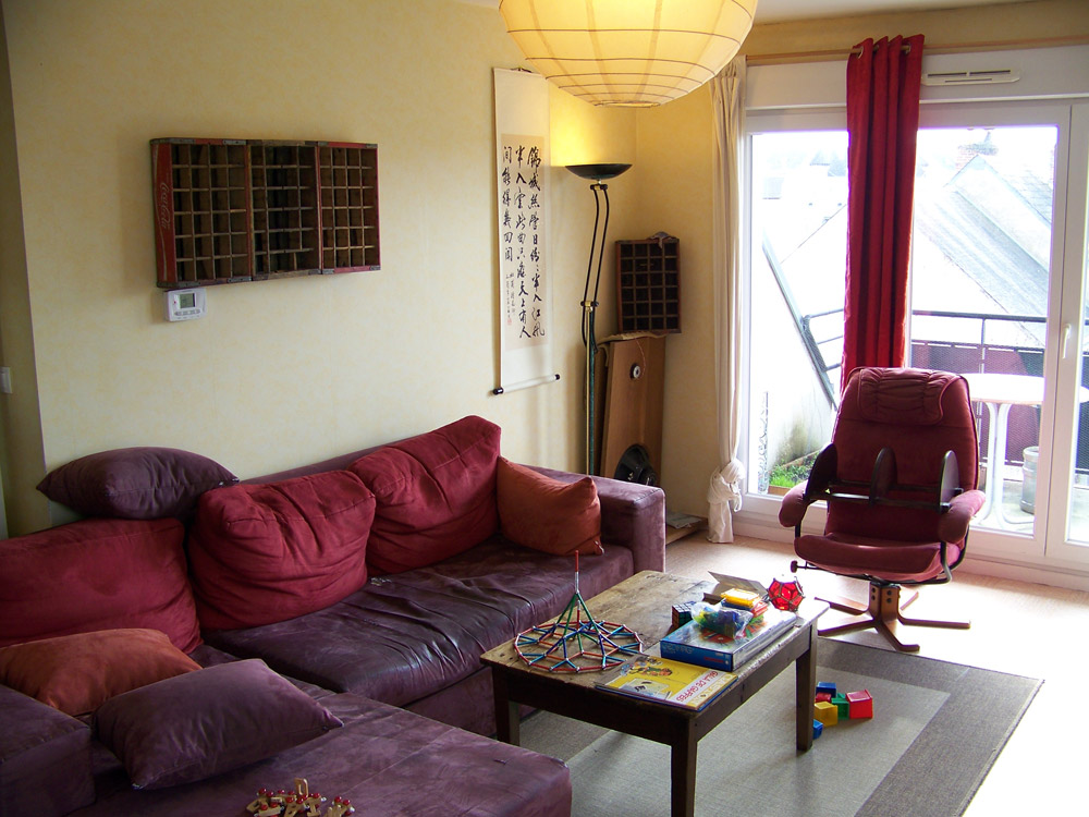

First things requested first, pictures. Each corner and a kind of wide angle photoshop wich was taken from the wall which is almost in full the bay window. And this is all but symmetrical...
List is easy, Tuner/Transport&Dac/Turntable, then a pair of UcD400 and finally speakers being JBL 4313B...
Close 1m and more off the wall test and reversed phase on one speaker are next.

I guess it is that Bjork Cover on the wall. She can be quite detrimental to listening pleasure ! 😉
Fun aside: That might not be the perfect setup but it should definitely give at least some imaging. For that listening distance the speakers are a little closely spaced IMO. You don't have a equally sided triangle if I estimate the distances properly. You might have a hole somewhere in the upper bass however due to floor bounce. And did you ever try any toe-in ?

You have a big reflective surface (glass) one side, and a diffuser (bookcase) the other side. Could affect the off axis performance. I'd try removing the hifi rack and chest from between the speakers and toeing them in to cross a foot or so in front of the couch. Also the table in front of the couch probably doesn't help.
Rob.
