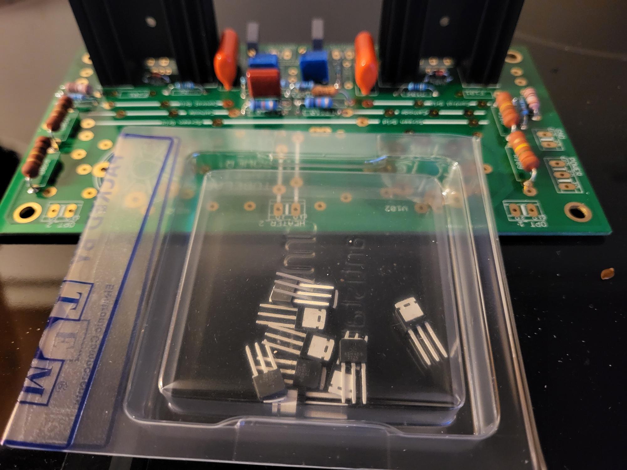

Making some headway on stuffing the UPH boards. I was going to ask about the fuses, but I saw in the build notes these are 2A Pico fuses.
After a lot of cogitation and prevarication I ended up buying the ones pictured from TME.EU: DMP45H4D9HJ3. They seemed to fit the bill, got the thumbs up on the SCG thread, where MOSFETs get discussed, but I ended buying the wrong packaging. I continue to learn; last project I had surface mounted by accident. It does not help that the picture is often generic, so the small print must be checked, and the part number compared with the packaging variants.
Is there a clip that will clamp them to the heat sink? Or should I bite the sour apple?
