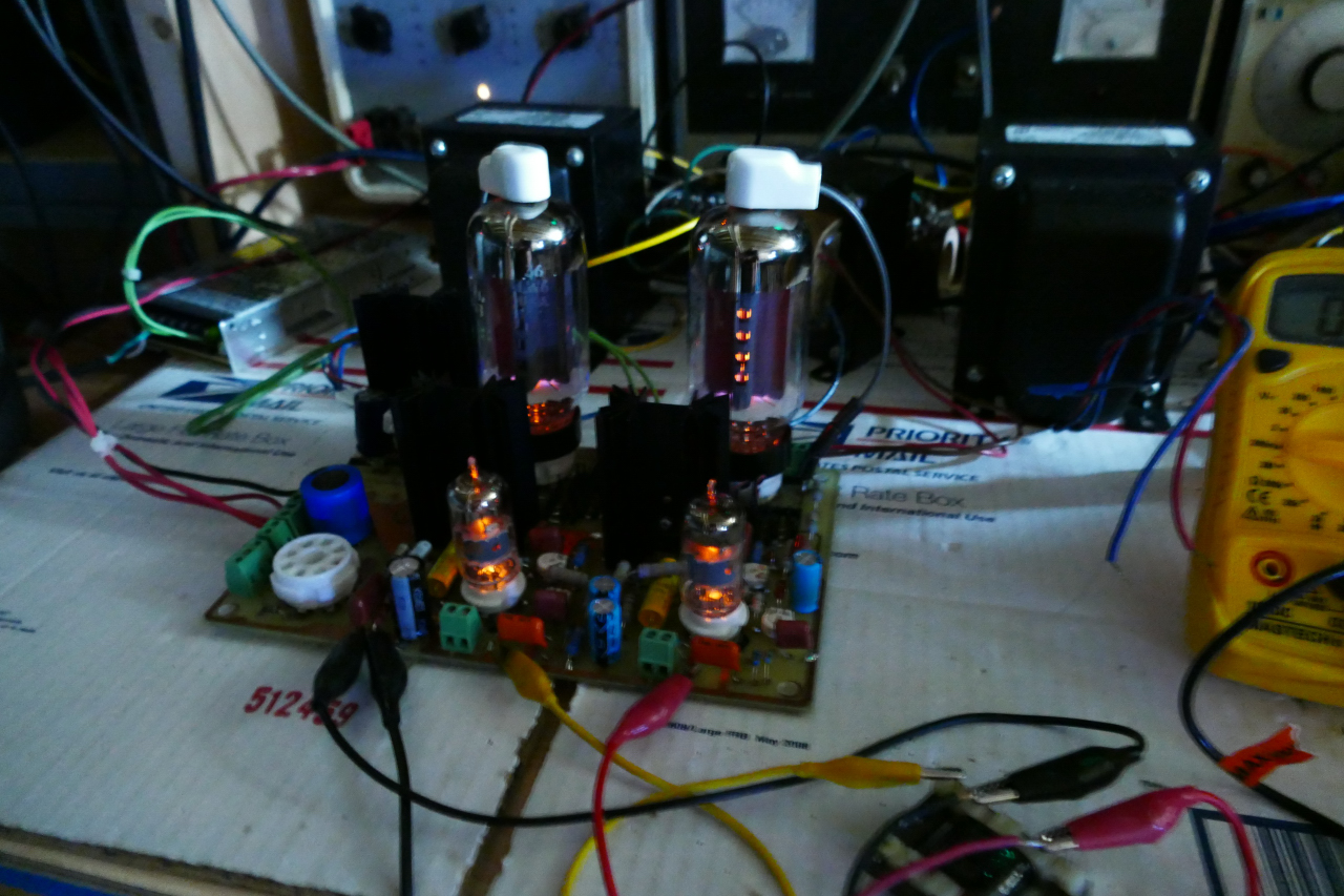

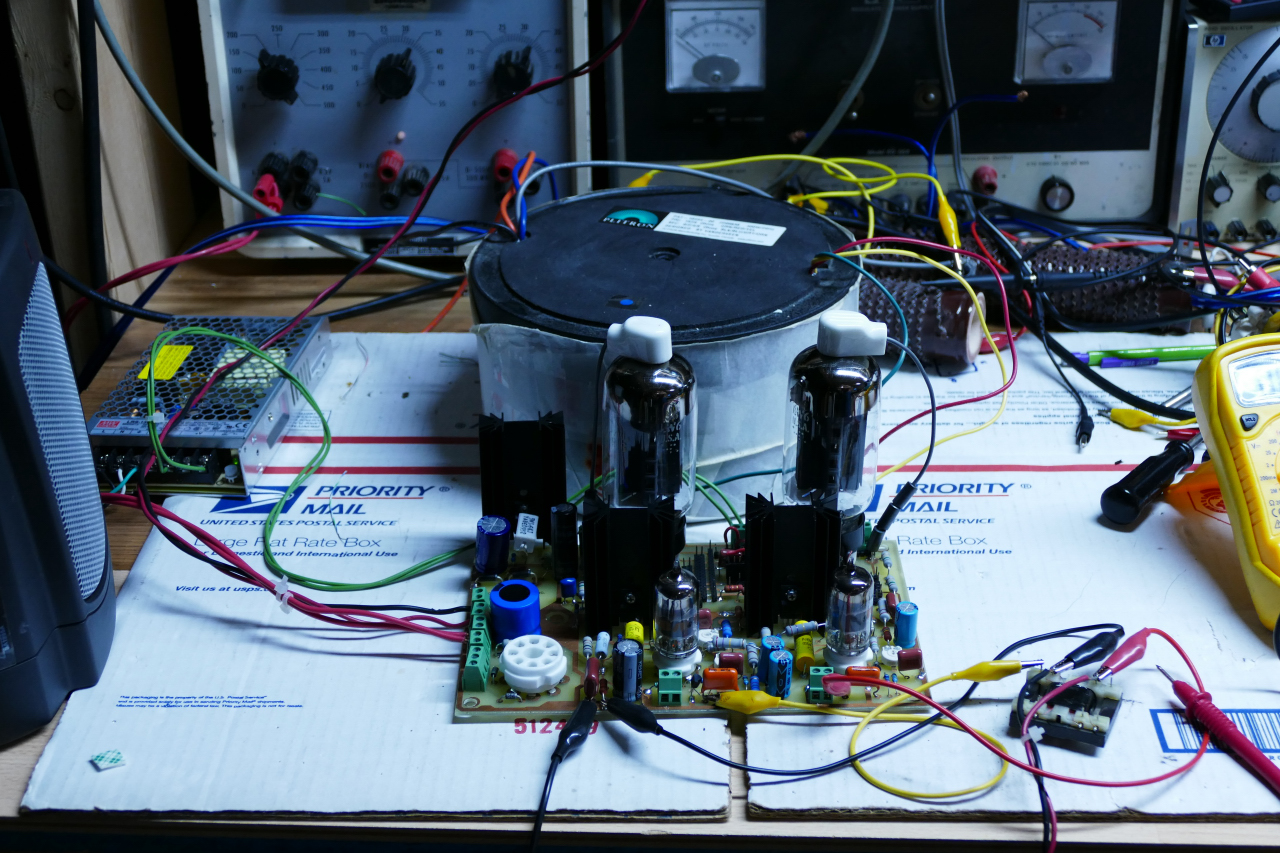

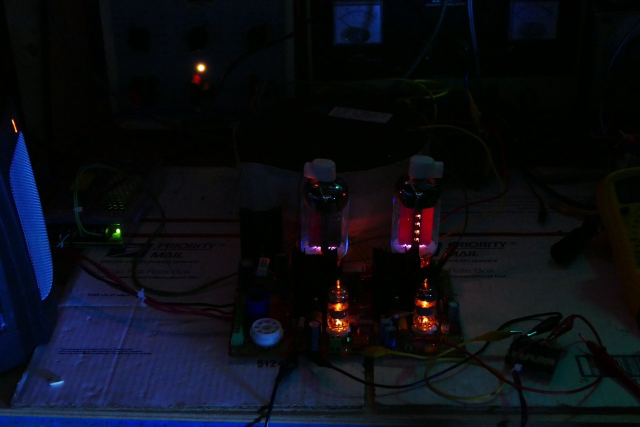

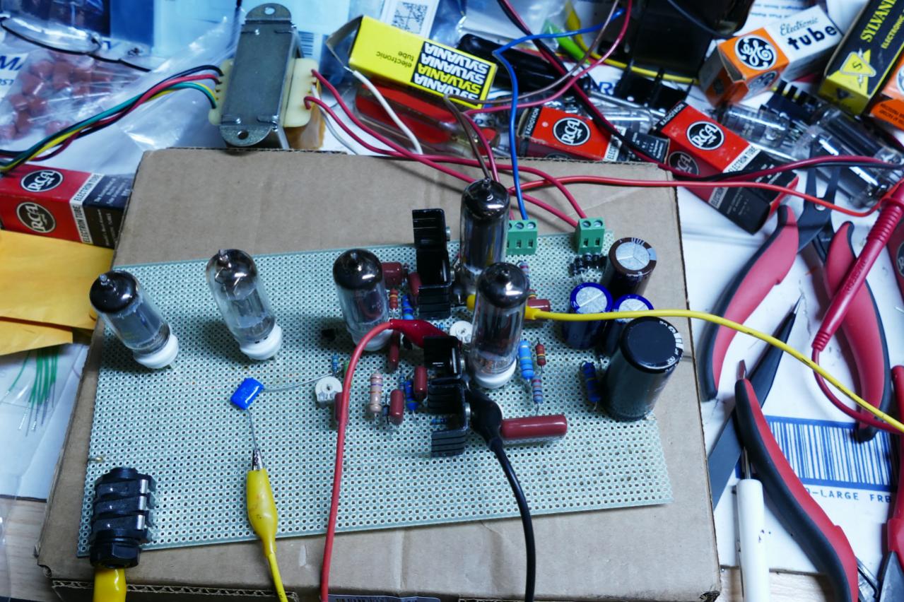

... a mosfet split load PI .... 20 watts from a pair of lowly 50C5 radio tubes ... revised jumper scheme for the output tubes. Anything that comes in an octal socket can be connected up ...

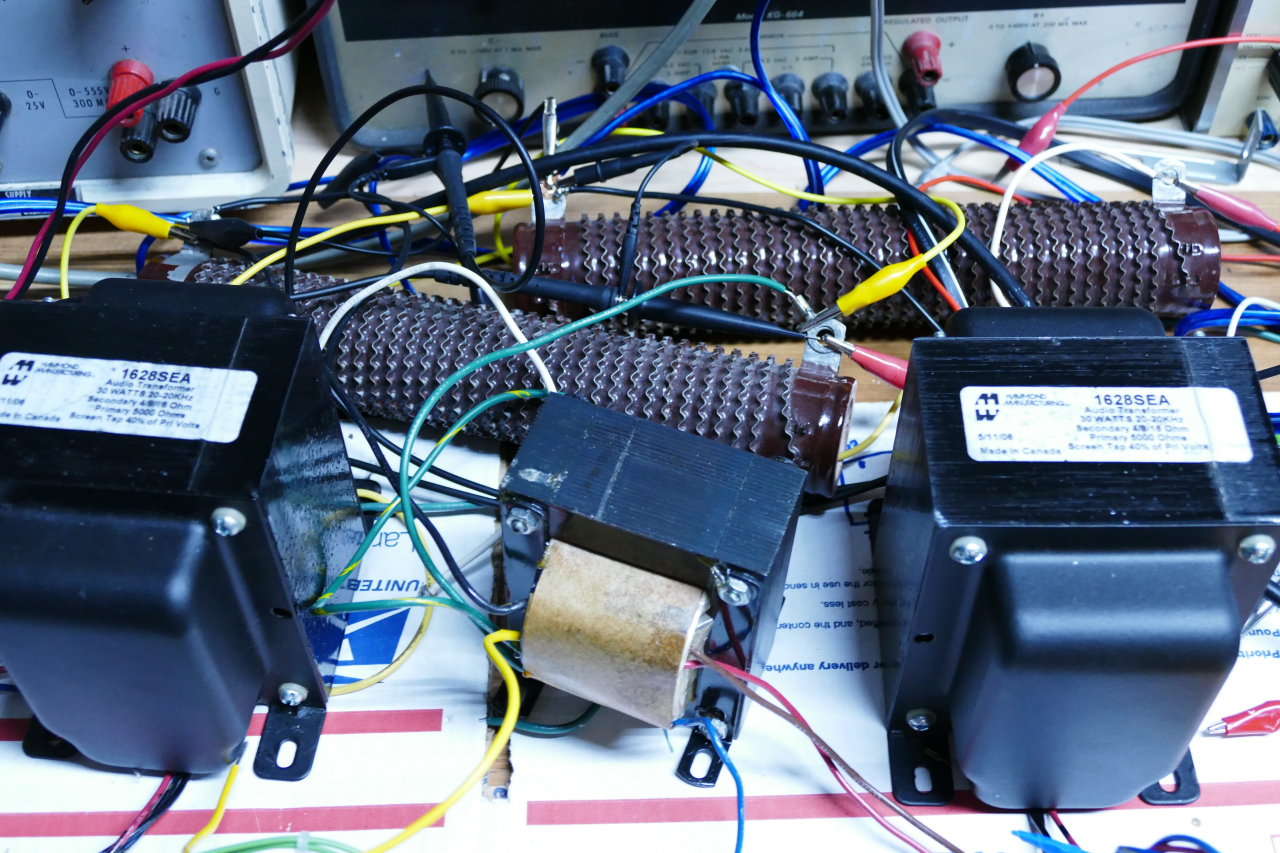

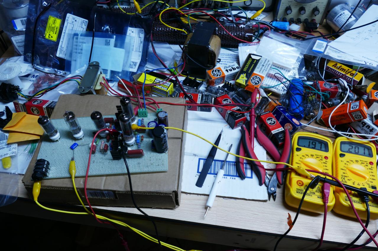

I did some more testing on the UNSET proto board last night. I'm using 5K ohm Hammond 1628SEA OPT's as 2.5 K transformers by putting the 8 ohm load on the 16 ohm tap. This is not ideal, but they are the biggest SE OPT's that I have at the moment. This arrangement usually results in loss of high frequency response, power output, and damping factor due to presence of more primary turns than needed for a 2.5K OPT. The extra wire raises the stray capacitance and winding DCR.
Despite these issues, the results are quite good for a Single Ended amp with one output tube per channel.
The output tubes are currently 36LW6's with B+ at 480 volts (limited by my 500 volt caps). I set the idle current at 120 mA per tube (max spec for the 1628SEA) for a plate dissipation of 48 watts. The 36LW6 is conservatively rated at 40 watts. It has a 2 inch tall plate compared to the 40 watt KT88's 1.5 inch tall plate, so I'm not worried running them at 48 watts. In post #31 they are just beginning to show plate color at 87.5 watts!

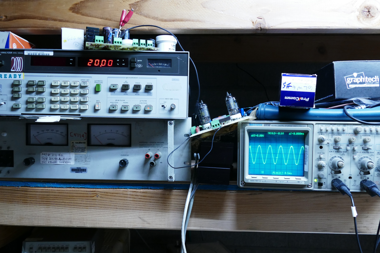

I made some of the usual "HiFi amp test" graphs and included them here.
The frequency response is plotted at 10 Watts power output, as opposed to the usual 1 Watt.
The THD VS Frequency is also plotted at 10 Watts. As expected the THD rises in the low bass region, that is the nature of a SE OPT, but how many low budget SE amps are under 3% THD at 20 Hz while making 10 watts?
I also plotted the usual THD VS Power output for three frequencies. 30 Hz, 1 KHz and 20 KHz. Trying to crank over 20 Watts (or any power level over 12 watts) through these mismatched OPT's at 20 Hz makes for some ugly saturation. Saturation is also the reason for the 8.21% at 22 watts and 30 Hz. The OPT's are operating at their maximum current spec.

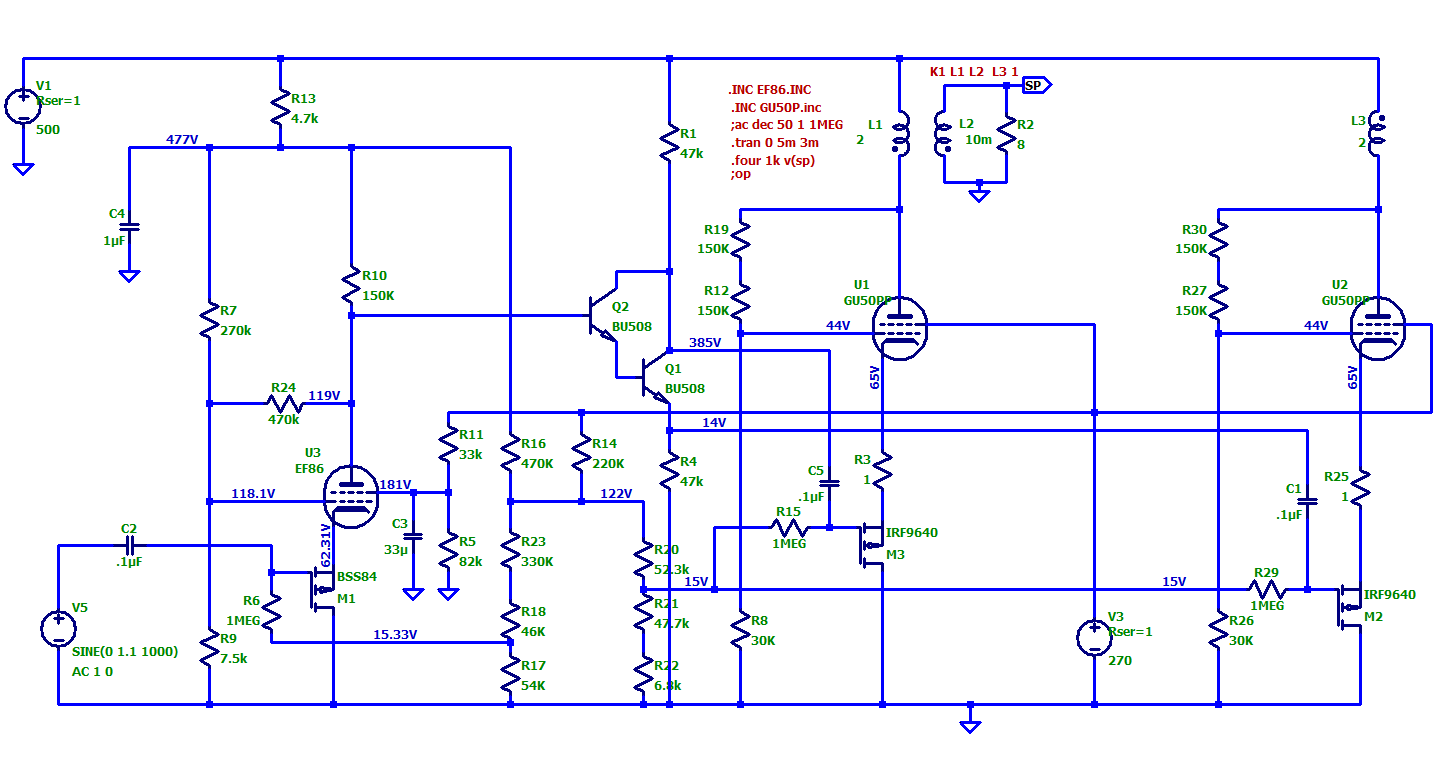

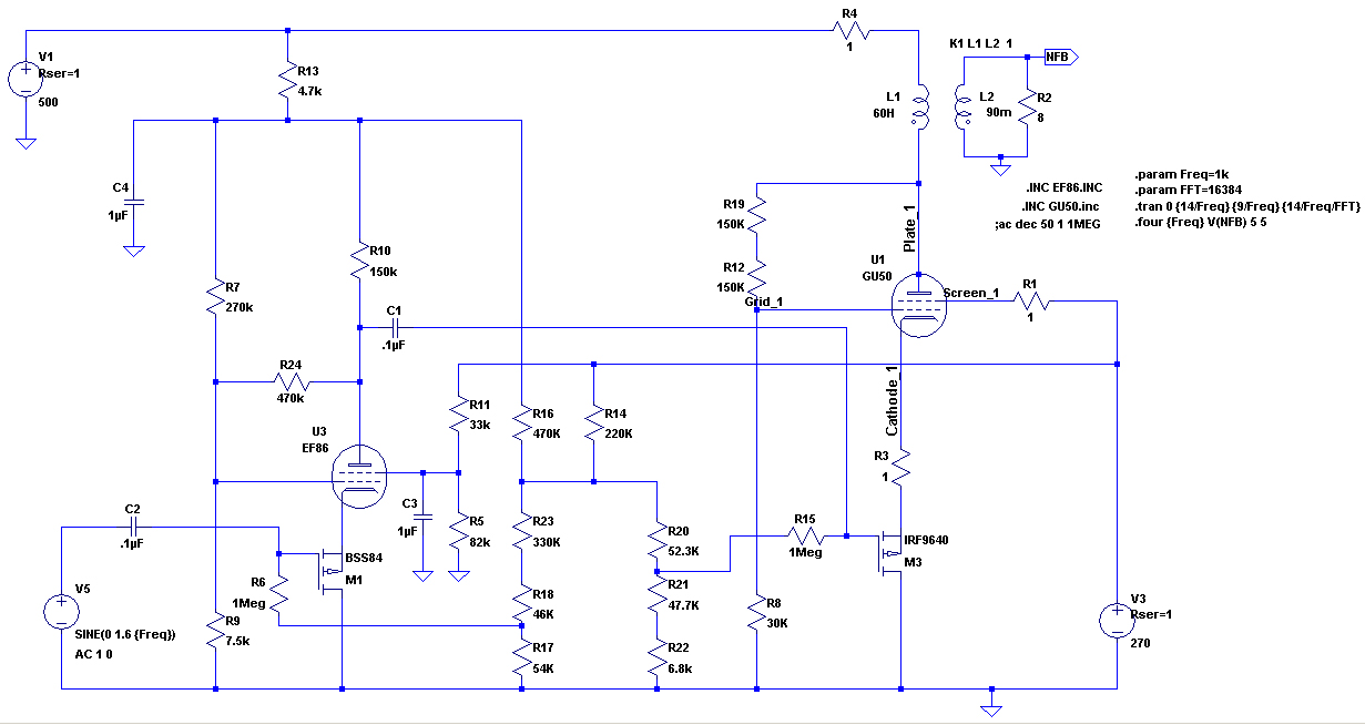

I've tried to tweak your schematic with EF86 and GU50, obtaining 10,5Wrms at 1% THD and 22 Wrms at 10% THD.
Code:
Harmonic Frequency Fourier Normalized Phase Normalized
Number [Hz] Component Component [degree] Phase [deg]
1 1.000e+03 1.303e+01 1.000e+00 179.45° 0.00°
2 2.000e+03 5.684e-02 4.362e-03 -81.68° -261.13°
3 3.000e+03 1.143e-01 8.768e-03 175.14° -4.32°
4 4.000e+03 5.119e-02 3.928e-03 89.47° -89.98°
5 5.000e+03 1.700e-02 1.304e-03 -175.63° -355.08°
6 6.000e+03 9.272e-03 7.116e-04 -89.37° -268.82°
7 7.000e+03 3.040e-03 2.333e-04 177.62° -1.83°
8 8.000e+03 7.773e-03 5.965e-04 -83.70° -263.15°
9 9.000e+03 9.023e-03 6.924e-04 3.65° -175.80°
Total Harmonic Distortion: 1.069713%(1.072210%)

Sorentos UNSEPP
I actually prototyped the GU50 version similar to Roberto's but with 6BN11 as input pentodes and a DC servo for the outputs because at least one of my GU50s (already heavily used) showed signs of thermal runaway above 30W idle.
Now here is a quick sim of a simple push-pull version, based on Roberto's.
4x the power, 40 W easily, and beyond when driven into B1.
The splitter is just a transistor concertina (2x HOT in darlington) for simplicity.
Still 1% at 10W, a little over 2% at 40W.
But to my utter surprise, the sonic signature and distortion spectrum does not change significantly for the PP-version, it still looks very similar when compared to the SE ...

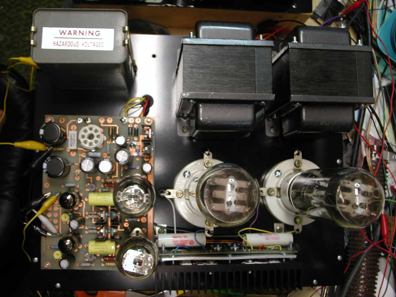

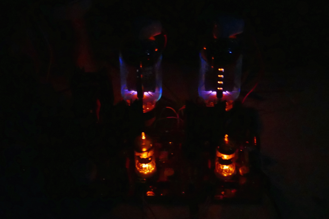

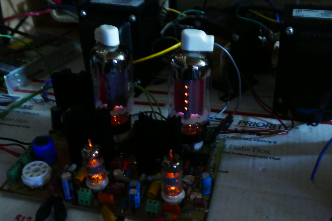

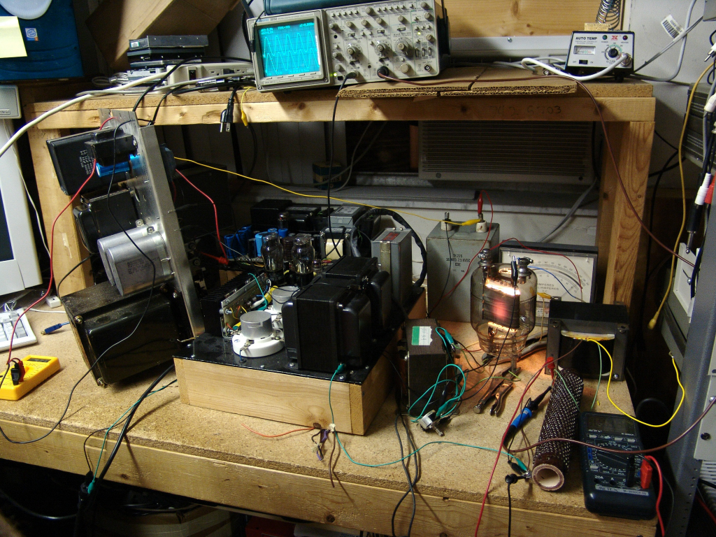

My "last big tube amp" has been in the planning / dreaming stage for far too long. It's time to actually build something before I get too old to move it. I'm looking at a vacuum tube kilowatt (500 WPC) using big TV sweep tubes, probably 6 per channel. Plate voltages will be in the 650 to 700 volt range with screen voltage at 150 volts.
In that quest, I concocted an evil experiment. I got my first prototype UNSET repaired to its original status as some parts were borrowed to build the second proto. It was loaded with the biggest sweep tubes I have, the 36LW6 and tested as a two channel SE amp with the big Hammond OPT's and still made about 40 watts per channel when run at 600+ volts.
I used a small Edcor matching transformer to drive the two channels out of phase and wired a push pull OPT across both outputs. I used a sacrificial OPT for the initial test, since I have several and did not want to risk a good OPT in an experiment that could end badly.
Then I attempted to answer two simple questions by using a little Edcor matching transformer for as phase splitter and wiring a push pull OPT across the output of both channels. The unset board is unchanged, except for reducing the bias from 120 mA per tube to 45 mA.
How many tubes will it take to get 500 watts. I now know that to be 6.
How much power (at 1KHz) can I squeeze through a $16 OPT designed for guitar amps by a battery charger company. I don't have this answer yet, but a pair of 36LW6's on 650 volts made the watt meter hit 253 watts in pretty severe clipping. THD is just under 4% at 200 watts, and 5% is at about 220 watts. I tried to take a few hand held pictures with the lights off, but that didn't work out too well. You can see the redness in the tubes at 220 watts, so 4 of them will not do 500 watts.
I started smelling something hot, so I powered down and touched a few things starting with the OPT. Yes one side was rather HOT....duh its between the output tubes and the load resistor that's eating those 220 watts (it was real hot and sitting on cardboard). The heat sink on the screen grid regulator (yes it's dropping 500 volts) was rather warm too.
After this thing cools off, I may try an expensive OPT to see how it works. The little guy in between the two 1628SEA Hammonds was used for this test. I'll use a tripod this time too.
__________________

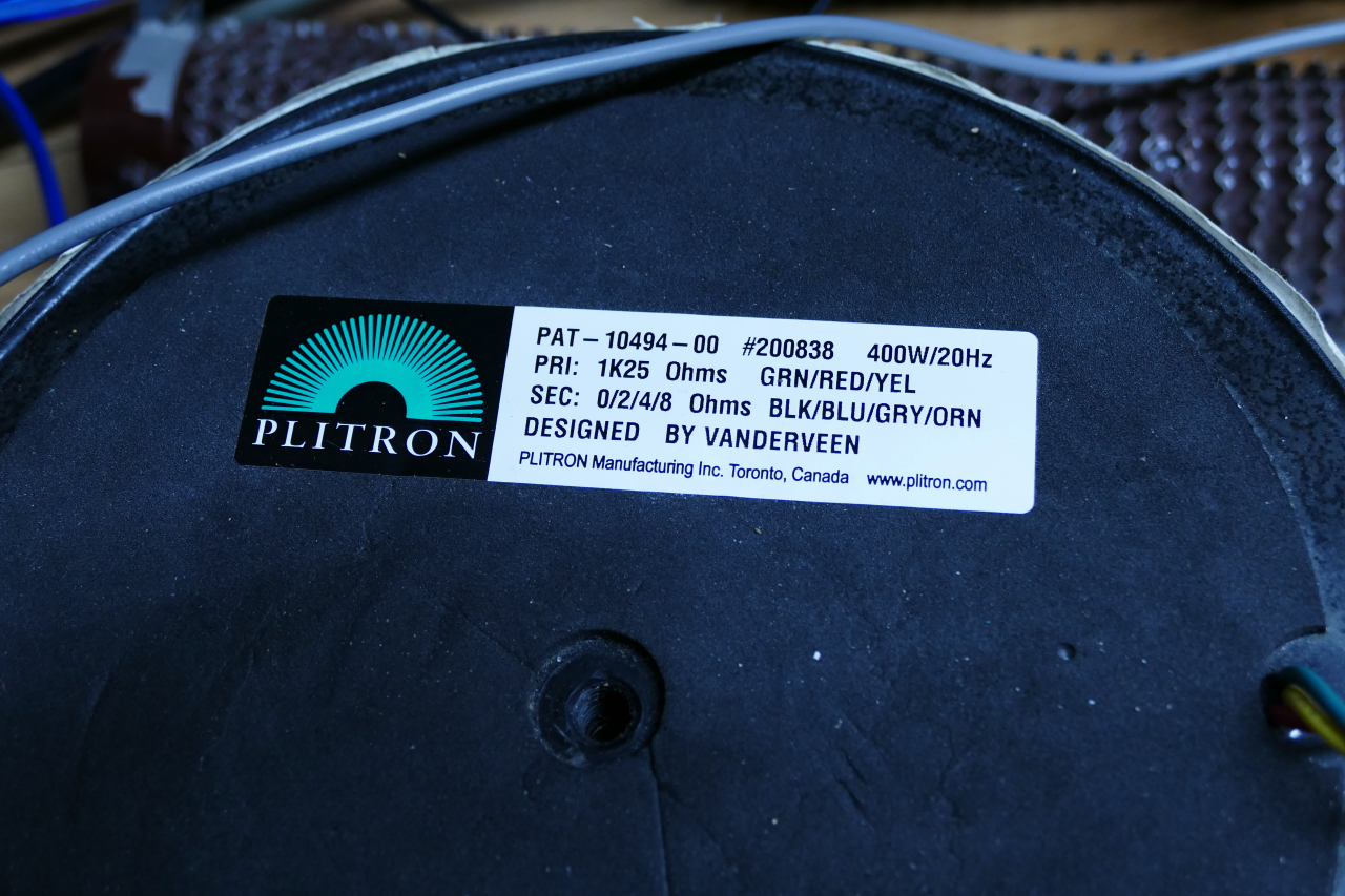

Previously, I got out the first iteration of the UNSET board, fixed it up and tried driving the two channels out of phase through a P-P OPT. I bought 200 of these OPT's about 20 years ago to make guitar amps for $16 each. I still have several, so I use them for experiments that could end badly, and I have destroyed or damaged only two in 20 years. One erupted in flames when a cheap Radio Shack dummy load blew open at about 150 watts with 6LW6 tubes on 750 volts. The second became a magnet when a plate to ground arc due to a couple KV on a 300 volt feedback resistor, again 36LW6's at over 150 watts output. What's in the UNSET board? 36LW6's......
After a couple hours of beating on the setup produced no smoke, fireballs, or severe EMP events, I decided to swap out the $16 OPT for the Mother Of All OPT's. It's about the same size at the UNSET board and far heavier, rated for "400 watts @ 20 Hz, this beast should be able to wring more power out of the test amp. It's a 1250 ohm to 0-2-4-8 ohm transformer, but has been used successfully at 2500 ohms to 0-4-8-16 ohms up to 250 watts, so I hook it up.
The UNSET board is still completely stock. I haven't messed with any of the feedback paths or changed any parts, just turned down the idle current to avoid melting tubes at high B+ voltages.
Since the tubes behave as triodes, the idle current will be highly dependent on the B+ voltage. I had not tested 36LW6's at 2500 ohms before, even in pentode mode, so I started at 450 volts and 50 mA per tube and worked my way up to 630 volts at 35 mA, keeping the idle dissipation around 22 watts per tube / mosfet pair in roughly a 90/10 ratio. I was planning to try 650 volts at 33 mA (power supply max), but I never got there.
The results at 630 volts at 35 mA were far better than expected, and show that I could probably use a little less voltage in the big amp.

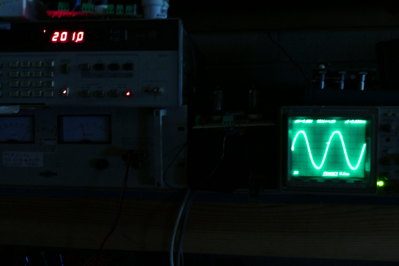

When I ran a frequency response at 100 watts test (the typical 1 watt test is just lame) some saturation was seen in the OPT.
Toroids, even big ones, are sensitive to DC and AC imbalance at low frequencies. I am using the primary of a little Edcor matching transformer as a phase inverter. It is running out of inductance and creating a drive imbalance, that I can't compensate for in the amp, so the LF results were slightly skewed. One output tube is obviously being driven harder than the other, as seen in the plates with the lights off. Even so the 100 watt +/- 3 dB frequency response is 11 Hz to 63 KHz. THD at 20 Hz was almost 4%, but remained below 1% from 46 Hz to 63 KHz. I have made measurements with these OPT's before and 63KHz is the upper 3 dB point in most cases (it's never been higher) so there are no HF limitations in the amp. Two LF poles with 1 megohm / 0.1 uF roll off the LF.
I ran a power VS THD and total current drawn from the power supply for the entire amp. Several watts were wasted in the screen regulator which dropped 630 volts down to 150 volts. Again, it blew up when attempting to hit 350 watts in severe clipping. The big amp will get a separate screen supply with current limiting to keep from killing tubes if the amp is driven to hard clipping for long periods of time. Who needs to run a 1 KW amp into clipping anyway?
Power THD total current
0.1W 0.430% 120 mA
0.5W 0.455% 120 mA
1.0W 0.462% 125 mA
2.0W 0.501% 135 mA
5.0W 0.569% 150 mA
10W 0.715% 180 mA
20W 1.15% 210 mA
50W 1.06% 310 mA
100W 0.880% 440 mA
150W 0.764% 550 mA
200W 1.366% 650 mA
250W 2.20% 750 mA
300W 6.88% unsure, PS went into I limit
350W power dropped off when screen reg blew.
As this test progressed the output tubes began to show red plate at 200 watts and got hotter at 250 watts. Peak efficiency was seen at 200 watts out, so the tubes don't like making 250 or more watts into 2500 ohms. 500 watts into 1250 ohms with 3 pair of tubes means each pair will see 3750 ohms and probably less B+.
If one channel drew 750 mA at 250 watts, two should draw 1.5 amps, or 945 watts, plus 202 watts for the tube heaters. The tube heaters will run from an SMPS, but the B+ supply is still unknown. Weight is the primary driving factor there. It all needs to draw less than 1800 watts to use a US spec power outlet (120 V @ 15 A)
The next step will be to make a proper phase inverter, then play with the feedback.

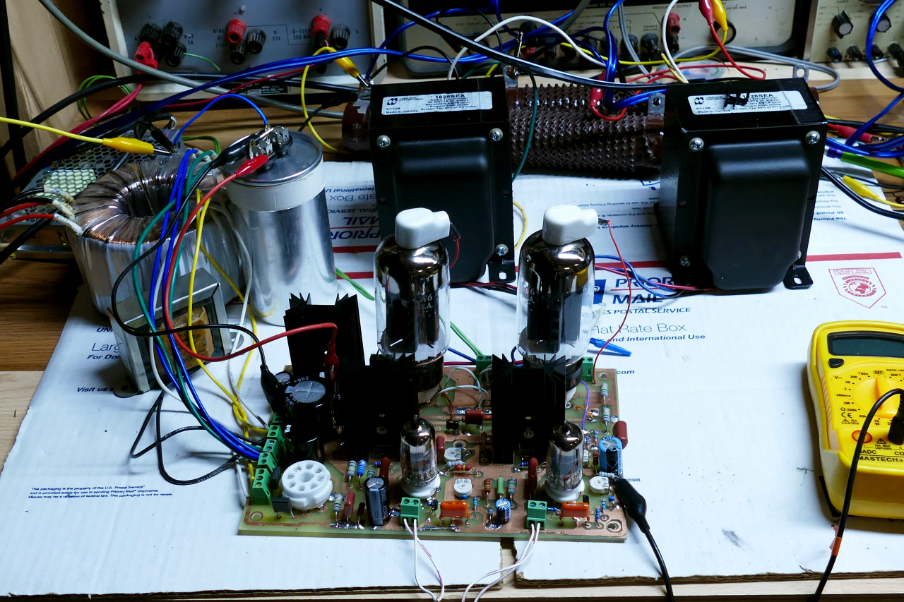

I briefly mentioned a little push pull amp that I made with 50C5 tubes in Post #39. It is seen here (pics#2 and 3) making exactly 20 watts from a pair of 50C5's after running all night long at full power. These were a common output tube in the AA5 vacuum tube radios that were common in the 50's and early 60's.
I have received a PM and a couple emails asking about the 50C5 board, it's origins, and where to "find" the schematic. The schematic for complete amplifiers will not be found on the internet yet, because it is new technology and very few complete amplifiers exist yet. The perf board amp seen here, and in post #39 was made up as I went along, but heavily based on an LT Spice simulation. I have not made a schematic of the complete board containing the amp, power supply, and guitar preamp yet since the preamp section remains unfinished and some component values were tweaked as the amp was tested and debugged.
The idea behind this board is to make 20 clean watts for the least possible cost, then stick a guitar preamp in front of it with the ability to drive it well into clipping. I need a new guitar amp, and if it eats my lousy guitar playing at full crank, then it is ready for less severe HiFi duty.
