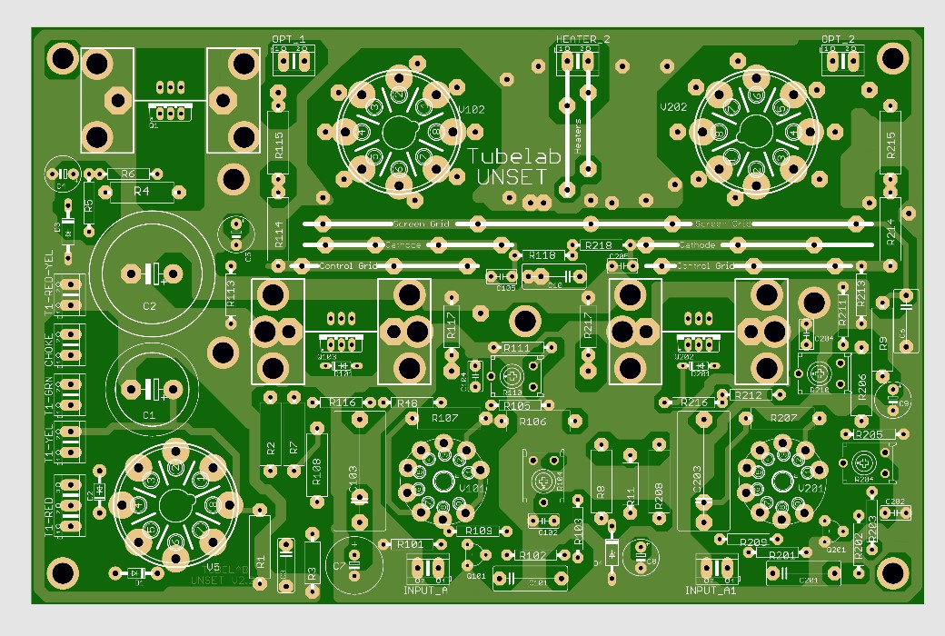

It appears that a few builders would want something like the two boards I have been using.
I'm totally ready to use whatever you want to put out there (here).
I figure that your generosity in working all this out and putting it into a board for us likely nets you something less than ¢50 per decade of your considerable (and it should be noted, pyrotechnically entertaining) experience. Whatever suits you suits me. And thanks in advance !
..to avoid using those precious 5842 drivers. What sort of drive are we talking about... Are we gonna need tube shields for our pentode?
The drive VOLTAGE level required depends on the choice of output tube. The single board design that I am currently working on is limited to octal tubes. Another design for a different output socket could be done if desired, but let's see how this goes. I have run this board with everything from a 6V6 to a 36LW6. The drive voltage requirements are also highly dependent on the feedback resistors used to "trioderize" the pentode.
The board contains a 9 pin socket wired to accept any tube with the 9AQ, 9PM, 9NW, 9GK, 9BF, and 9AU pinout. Some type numbers are 6EJ7/EF184 6EH7/EF183 6GK7 6JC6 6JD6 6HM6 6KT6 6HT6 6HA6 6HB6 6KY6 6GK6 12BY7A 12GN7 12HG7 12HL7 11HM7 6686 E81L 6BR7 6059.
No shield should be needed on most of these tubes since they are internally shielded.
The version with off board sockets will have more room so a jumper option will be added to also accommodate 9EQ, 9G, 9NX, 9BL and 9CV tubes, just in case someone wants to stick D3A's in this thing. I have two of them, but haven't tried them yet. The extra space will also allow for inclusion of more feedback options that will be optional like the plate to plate resistors on the UD boards.

My only concern about off board tubes would be stability. But most power tubes are low mu, so probably not an issue.
If there was a part I could not find, I would write them asking where I could buy one or two pieces of the part. Invariably, I would get a few samples of the part back in the mail.
I still have some LM1596H and some LM1035 (6?) and LM1040 that I got that way.
Octals are fine (for now 🙄).
How flexible are the pin configurations?

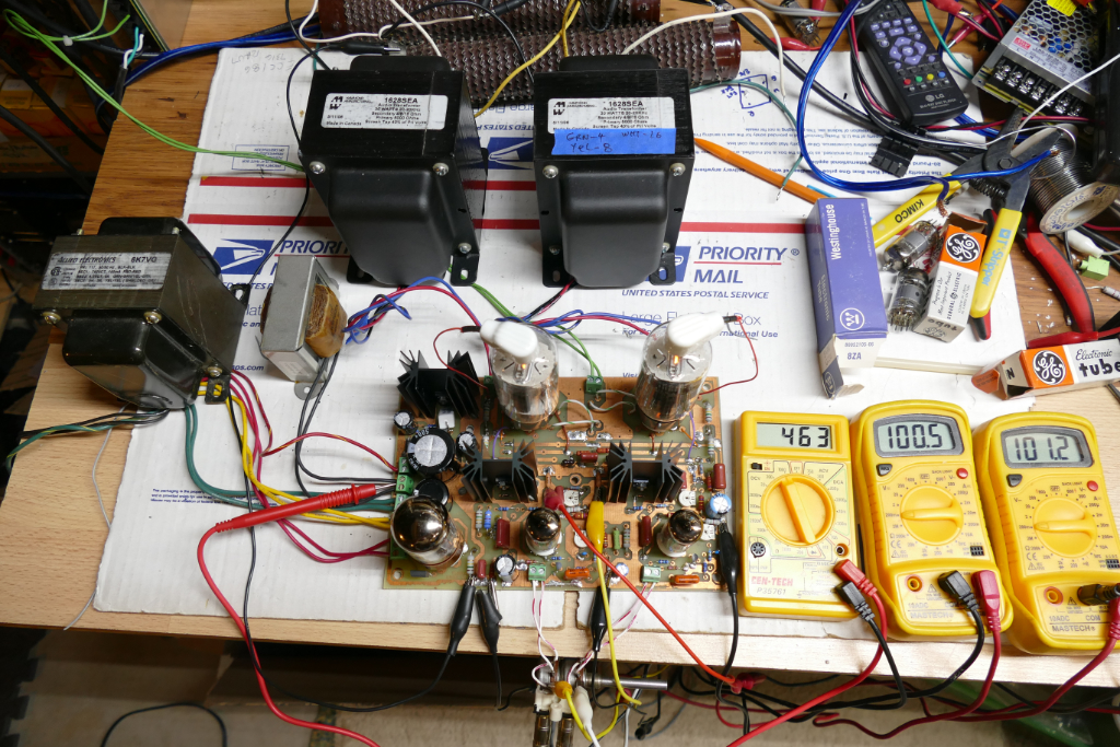

The current board configuration has a pair of octal sockets with a jumper hole for each pin. There are also buses for H, K, G1, G2 and P nearby so that the board can be configured for any octal tube......well any octal tube capable of amplifying an audio signal.
These can be seen in this picture of the prototype. The white / green wires connect the heater pins to a par of PCB runners running between the output tubes. The brown wires connect the grids, and the orange wires connect the cathodes. Multiple holes are provided to allow for short wires with many different tube types.
The heater terminals for the driver and output tubes are separate since most driver tubes are 6.3 volts (or less) while most of the cheap sweep tubes come in odd voltages.
Obviously these wires can run to external sockets which is being tested now.
This is exciting and thank you! Can’t wait for the boards! I had hoped for a more modular approach, but if you determine differently we will work whatever you bless.
I have ordered some 6DQ5 tubes in anticipation of the boards, since I think you favor 8-pin 6DQ5 tubes. If I could read the tealeaves I could make money in pre-buying the market. Hopefully you can too. Whow, we’re in this stockmarket.
I had hoped for a more modular approach.
The modular approach is coming. It unfortunately requires laying out, several new boards, while the existing board is well, already existing. Still it takes me a bunch of time to go over all the little details needed to make it worthy of the Tubelab name. If all goes according to plan I may send it to fab later next week.
Yes, the first board will use octal tubes. I must sell enough of them to pay for the next version or versions. Octal tubes are available world wide, while many other popular sweep tubes are not.
