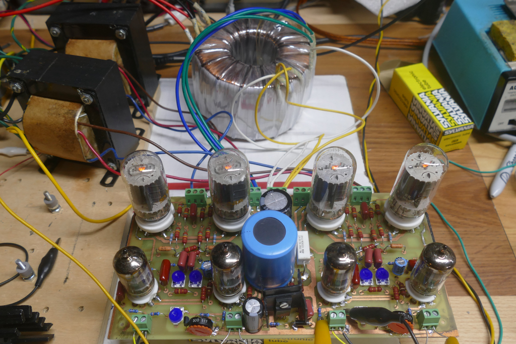

The UNSET is an amplifier design that uses CED topology for its driver and output stages. A small CED is built with a high Gm pentode for the input / driver stage. I used a 6EJ7 / EF184 in the simulation, but stuck a $1 tube in the test board.
The output stage uses an identical circuit built with bigger parts. I laid out the board such that several popular octal tubes could be used, but messed this section up pretty bad. I wired it up to use an unloved and unwanted octal sweep tube that I have LOTS of.....A popular tube seller sold me over 100 of them for under 50 cents each!
After finding my mistake with a backwards zener diode, I was really surprised by what happened next.........

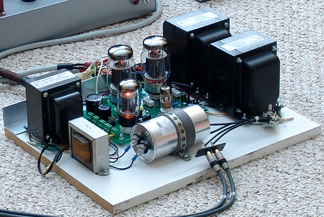

I connected the board up to an external bench power supply, my old Fluke 407D. I installed one input / driver tube and attempted to test the input stage by itself, but voltage readings everywhere were all wrong. Nothing came anywhere close to the simulation, and the output was highly distorted. Some poking around with a voltmeter revealed a mistake I often make.....I got a diode in backwards in both channels.
After fixing the backwards diodes the input / driver stage fired right up and revealed performance close to the simulated circuit. The DC voltages were a bit off, but I didn't even have the right tube in the board, so how could I complain.
I cranked up the input until the driver hit clipping and backed up a wee bit. I was getting 56 volts RMS! This is more than enough to drive the grids right out of just about anything. The THD at a sane 20 V RMS was 0.2%, no complaints here. Frequency response? What's that? The driver is flat from 5 Hz (generator limit) to somewhere beyond 100 KHz where the 8903A stops reading.
I stuck in a pair of 25DN6 tubes and wired their heaters to a 24 volt SMPS, turned up to 25 volts. The 25DN6 is an old sweep tube dating back to the mid 50's. They can still be found in large quantities for about $3. They are NOT all created equal. The old ones from the 50's are built to their 15 watt plate dissipation ratings. Some of the newer vintage tubes have BIG plates inside! The GE's have a plate that is identical to what's inside their 24 and 28 watt tubes, so that's what I stuck in the amp.
I set the Fluke on 450 volts, and turned the bias up to 100 mA per tube.....yeah that's about 40 watts (OPT and other losses). I used a pair of 3000 ohm Transcendar OPT's that were still on the bench from my TSE-II board testing. The amp came to life immediately and surprised me with performance.
The THD at 5 watts was under 1% except at the frequency extremes where the OPT limited the performance.
The -3dB point at the low end was 8 Hz where the THD was 26% due to OPT saturation. At 20 Hz it was 0.54 dB down at 4.03% THD.
The upper -3dB point was arounf 50 KHz where the THD was 1.58%. At 20 KHz the amp was 0.62 dB down at 0.56% THD. NOT bad......so crank it up!
Thd was 0.197% at 100 mW, rising to 0.235% at 1 watt. 5 watts brings 0.662%, 10 watts 1.61%, with 2.48% at 15 watts and 4.04% at 20 watts clipping sets in at 20.8 watts where the THD hits 5%.

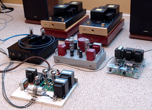

I then hooked up some speakers and cranked on it for several hours. It's one of the best sounding amps I have heard.....I really want to do a side by side with a TSE-II.....
I did discover that the amp will exhibit a foldover situation when both channels are driven well into clipping. This was traced to my conservative settings on the current limiter in the screen regulator which feeds all 4 tubes. It would be easy to just turn up the current, but maybe two separate regulators is a better solution......time will tell.

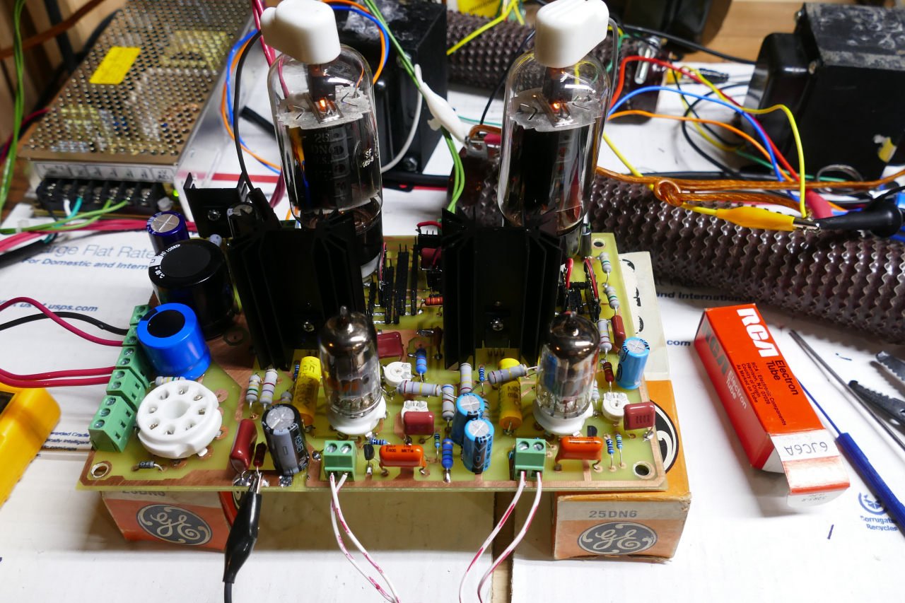

It started when I swapped the Transcendar OPT's for the big Hammond SEA1628's which have never sounded quite right when fed by the usual suspects, a 300B, or triode wired KT88, so would a triode emulating sweep tube do any better? The transcendars are 3000 ohms, the Hammonds are 5000 ohms, but could be wired for 2500. I chose 5000 for the first test.
I had seen the screen supply collapsing due to a built in current limit when driving it hard with music, but it seemed worse when I drove both channels into clipping with a 1KHz sine wave, so I did the usual Tubelab quick fix. I put a clip lead jumper across the sense resistor.
Power output went way up, but before I could record any numbers there was a bang, and some mosfet parts scattered on the workbench. The amp however kept on making power, so I believe that the mosfet is probably the only casualty, but my sense resistor had unsoldered itself, so the fet obviously needs a bigger heat sink. I'll get back to if after it cools off.
On top of that our youngest grandkid, age 5, shattered his wrist yesterday. The fun continues.
Mischief grand pa style? 🙂
Not intentionally. Apparently there were random clothes scattered on the floor in the room he shares with the 7 year old. He tripped on something and fell, whacking his wrist on part of the bed frame or a night stand on the way down. The same kid broke his elbow last year by crashing down the stairs. The other three kids have had no issues, so he must be clumsy, fragile or both.
Power has been restored to the UNSET board. The mosfet was scattered, but it was the only casualty. I had soldered a resistor in parallel with the sense resistor in my first attempt to boost power, which I subsequently jumpered. The resistor became unsoldered and the jumper which was connected to B+ left its mark on some small parts, but none of them were blown. A bigger mosfet and a 5 watt sense resistor have allowed for continuous operation well into clipping. Some quick knob turning seems to indicate that the big Hammond likes this circuit and it's HF response extends to beyond 30KHz.

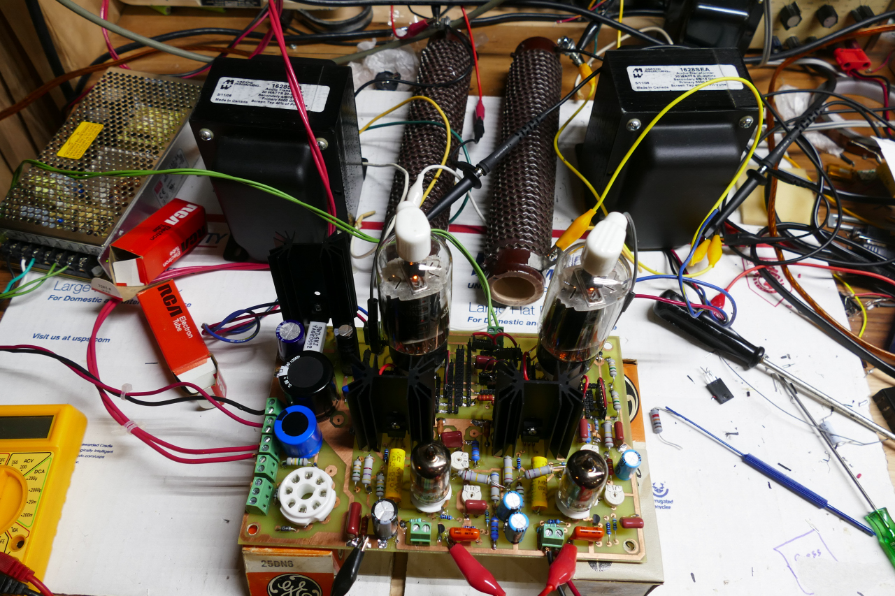

I got one more experiment in today.
The date on these Hammond OPT's is 5-11-06. Yes I have owned them for 13 years and never found a suitable way to get HiFi quality audio through them. They can be seen here with one of the first SSE prototypes powering up some Lowther based horns. They sounded terrible here since the 106dB efficient Lowthers were loud with half a watt. The final "first SSE" wound up using a pair of Transcendars like those I just pulled OUT of this amp. They sounded quite nice with the big horns.
The power at clipping had dropped to about 15 watts when I traded the 3000 ohm Transcendar OPT's for the big 5000 ohm Hammonds. How do I get more power......turn the knob to the right!
I cranked up the power supply to 520 volts. That's as far as I want to push the 500 volt filter caps that are in the board. This brought 22 watts at the edge of clipping (5% THD @ 1 KHz). THD at 20 watts was around 2%. I backed the power down to 10 watts and turned the frequency dial on the 204C. At 1 KHz the THD is 0.68%. At 20 Hz the output drops 0.40 dB and the THD rises to 0.88%. Going much below 20 Hz starts making my all original Fluke 407D angry. It's current meter is hovering around 260 mA.
Spinning the dial in the other direction reveals a drop of 1.01 dB at 20 KHz. This is where the famous Hammond notch of anywhere from 5 to 15 dB resided in the past. This board has "tamed the beast." Turning the knob past this point sends the current meter on the Fluke beyond the end of it's scale, so I didn't test there. The OPT's get very capacitive beyond that notch driving the tube current up, and into the red zone.
Running the output stages at 520 volts and 105 mA brings on some mild red glow, so I must point out another feature in the UNSET board, albeit one that I botched pretty bad in the layout.....the "Any Octal Matrix." The board can be configured for almost any octal output tube from the little 6V6 and 6AU5's to the fat boy 6LW6......so you know where I'm going next. That's right, bigger tubes and higher voltage caps.

I cranked up the power supply to 550 volts (max output for my old Fluke 407D), pointed a small desk fan at the heat sinks, turned up the tube current to 120 mA (max spec for the Hammond 1628SEA).
Power output at edge of clipping (5% THD) rose to 25 watts.
Power consumption breaks down as follows:
The B+ voltage is 550 volts. The current meter on the power supply reads 270 mA for a total DC input of 148.5 watts. 2.6 watts are lost in the OPT's DCR. The mosfet eats 10.6 watts, and the tube burns 52.8 (yes it's rated for 15 watts. I promise I didn't melt them....... This is a total power input of 183.5 watts, but some power will be wasted turning line voltage into 550 volts DC, and some will be lost in the SMPS for the 26 volt heaters if used. I'm assuming that total power draw will be in the 200 to 250 watt range. The amp is class A, so the power consumption doesn't change much from idle to max power.

So after turning up the power, I connected up some speakers and let it play for about 3 hours......ME LIKE!
After a couple hours I began to smell something toasty I was thinking the 500 volt cap eating 550 volts, but it turned out to be my old Fluke 407D. It didn't like running at max power for 3 hours, so I shut off the fun. I will be gone most of tomorrow and Sunday.
I sat there staring at the board and sketching out stupid ideas on scratch paper while I cranked out the tunes from the amp tonight.....here are my latest ideas, but I may change my mind by tomorrow. I'm really thing about a short path to building myself one of these with some chassis and stuff that I already have. I have the Hammond OPT's and some big Antek power toroids.....
That still leaves the issue of multiple different heat sink sizes. I'm now thinking of one board similar to this one with all 5 tube sockets and heat sinks like what's on the board now. It could work at power levels up to 10 watts and use any of the common older generation sweep tubes. Sort of like a cross between a TSE and a SSE.
Then for us experimenters and power hungry amp builders a second smaller board, ditch the rectifier tube since a 5AR4 will not support the power levels needed for a 30 WPC SE amp, so silicon (on board) or damper tubes (off board) must be used. There would not be any output tubes on the board either, just terminals for the 5 electrodes being used. I got visions of those 4D32's wired into this thing. The heater wiring could go to the board, or directly to the transformer or SMPS, with one terminal for the variable heater DC float voltage. The mosfets would be mounted on (or to) the board's rear edge to allow multiple mounting schemes.
I have a little push pull version where I did stuff everything on one board. It works really good, but gets too hot and was a nightmare to build. The heat sinks are on the bottom. It used a conventional pentode LTP for the PI / driver since the CED does not lend itself to being wired as a PI. The output stage is CED with a tiny 6GF5 sweep tube with a 9 watt plate rating. 50 WPC flows easily without and redness from an Antek power toroid, and 70 WPC can be had with the Fluke feeding a regulated 500 volts.
Scale that up to 30 watts output (maybe 600 volts B+). The heater consumption doesn't change, neither will the B+ current due to the OPT max rating, so the B+ power consumption goes to 600 volts * 270 mA = 162 watts, and the total goes to 197 watts. This looks like 225 to 275 watts drawn from the line.
In contrast that to my 845 SE amp. It ran 80 to 110 mA per output tube at about 1050 volts DC. We will call it 100 watts per output tube. This was derived from a backwards wired 480 volt industrial control transformer feeding a voltage doubler made with 5AR4's (10 watts per heater). Total power from the wall was over 300 watts but I don't remember the exact number. Their heaters draw 3.25 amps from 10 volts EACH and they need DC to be quiet. That's another 80 or so watts.
The driver was a complete 45 based TSE with a 450 volt power supply to feed the CCS load on the 45 (no OPT, just a powerdrive board). I don't remember the exact numbers but the complete amp drew well over 500 watts from the wall, and really heated up my room, so it didn't get much use in Florida.
I kind of like the idea of a hole in the board, and pads to skywire a builders choice socket to the board.
