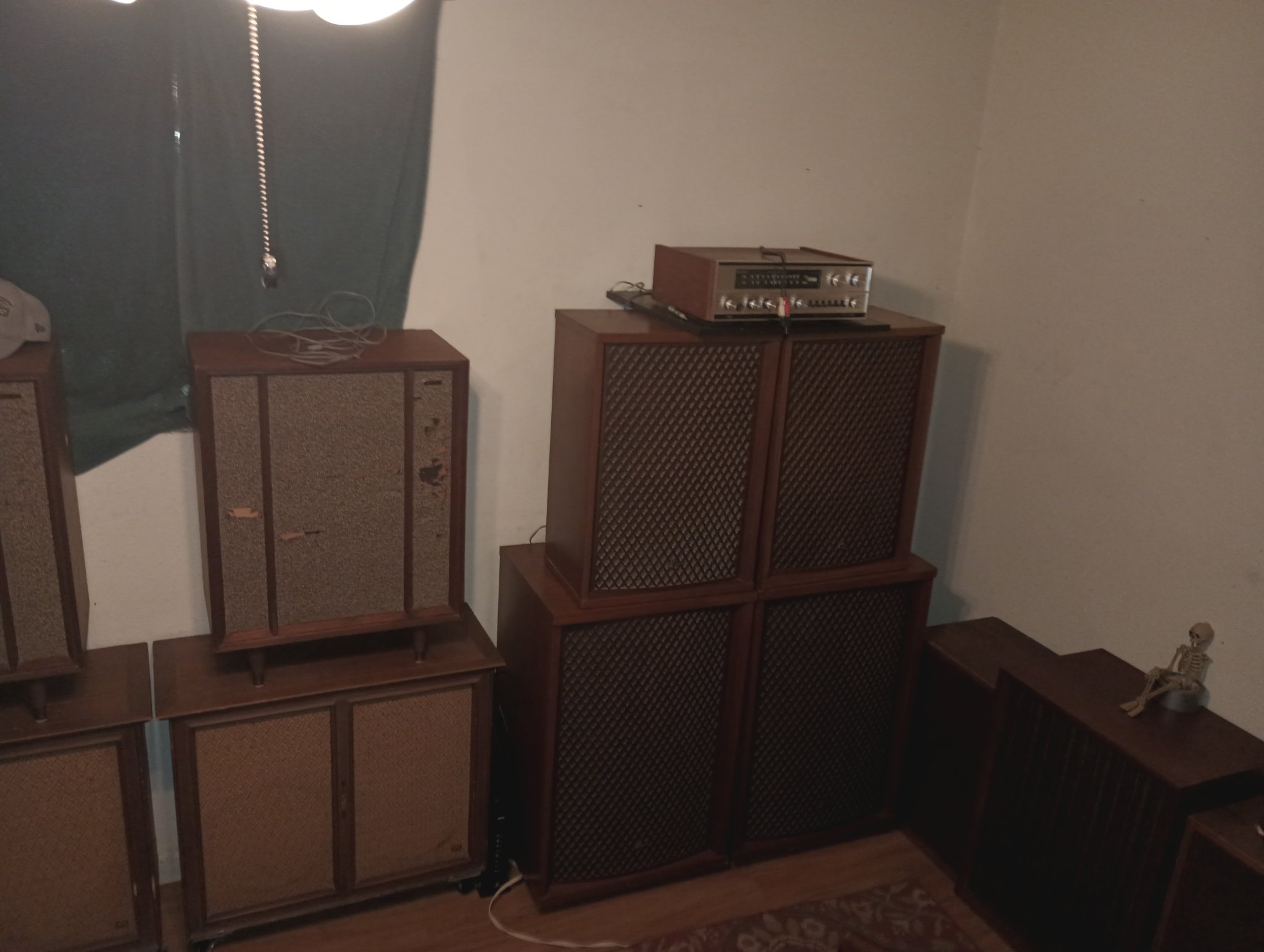

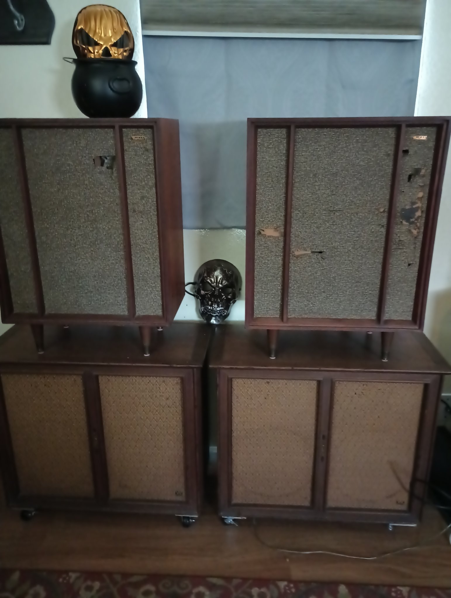

I know I'm a year late to this conversation but in this past years I picked up a set of those speakers and I currently have them running with set of Sansui sp5500 (no X). I also have the w70 which go fantastic with either one. I have been running a pioneer SX 1500 t from 1968 using the two sets of speaker outputs and the configuration you see behind the drum set. Is nearly the width of my living room and is extremely pleasurable at any volume level. My Pets look inside of all of these speakers for whoever is playing those instruments. Speaking of these w-90d i'm trying to get a good tube amp from the late 50s early 60s..stereo prefers. El34, or 7519, or higher.powered t.. I'd really like to leave the speakers laid out as they are there but what would be the best way to go or what would be the possibilities they're all, 8ohme these two sets of speakers what's the best way to go? Is it safe to put the two 8 ohm speakers in parallel and use the forum taps on the the Fisher dynaco Scott eico Heathkit etc ? Or do I need separate stereo amp for each set of speakers to keep it at 8ohm stereo load. I'll tell you what these w-90d came to life when I switched from the pioneer over to a sansi 1000 that had one channel fried . I turned it into mono stereo so gave it half the power (split mono stereo usng1 channel, y cable etc .. holy wow and then I switched it to the sp5500. Too much.. even the wood grills moved.. I really like the combination of the w90d with the w70 and I really like the combination that you see on the floor there behind the drum set and I really like the sp5500 accurate but still intense .. mixed with smooth and very difficult to make sound bad w-90d. The sp5500 are much more sensitive to change in the bass treble adjust

The real question is ... Which amp would sound the best with that 4speak setup. (Pair of W90d and sp5500)Fisher x202b, St-70 of dynaco and eico st-70, various h/k , many many similar powered tube amp stereo from 58-63 ish.. I'm looking something for the perfect amount of power for those four speakers but everything that you saw in my speaker room photo up there except for the drum set I started with $20 I don't have a job and I ended up with all of that and that's only 1/4 of it
