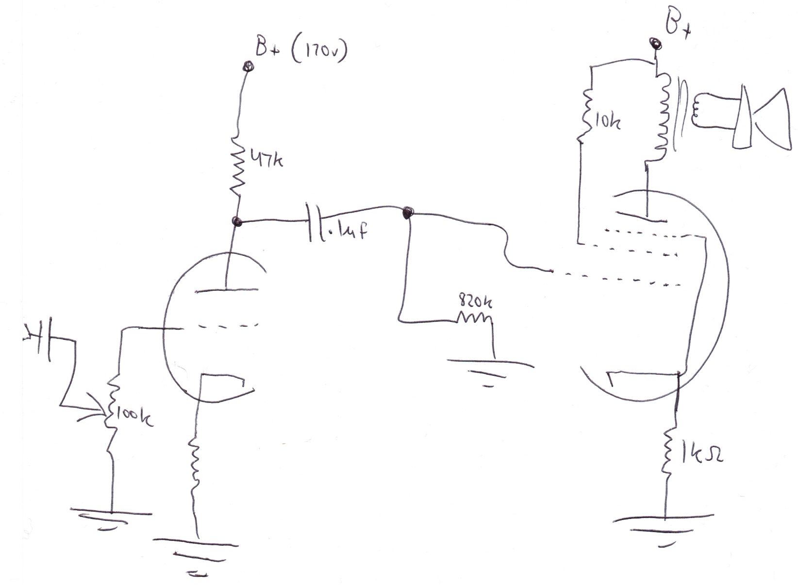

Yeah, that was a typo covered a couple posts back in the thread. The tube is a 6AW8A, triode/pentode combo. I got the basic circuit together and ran DC tests, which looked good. Current levels well within tube specs, etc. In AC tests, the triode seemed to amplify with no issue but the pentode section has issues. Troubleshooting will have to wait until I get more time....

Here's the rough schematic, pin numbers omitted, tube = 6AW8A. Will be trying 6BA8A as well, same pinout and close-enough specs. I haven't added bypass caps to the cathode resistors yet, but intend to once the rest of the circuit checks out.
No bypass cap across the output tube 1k cathode resistor = very low gain.
Also, with a 10k screen resistor, that may cause low gain, and distortion too.
0.1 uF coupling cap, and 820k g1 resistor has a - 3dB low frequency response of 2Hz (-1 dBk at 4Hz).
That is a much lower frequency than the output transformer, and the speaker can reproduce.
820k does not substantially lower the gain of: a 47k triode load resistor that is in parallel with the triode rp.
The question is, does the pentode section of the 6AW8A have a specified maximum g1 resistor value?
Do not exceed the value of that specification for the pentode g1.
For cathode-bias ops, both sections specify 1M as max grid resistor value. I'm well under in both cases. As for the 10K on G2, I chose that because I've seen that used on a number of schematics for similar pentode circuits, and I have no other frame of reference for what to use on G2. The spec sheet talks about not exceeding 3.5mA on G2, so I guess in my case 68K would make more sense unless I'm not understanding something.
Do you recommend blocking resistors in this simple circuit?
PS, I changed the .1uf to .01uf. Smaller size cap, made more sense in this circuit. May go to .0047, but don't want to cut lows TOO much.
Tested it again with no audio input, and I have a nice 4-volt nearly-perfect sawtooth at the plate of the pentode. This is with the 68K at G2 now. Will come at it again tomorrow, closing up the shop for the night.
Is it bad manners to quote myself, lol? Figured out that the sawtooth was amplifier power supply ripple. Added an 8K resistor and 47uf cap, and the ripple from the pentode plate dropped to around 50mV. More to come as I get time.
