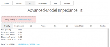

By performing three impedance measurements instead of two (as in the classic added-mass method), the pure motional impedance can be extracted with a minimum of model assumptions. From this pure motional impedance, the viscoelastic parameter, β, is then determined. The remaining blocked-electrical impedance can be derived by a relatively simple set of algebraic operations. As part of the analysis, the algorithm attempts to extract a stable value of Bl over a region of about one octave around the resonant frequency. This approach gives a useful indication of the robustness of the overall fit.
After the fitting procedure is complete (step 6) the fit quality is automatically assessed. In the Quality tab of the FIT app, a fit rating is provided (see fit.png in part 10). This means you don't have to be an expert in analyzing the output from the fitter. Possible ratings are
(1) EXCELLENT, (2) GOOD, (3) FAIR, and (4) FAIL.​
Beyond these simple ratings, the user can also study the graphs in the succeeding tabs, where the app provides plots of the motional impedance (ZM), the blocked-electrical impedance (ZE), a model test which essentially compares your three measurements with the simulations based on the established model parameters, and Bl over the fit range. To get an excellent rating probably requires some practice and experimentation with the added mass approach. The good rating is nevertheless sufficient for reasonably accurate box simulations. The Speakerbench article in the Loudspeaker Industry Sourcebook 2020 explains more about this (Ref 4).
