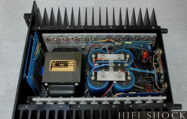

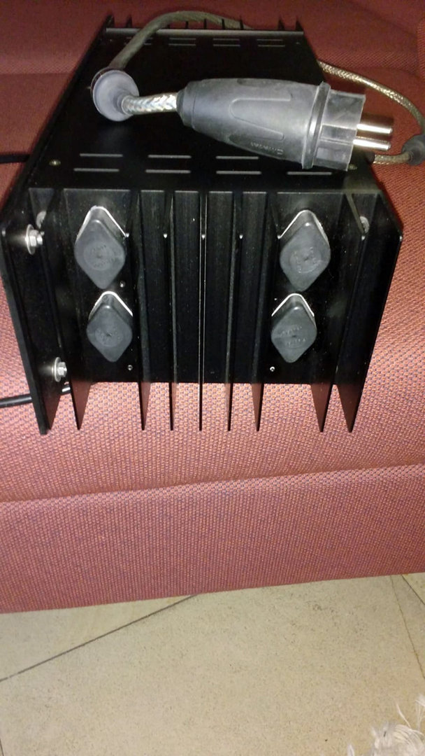

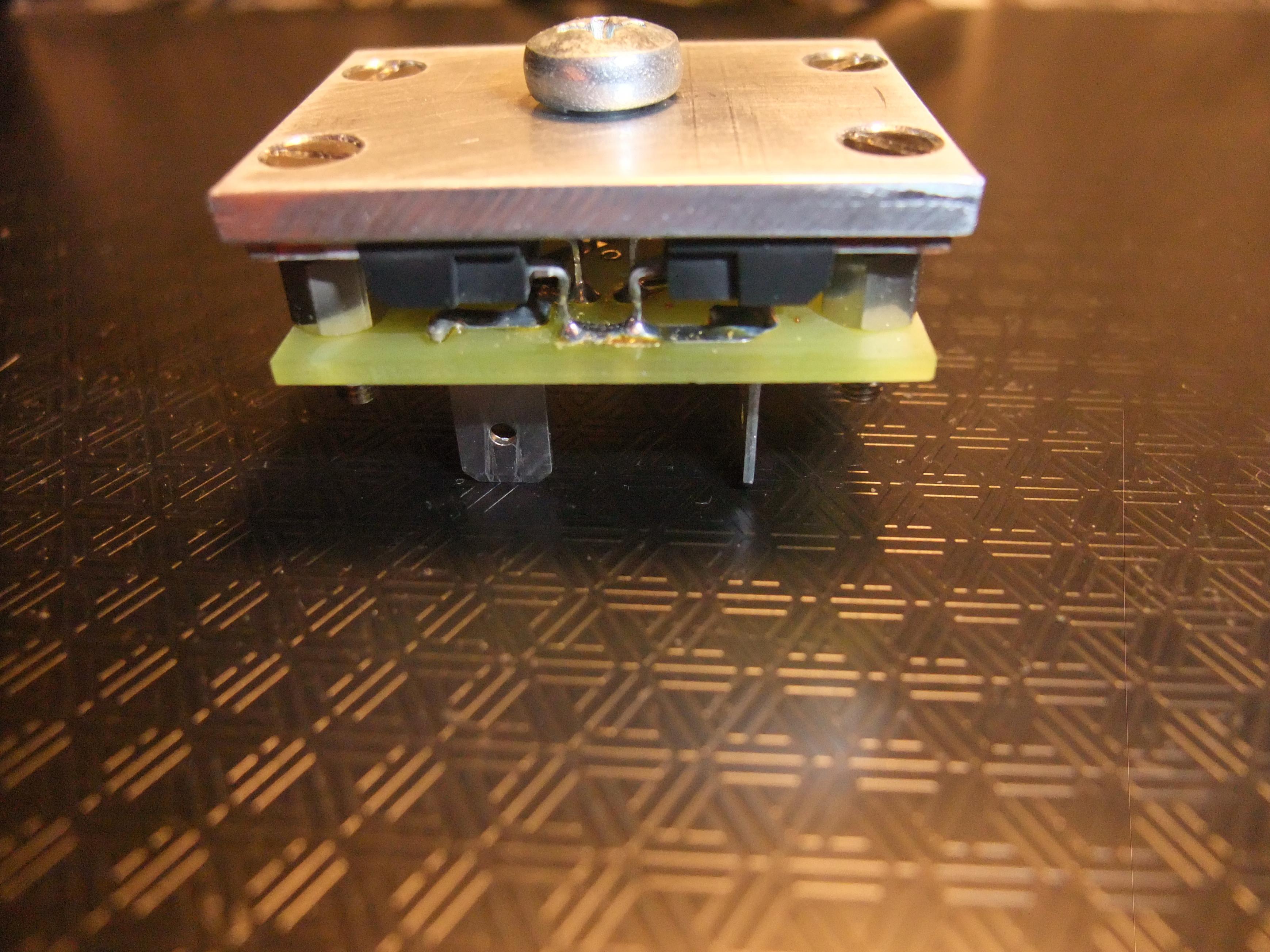

The one from the attached images are mounted in a power amplifier from the German brand Horch, model "3.0S"
http://www.horch-gmbh.de/Produkte/HORCH 3.0 S.pdf
also suited for replace the usual rectifier (like to find under the first URL) in the cheaper Horch model "3.0"
http://www.horch-gmbh.de/Produkte/HORCH 3.0v.1.pdf
No additional snubber parts like to see under
https://web.archive.org/web/2010040...oltSecond/Rectify_1/rectifiers_and_xfmrs.html
were used

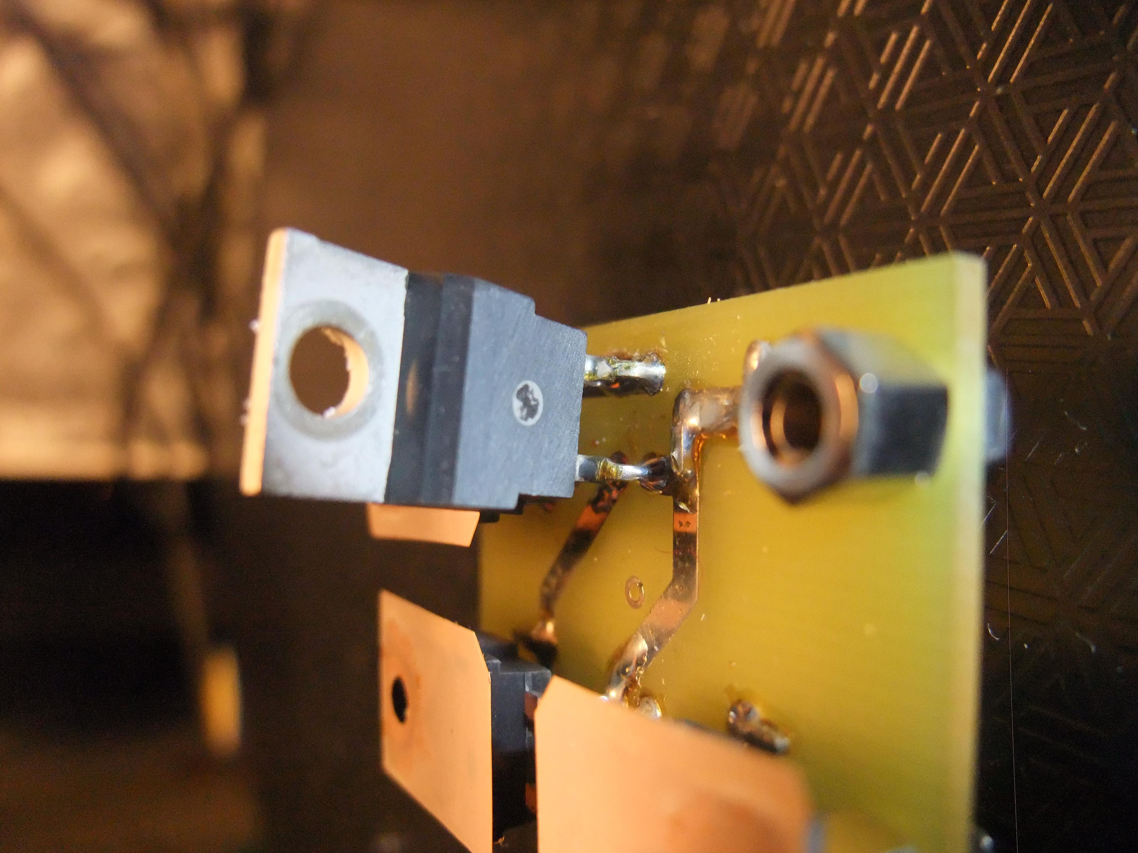

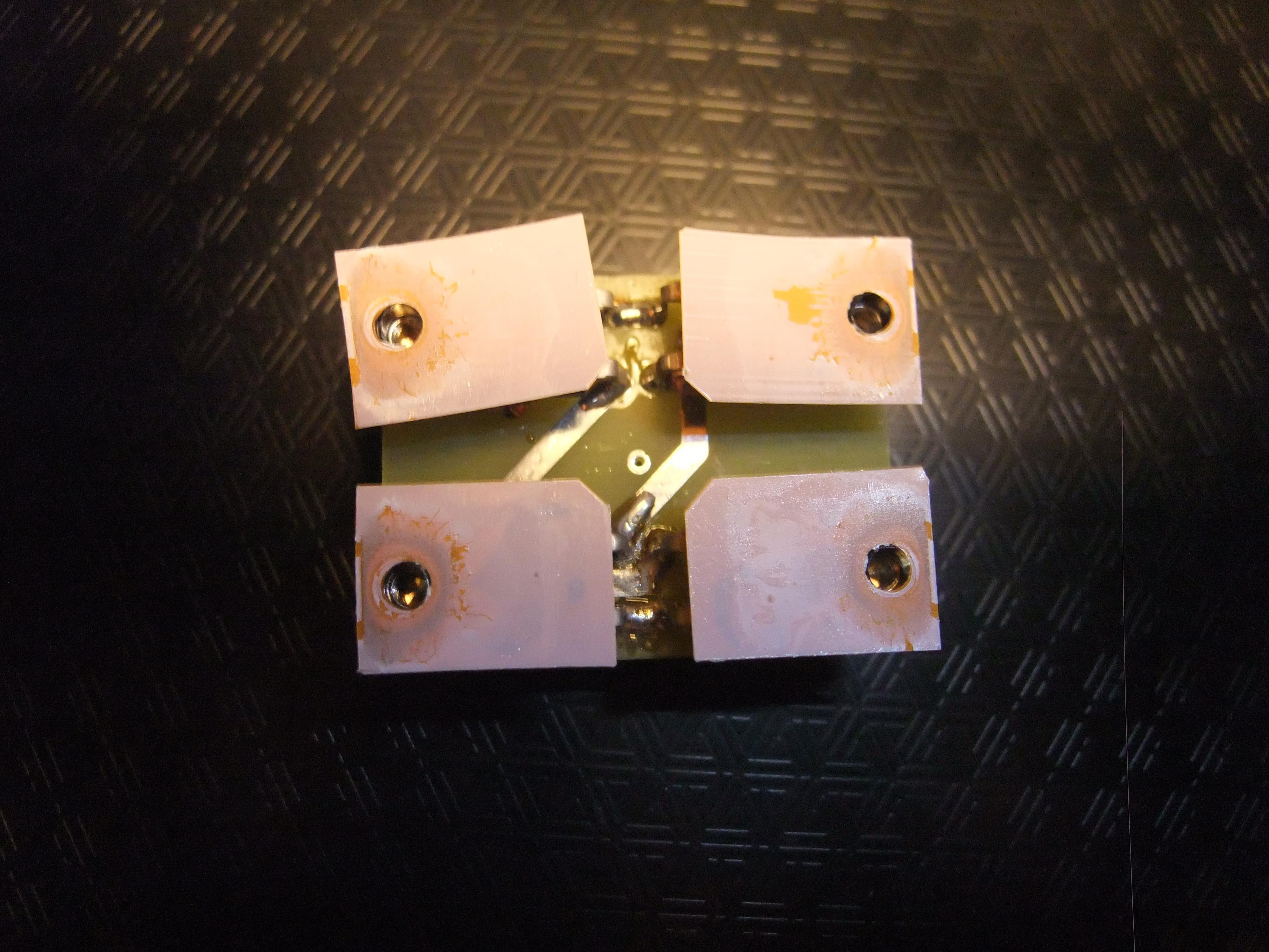

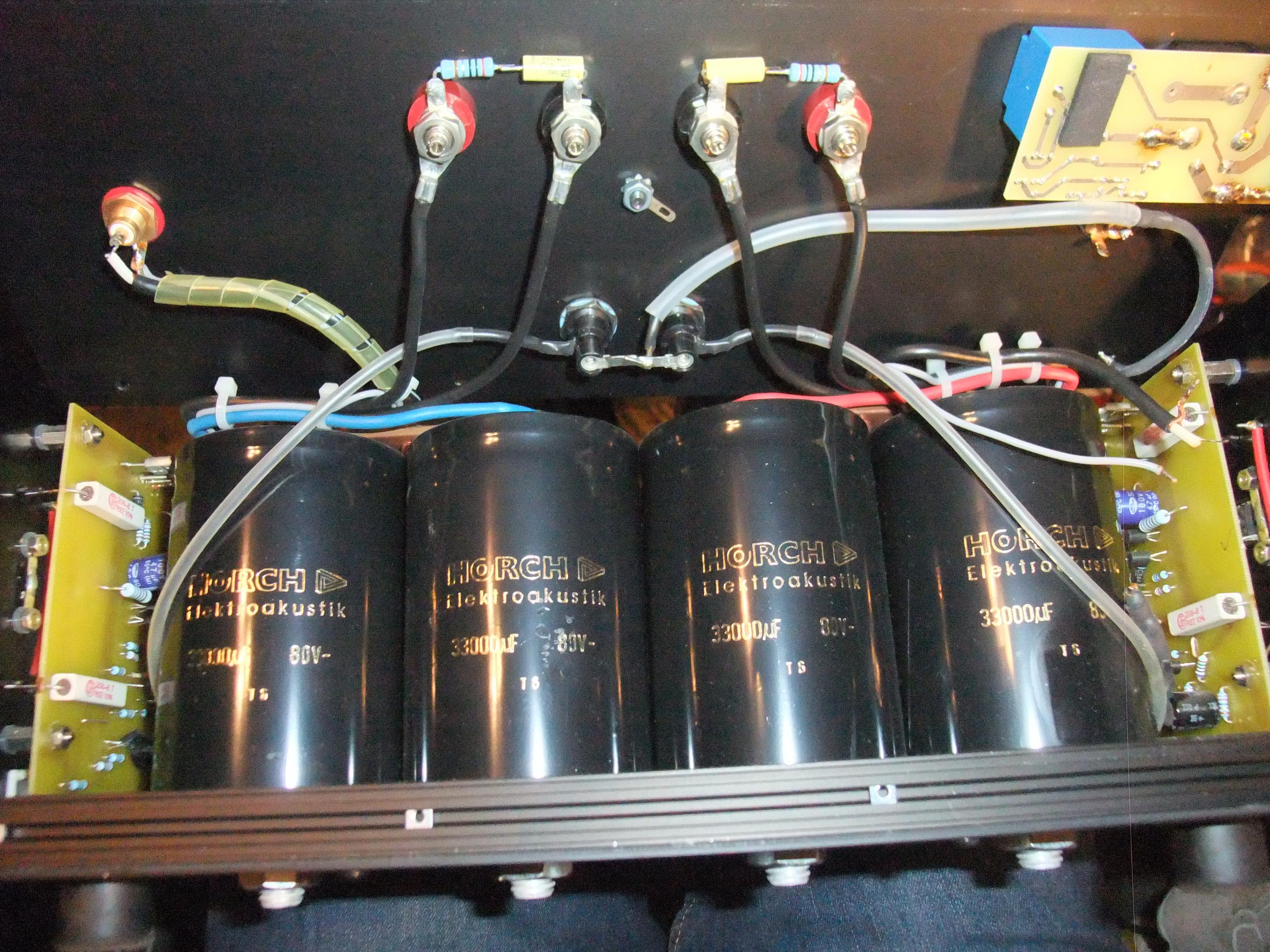

Maybe one diode is flawed - consequence was an extremely loud hum of one of both toroidal transformer (by measuring with diode tester no abnormalities are to observe - i. e. not shorted and no interruption).
The used capacitors are big cans with 33.000uF and 80VDC from FT cap.
Unfortunately the type designation of all diodes from TO220 surface was removed by grinding - thus the question rises up, what should I use for the right replacement.
I filed the topic here because the same problem also occurred with the Threshold 4000 vintage power amplifier (the usual 50/60Hz rectifier - go to
https://pdf1.alldatasheet.com/datasheet-pdf/view/1099761/NJSEMI/MDA3502.html
where was also replaced the mentioned rectifier by four pieces of fast diodes in the TO220 outline - also without additional snubber parts) - type designation from TO220 surface was here also removed by grinding from the repair guys who made this modification at least 20 years ago.
I. e. I have here the same problem to choice the right replacement.
Therefore the question: what diodes should I prefer therefore and for high power amplifiers in general ?

500A peak current is necessary (50 Hz version in "3.0" = KBPC50) - check out post 16+31 underMUR860 is a often a favorite… need to make sure you dont exceed the diode voltage thought…

Such diodes are common in computer SMPS on the low voltage side, though 600V rated.
Choose the current rating needed, and you are through.
If it is on the 50 Hz line there is no need for fast diodes.

But what is in cases of Class AB power amplifiers with 2x30 mA quiescent/idle current, where the current flow fluctuates to the beat of the music, i.e. dynamic conditions are present (5-10A peak current) ?

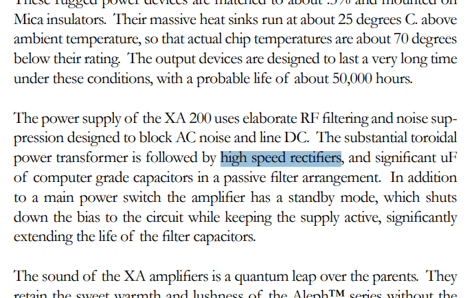

You might enjoy reading the owner's manual for the Pass Labs XA100 power amp. Their website makes it available for download, (here) . I mention this because the chief designer at Threshold became the chief designer at Pass Labs. Maybe the same thinking is applied to both Threshold amps and Pass Labs amps . . . . ??
A piece of page 14 is snipped out and presented below.

Good advice. Maybe an upgrade on X250 (in use by a friend) in this direction provide further sonic enhancement and is also a good choice for the Horch model from the headline.
Use UF instead of Schottky, the Schottky type do not work well at mains frequencies.
And much of the sharpness will be removed by the filter caps, which will do their job of damping the ripple.
good advice again. In a XA100.5 clone are 4 pcs. MUR3020WT in use so as a RC network (maybe a CRC network) - go to the images underYou might enjoy reading the owner's manual for the Pass Labs XA100 power amp. Their website makes it available for download, (here) . I mention this because the chief designer at Threshold became the chief designer at Pass Labs. Maybe the same thinking is applied to both Threshold amps and Pass Labs amps . . . . ??
