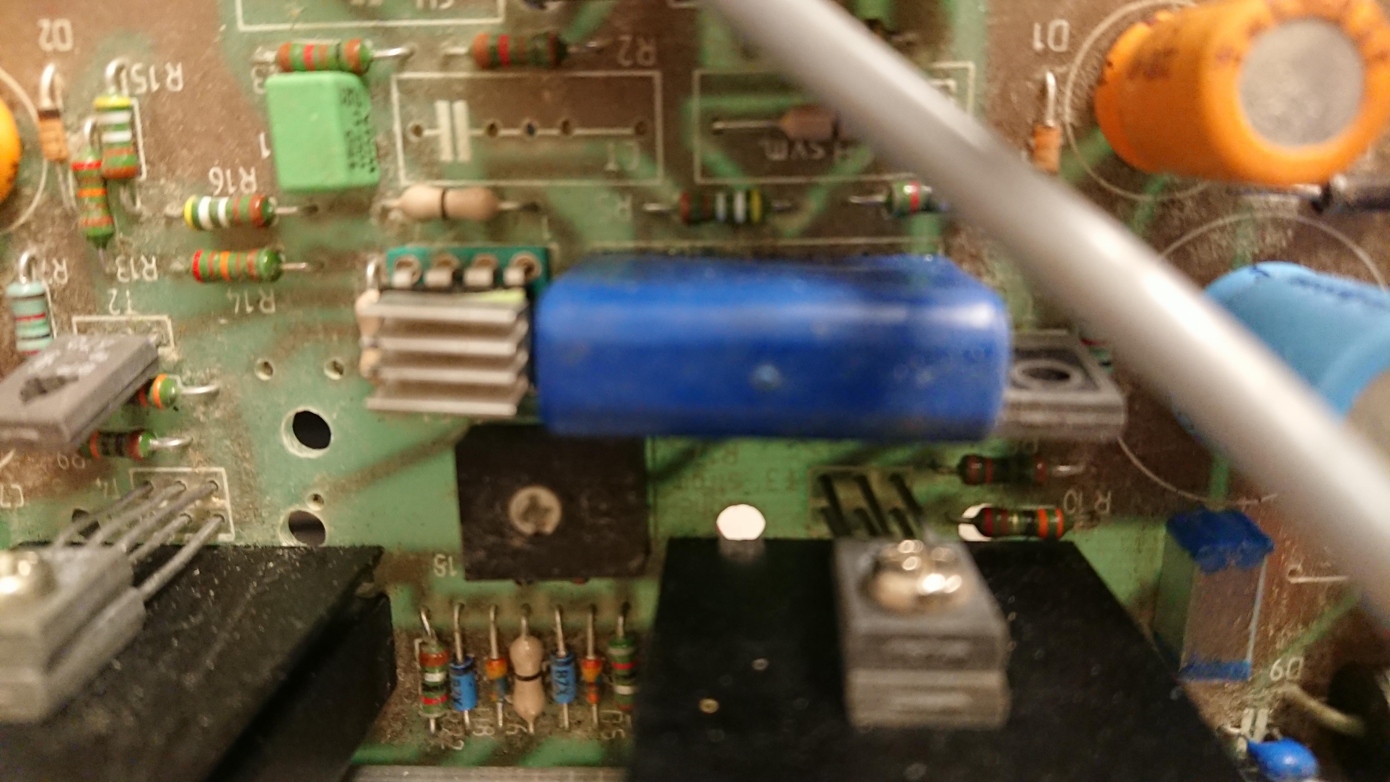

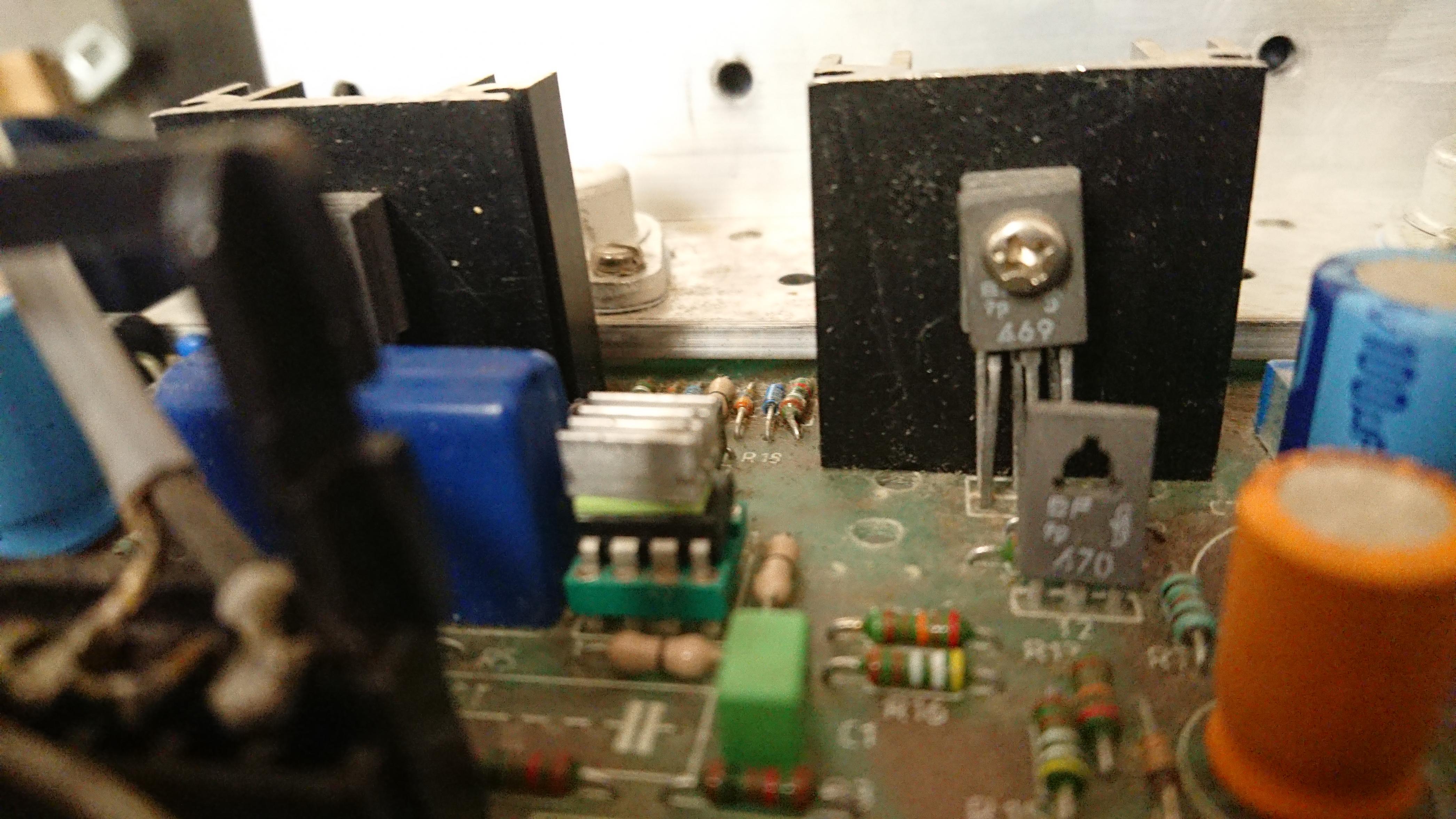

* There are in total more components on the board than I would have expected. Most interestingly an unknown DIP-8 IC and also a big blue component labeled "Modul 1" (please see attached images) that I cannot explain.
* There is a second trimpot (in addition to the bias trimpot) on the board labeled "power". Next to it are two solid pins labeled "HF" ... not sure what those are for.
* All of the above makes me wonder if the board maybe includes some sort of pre-amp stage .... but if so, why is there no volume or tone control?

The 'Modul' with all its pins could be a thick film module of some sort, perhaps containing the front end differential stages perhaps in an effort to ensure close thermal matching.
The opamp, if it is an opamp, could be a part of the driver circuitry but it is all guesswork.
It doesn't look like it comes from a normal piece of commercial HiFi gear, an instrument or stage amp perhaps.

Last night I managed to get the heat sink off one of the ICs. I scratched enough glue off to identify it as an OPA606.
I've also been reading up on the topic of dc servos (as I wasn't familiar with that concept until now - thanks @MarsBravo). After all I've read I think it's very likely that the OPAMP is part of such a dc servo.
Still no hint on the big blue component or the "HF"-pins though.

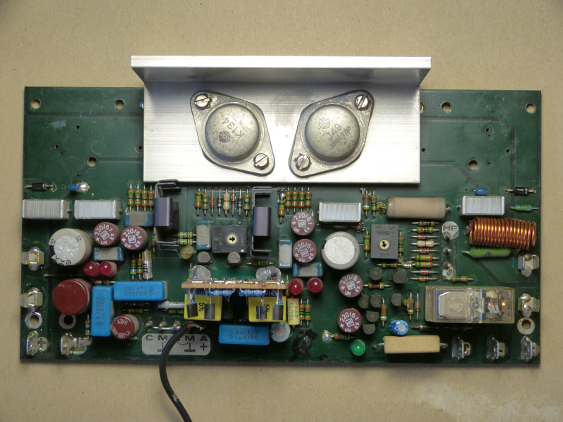

To me this amp looks very similar, though not identical to one that has been quite popular in Germany in the 80's. In this case "Modul1" is essentially a discrete differential amplifier covered with blue resin. Trim pot "power" permits to limit output to something in between 20% to 120%.
Hope this helps - Gerd

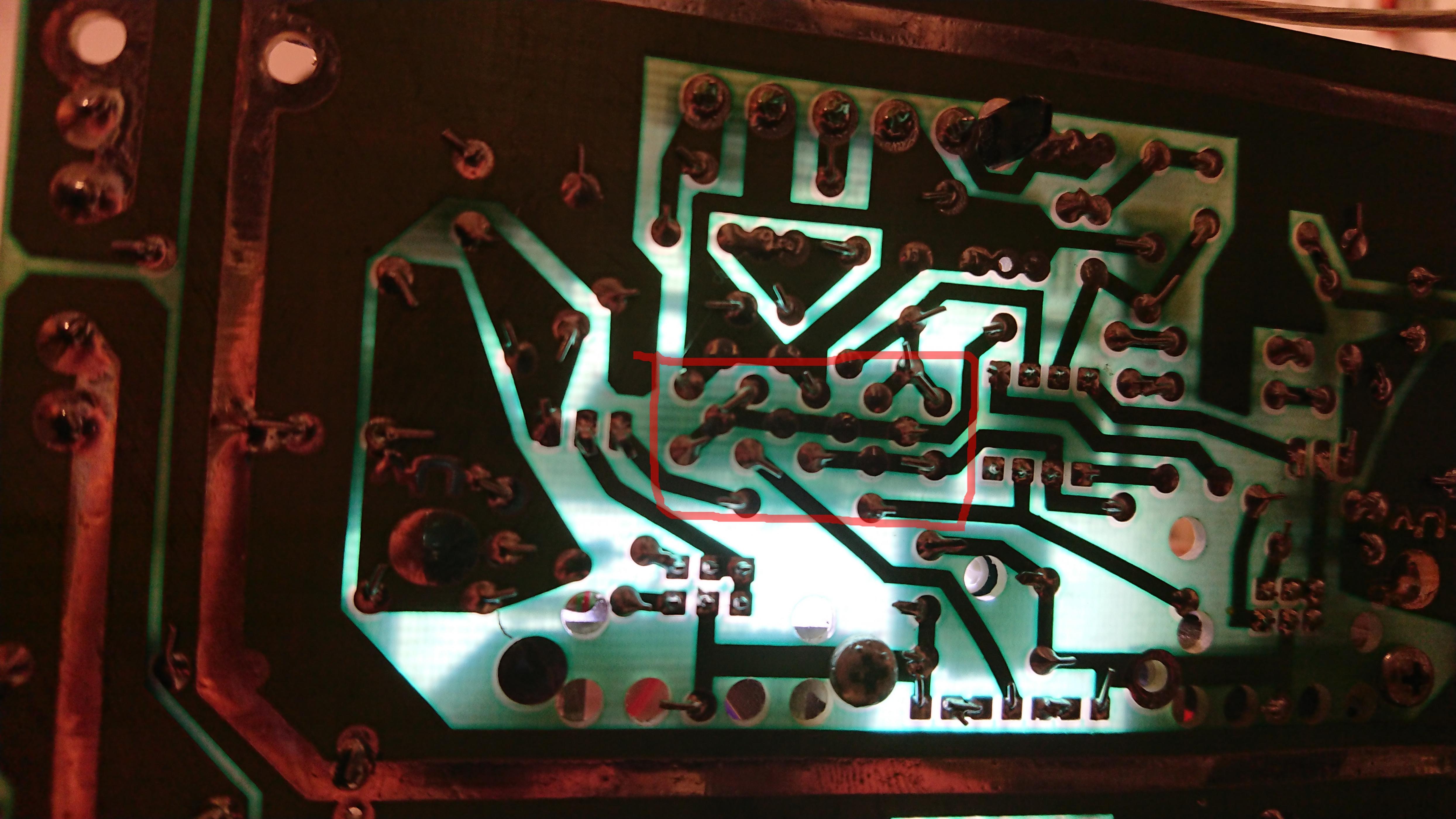

Indeed there are similarities on Gerd's amplifier board: more or less the same layout and three fet's in parallel possible. A variation. Is the blue part now the perpendicular board with discrete components?
#14 right picture shows the footprint of the blue part (5-4-5 pins config), suggests a similar encapsulated discrete board.
@ Gerd: Can you post pictures of this small board (comp & copper side)?
It might give us a good insight of the complete design.

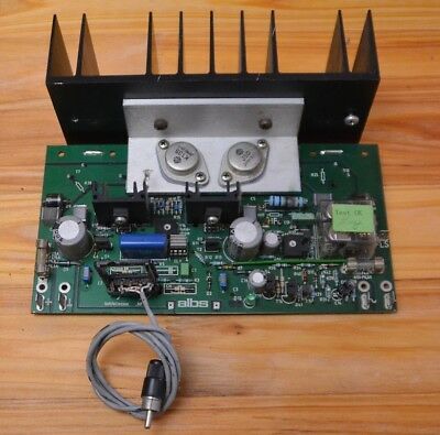

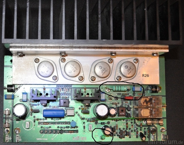

The lead regarding "ALBS MOS amp" seems promising. I did a search for that term and came along some images (unfortunately without any further explanation) of amps that also feature that mysterious blue component.
It seems like many variations and version of that amp have been put out over decades. I'll keep digging to see if I can find a closer match.
