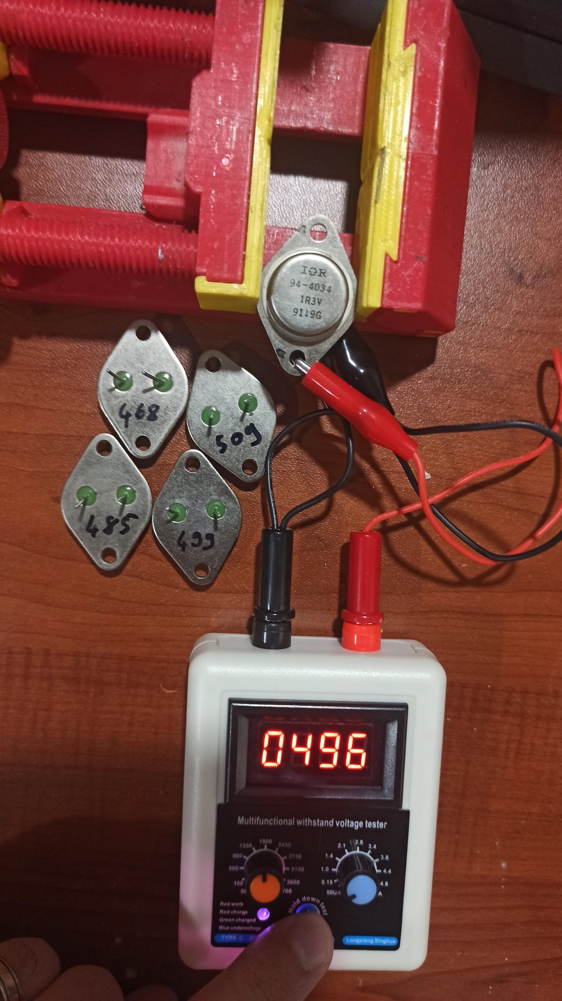

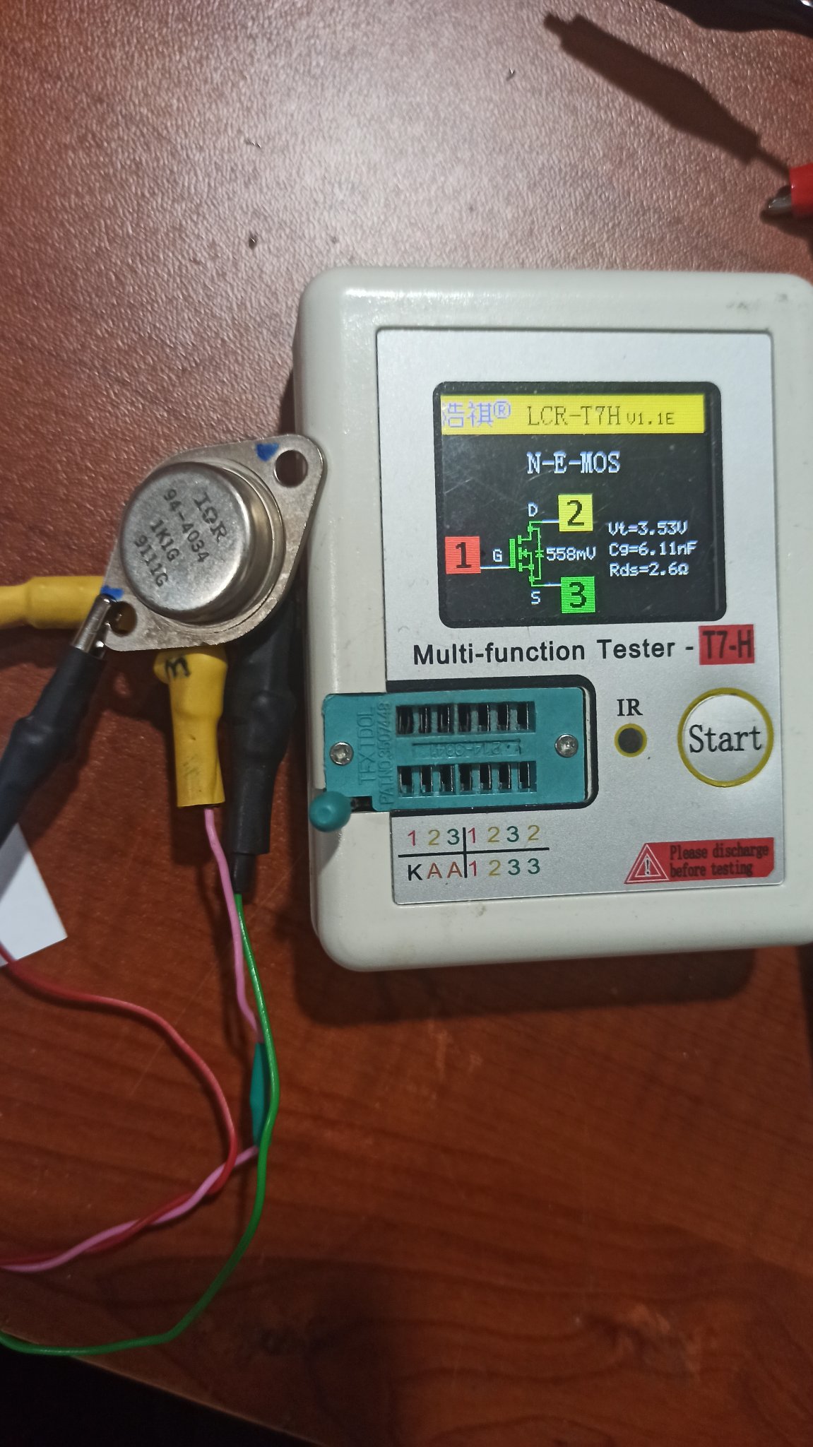

There is an auction on *bay with reasonable price for this part. Have you any idea about what is the actual part number for this mosfet? Seller claims that it is IRFP3710 equivalent but there is no such supporting info.
