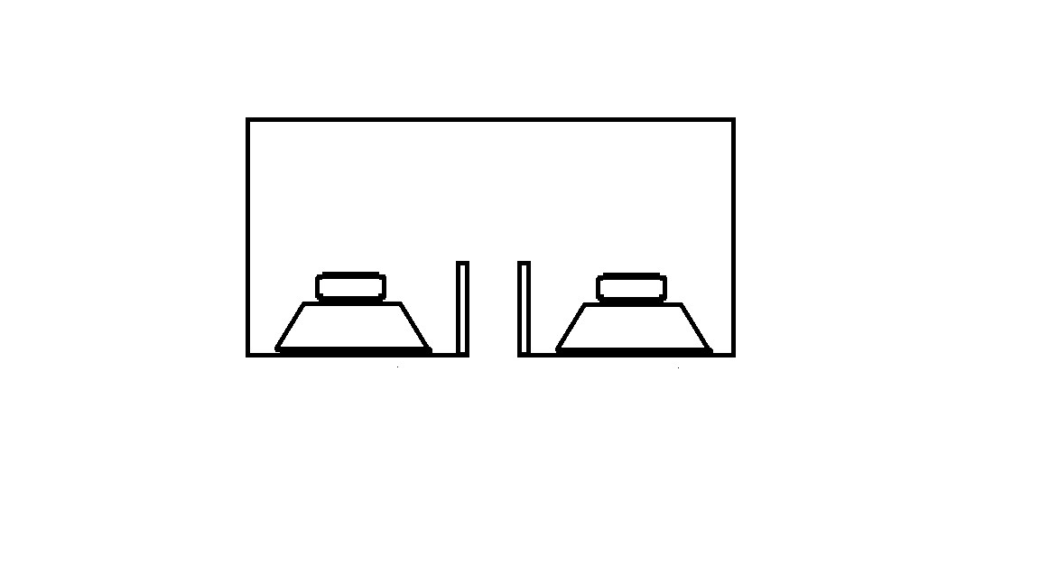

In my storage exist a couple of hand made bins twin 18" intented for sub woofer use
i can provide dimensions and or other data pics also
Then the problem is that i also have 4 brand new woofers that i know zilts about ...no data absolutely nothing

So the woofer is made from Soundking ....you may also find it somewhere as AUDIOMASTER or Metro Audio
Woofer is FA1841 G
As about the bin what troubles me is that it seems that both woofers share the same place and have a common port in the front
How can get the maxout of those ?

Ok out of the blue manufacturer replied and so we have
18 inches
600 W
4 R
96db1W/1M
35Hz -2Khz
Voice coil 4 inches
FS 41hz
qts 0.4
vas 155 liters
