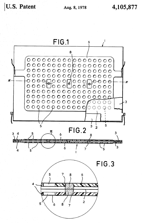

I always wondered what ESL panels were pictured in Ben Peter's patent for the silicon dot suspension.
Very Cool! Thanks for sharing these pics.
i talked about these elements allot 8 years back 🙂 when i noted the efficiency no one believed me 🙂
so this is where the silicone dot came from 🙂 cool nice to know. my version did no0t ahve them yet. rest of the panels are identical
