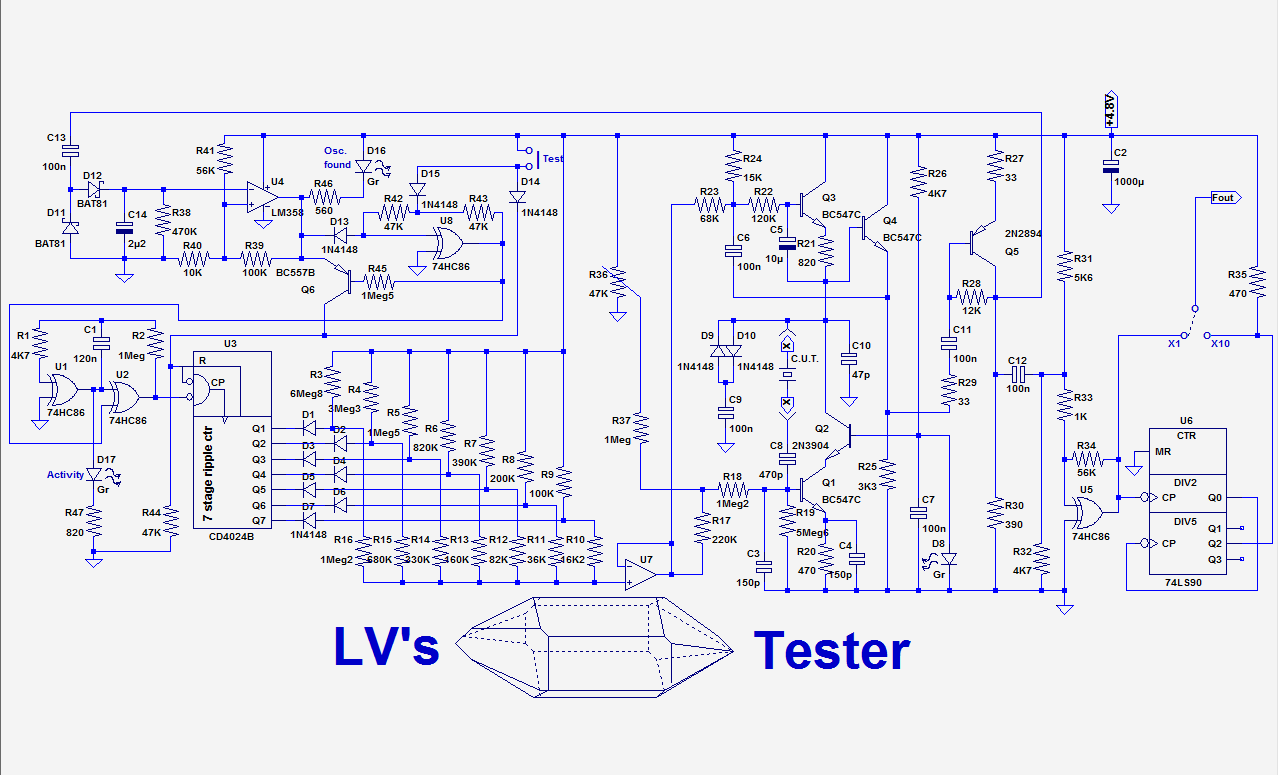

In the end, I (reluctantly) opted for a Pierce type oscillator, with carefully chosen components and additional tricks, like cascoding, variable transconductance and gyrator load:

The left side of the schematic (CD4024, etc.) probably looks strange and unexpected for such a circuit.
In fact, given the possible range of frequency and parameters, including parasitics like input sockets and possible test leads, a fixed-conditions oscillator is not possible: the level of impedances, transconductance needs to be made variable.
The logical way to do that would be to include a servo, to control the main bias current and the resulting parameters, impedance and transconductance.
That's normally what is done in good quality oscillators of various types.
Unfortunately, this well-proven approach is not usable here: when no crystal (or a faulty one) is inserted, the servo will be stuck to its maximum, because it tries to cause an oscillation when none is possible.
As soon as you insert a crystal, the first and most obvious resonance will be found, and if it is a low-frequency crystal, having a frequency of a few kHz or tens of kHz and a series resistance of tens of kiloohms, this will be the quartz capacitance + series connection wiring, in the VHF range.
The servo will lock onto that spurious resonance, and stay there because there is no reason to go elsewhere.
Ideally, when nothing is inserted, the servo should be clamped to its low limit, and only released when something is inserted, but the method is not 100% safe, as the servo might need to overshoot before it stabilizes, with the risk of skipping the first, lowest resonance, which is in principle the intended target.
Thus, instead of a servo, I opted for a start/stop system: when the DUT is ready to be tested, the test is initiated (beginning with the low end of bias), and stops as soon as an oscillation is detected.
This method is much more reliable.
The CD4024 in conjunction with a special D/A converter generates the scanning ramp and holds it when an oscillation is found.

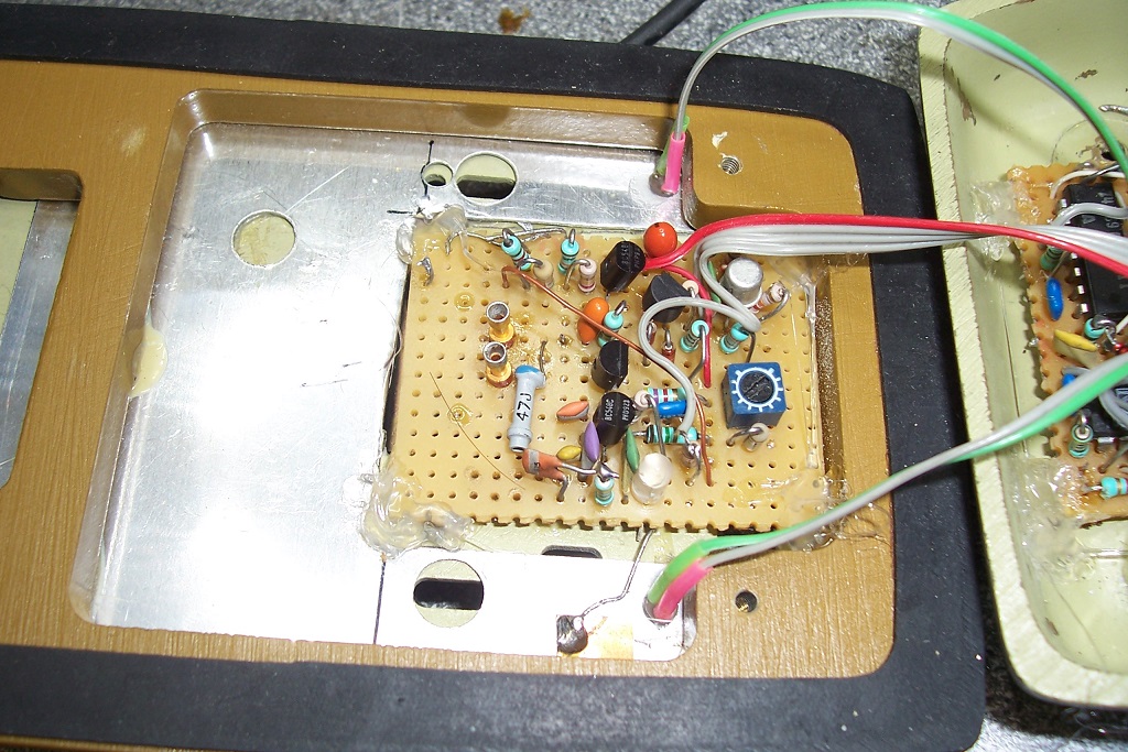

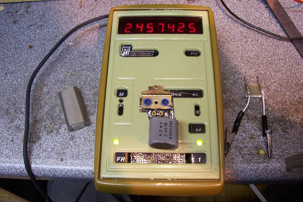

I will explain the curious details later, in the mean time, here are some pics of my build: I have grafted my tester into an old, worthless frequency-meter, for convenience:
attachment.php

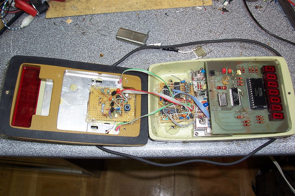

On the left is the oscillator part, on the right the control circuit. I have kept a part of the original frequency-meter board, to support the existing switches, and hacked off the rest.
The oscillator board:
attachment.php

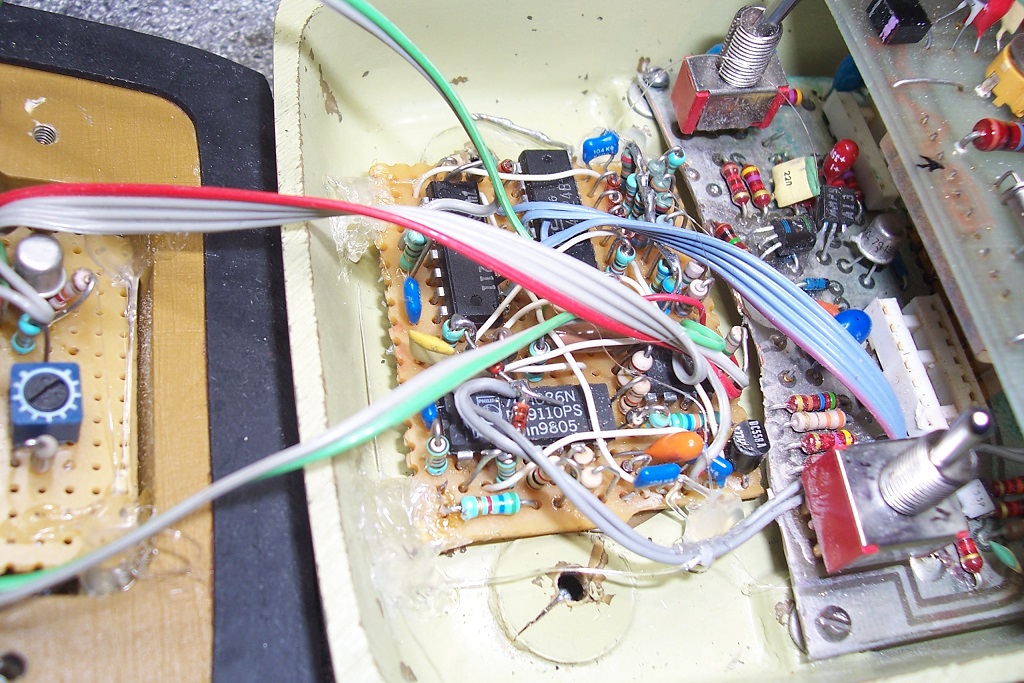

The control board:
attachment.php

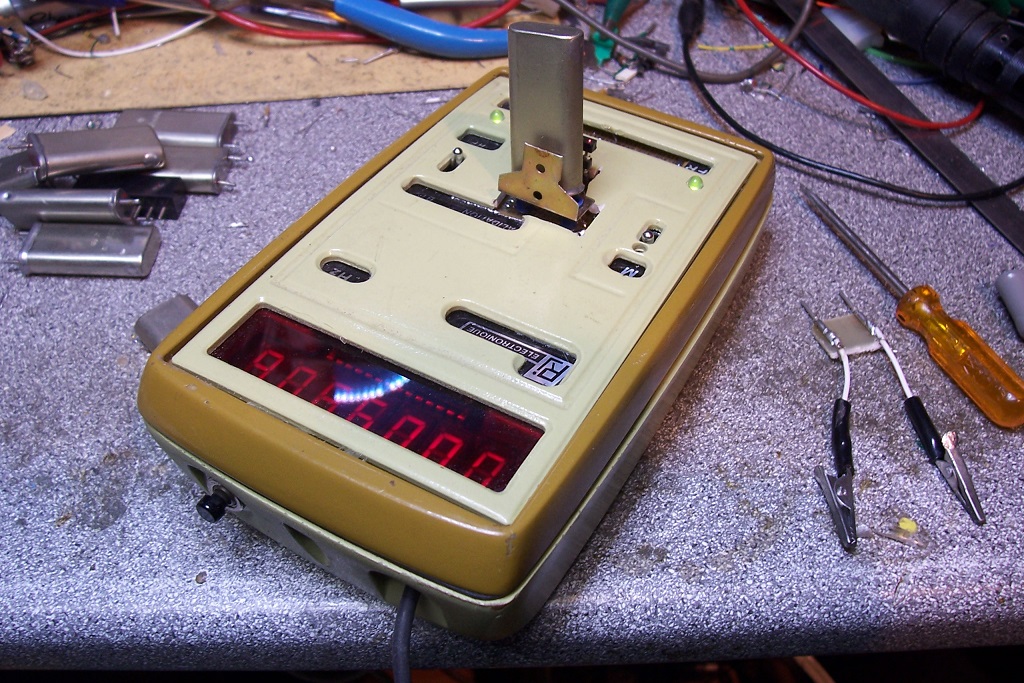

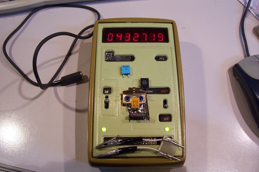

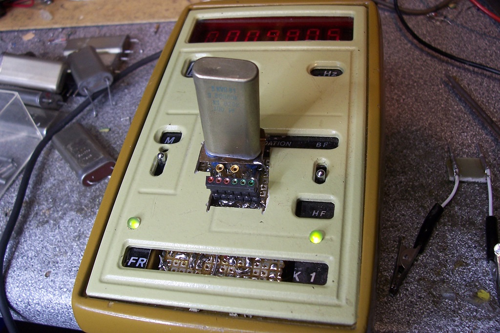

The instrument in action:
attachment.php
attachment.php

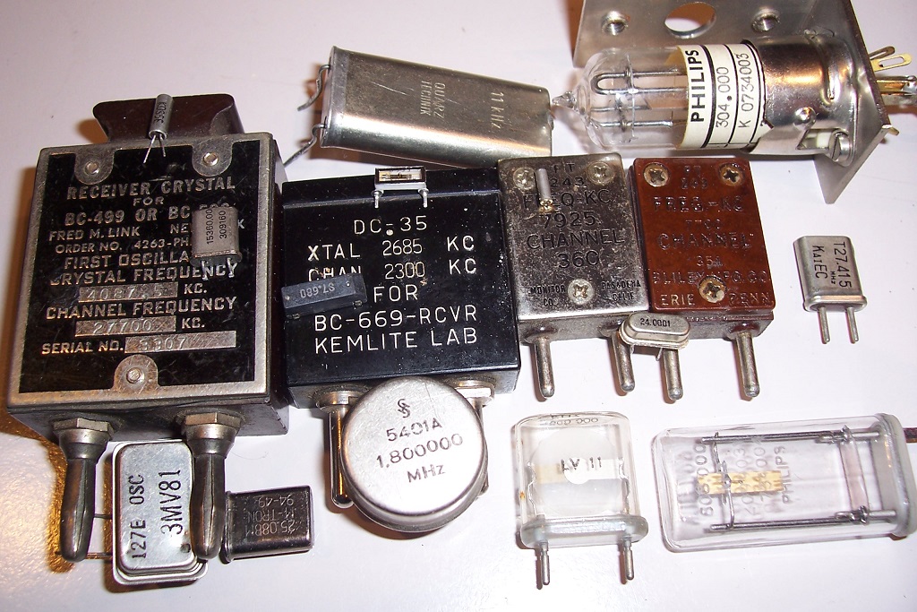

A small selection of testable samples, big and small:
attachment.php

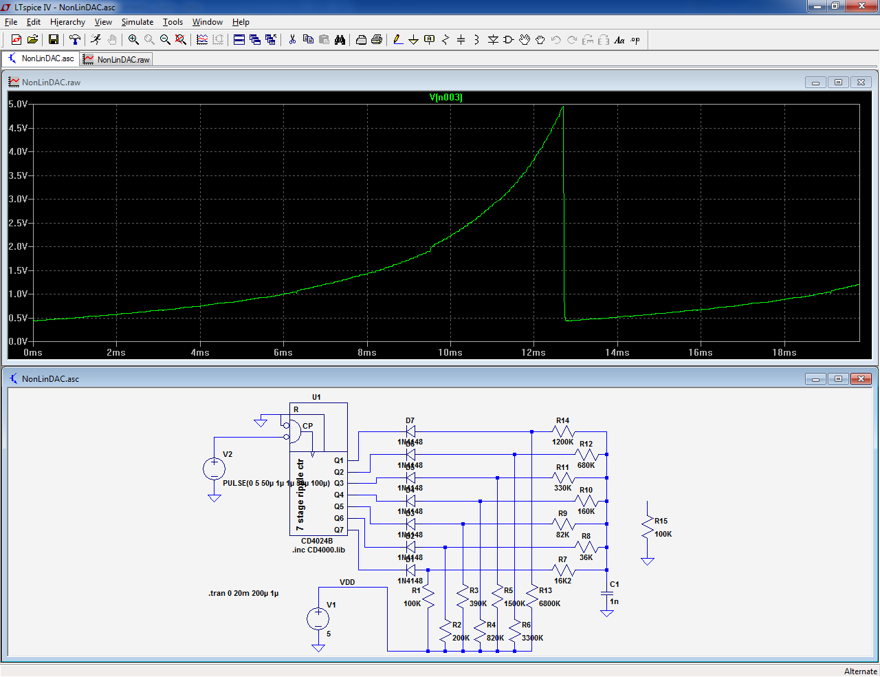

The core of the tester is built around Q1, the oscillator's active element.
The oscillator is of the Pierce variety, but to maximize the possible range of operation, the transistor has been cascoded, and its collector load is a gyrator, because no single choke can be good for a range of 5kHz to 50MHz.
The bias current is made variable, allowing the control of the key parameters of the oscillator, its transconductance, of course, but also the general impedance level.
This is very important, because low-frequency crystals have very high impedance levels, and operate under unfavorable conditions: the capacitors C3 and C10 are a tradeoff, but at the frequency extremes, they become seriously marginal.
The gyrator also benefits from variable bias, for the same reason.
The bias is generated by a particular, non-linear DAC: its transfer function is exponential.
This is necessary to keep a good resolution at low bias levels: a variation from 100mV to 200mV above the Vbe level is as is important as a variation from 1V to 2V.
It is in fact what AD names a "LOGDAC", but where AD uses brute force with a massive addition of bits, I use simpler, analog method.
The result is an exponential range, from 1 Vbe to Vdd, exactly what is required:
attachment.php
The transfer function isn't very clean, because most resistor's values are rounded to the E24 series, but it is perfectly sufficient for the task at hand.

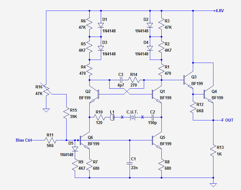

For those curious about the previous version, based on an ECO (Emitter Coupled Oscillator), here it is:
attachment.php
I find it intellectually more satisfying than the current version, but unfortunately, it cannot cope well with "dead" capacitance across the Xtal terminals.
C3 compensates for the fixtures and test connectors, but cannot be made much larger without dumbing down the VHF capabilities.
This oscillator uses the same bias generator as the other one.
One important point: even if the frequency-meter is perfectly calibrated, the displayed frequency can be somewhat different from what the crystal is supposed to deliver.
The tester has no way to know in which oscillator the crystal was to be used, and the mode, load capacitance, etc. will generally be quite different.
In general, VHF crystals will be overloaded and read low, and for VLF crystals, the situation will generally be reversed, but not for very small, watch crystals for which the capacitance will also be higher than normal.
Also to keep in mind: overtones crystal will always oscillate at their fundamental, which will be 3 or 5 times lower than what is printed on the case.
One last thing: it probably goes without saying (but being totally explicit is even better) the tester will force anything that resembles (or is) a series tuned circuit into oscillation.
That includes actual L-C resonant circuits, transmission line resonators, and all of the electromechanical resonators, like piezo resonators:
