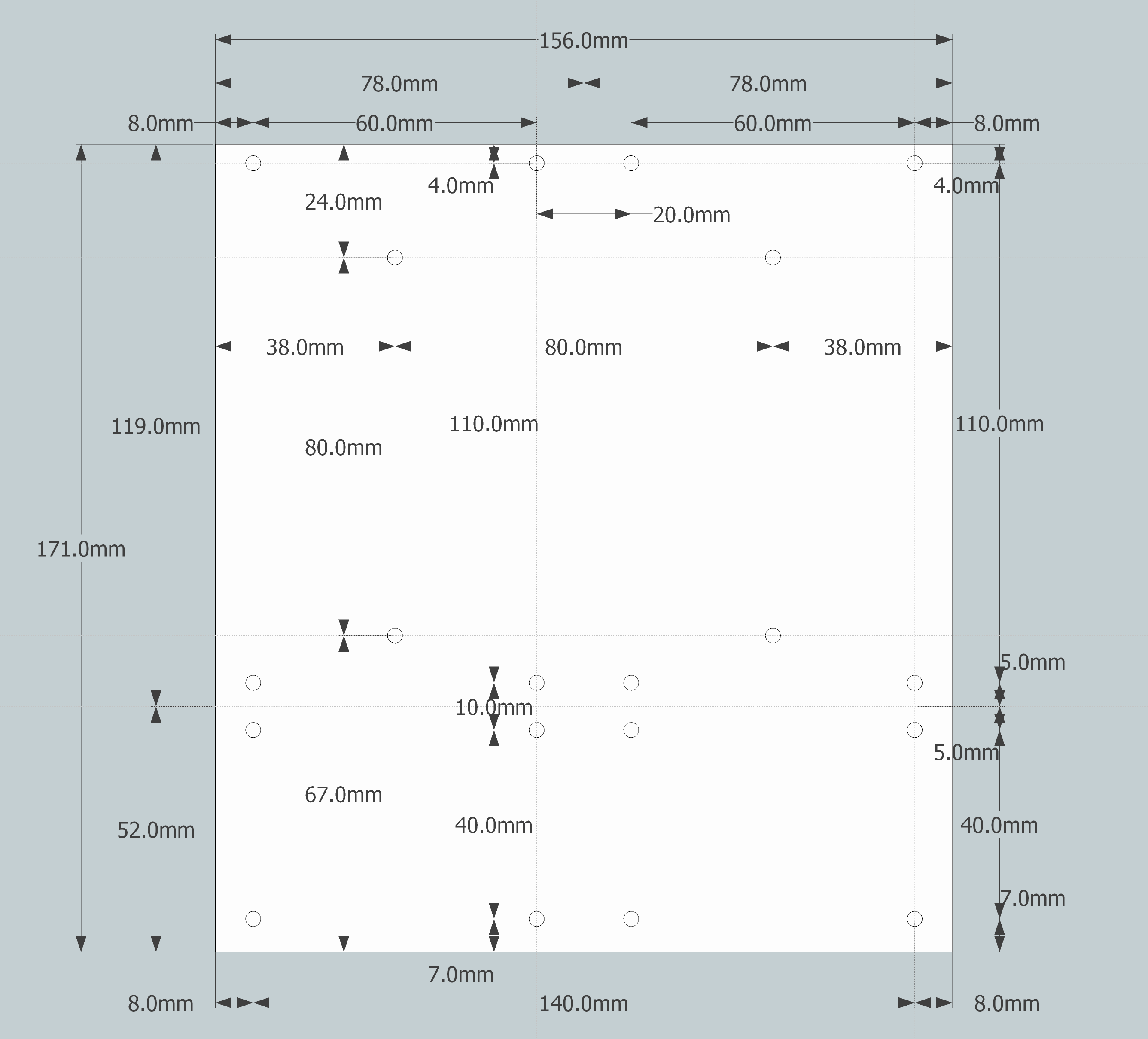

Now that the boards are going (or being) into production could we kindly have some more details concerning mounting specs of the board?
Thing is I'd like to start building and would like to be able to plan the implemantation of the boards before receiving them.
We'll publish a full physical diagram shortly.
The cap board has four holes in the middle in an 80x80 square, which allows it to be attached to the back of the new Deluxe chassis front panels as a single or dual PSU, or on the perforated base, or on risers either attached to the base, or perpendicular to the front, or flush with the front, mounted up or sideways or... hard to explain but we'll have diagrams galore when I get a moment to make them.
All other holes on the cap and diode section are on the new 10x10 grid pattern, so again you can attach them to the base, front or risers and spun around in any orientation.
Full mounting specs coming soon...

I pre ordered several Universal Power Supply Boards and am trying to collect and order my parts. I was planning on using TO247 diodes with heatsinks. The board has an outline of a heastsink. Is there a part number or designation for a heatsink that fits the board.
Thanks.
dante
Check the UMS - http://www.diyaudio.com/forums/imag...sal/universal-mounting-specification-v2.1.pdf
The only pre-drilled pre-tapped heatsinks we sell are the ones in the Deluxe Chassis:
Full width with 40mm Heatsinks - Chassis
- The diyAudio Store
- Universal PSU, Capacitor and Diode Combination Board (V2)
