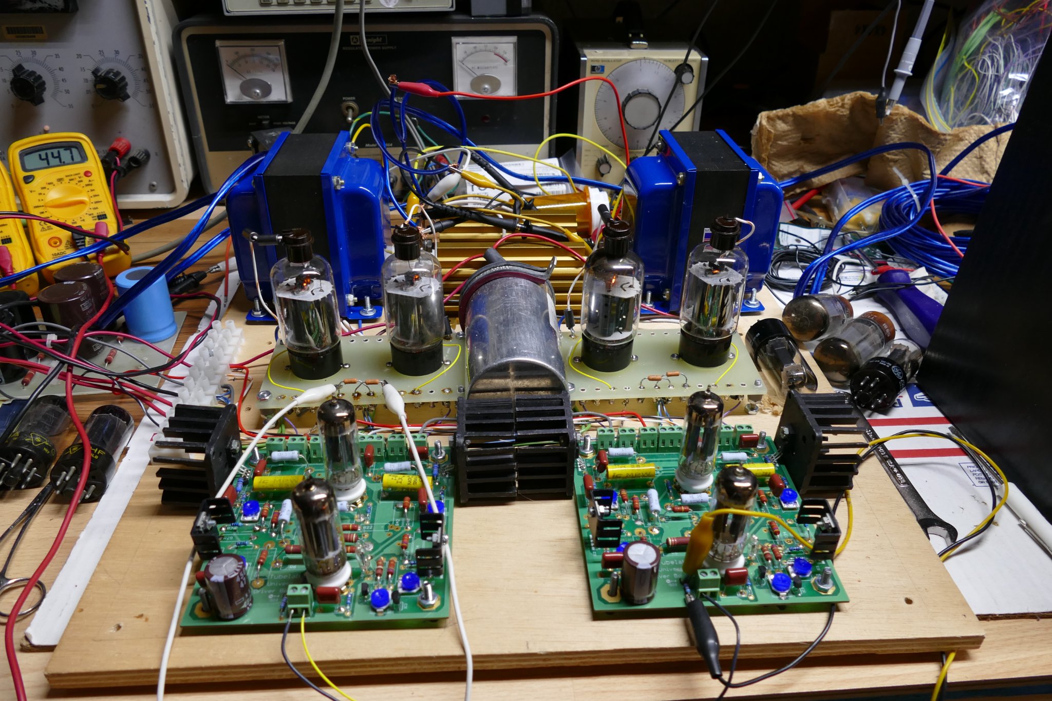

I have been contemplating the construction of "The BIG one" for some time. If I can get all the other stuff off the bench, I'll try the UDB + UNSET Octal Output Board combination. Once that is stable and working, it's only a matter of adding more UNSET output boards and building a power supply capable of feeding a 1KW tube amp.

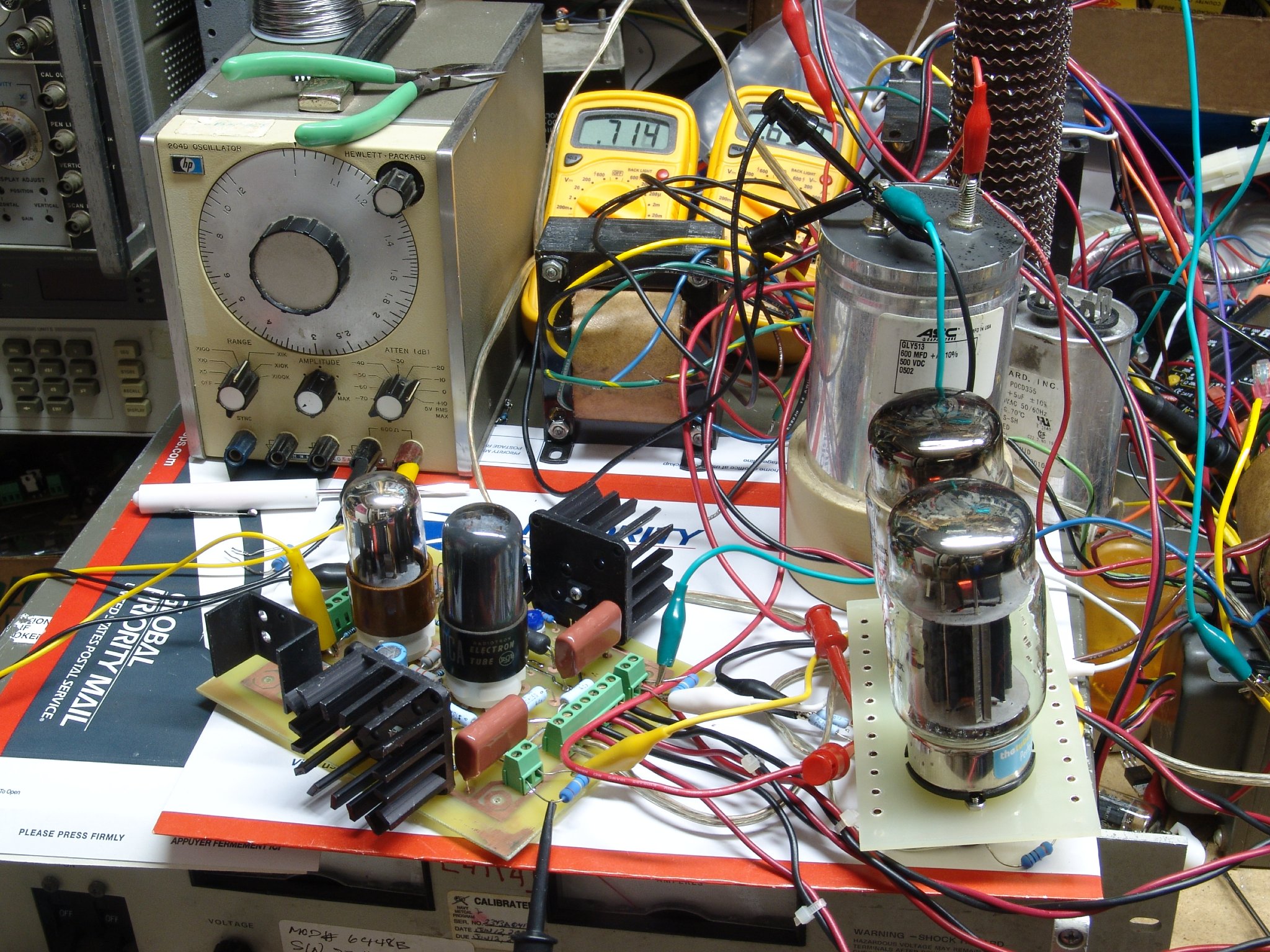

The test setup seen here in pictures #487 and 490 still exists but is being refitted with UNSET output boards for some high power amp experimentation. I have used this same pair of UDB's for several experiments with small (6V6GT, 6K6, 6W6) tubes and big sweeps like the 26HU5 and 6LW6. I'll create a parts list from these boards once I finish the PC build mess that has taken over the workbench.

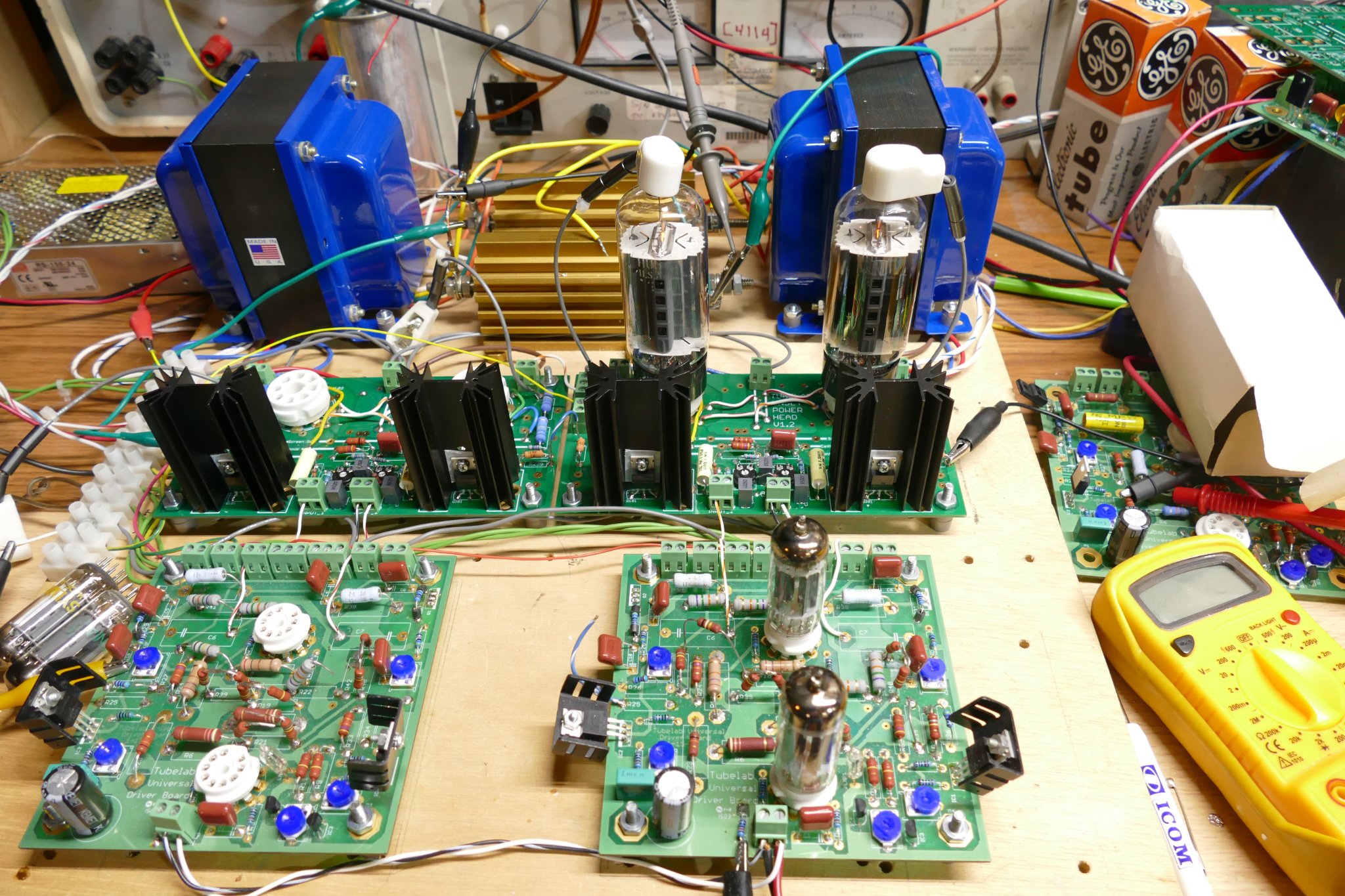

Driving an UNSET Power Head in PP works great, but you will need to leave some parts off the driver board build. The UDB has a mosfet follower for driving the grid of the output tubes and providing adjustable bias. The UNSET Power Head (UPH) board also has a mosfet follower to drive the cathode of the output tubes with its own bias adjustment. You don't need both, and the cathode must be driven in UNSET, so the mosfet follower and associated parts can be omitted on the UDB build.
I have the setup seen in the picture still on the bench. Some parts like the OPT's and one driver board have been removed for some serious high power testing (over 500 watts from 4 X 26HU5's). I should be able to put one channel back together pretty quickly. I have lots of 25DN6 tubes here which are similar and have the same pinout. I probably have some 6CD6's in storage too.
If you tell me how much B+ you plan to run, and your OPT impedance, I can mock this up pretty quickly.

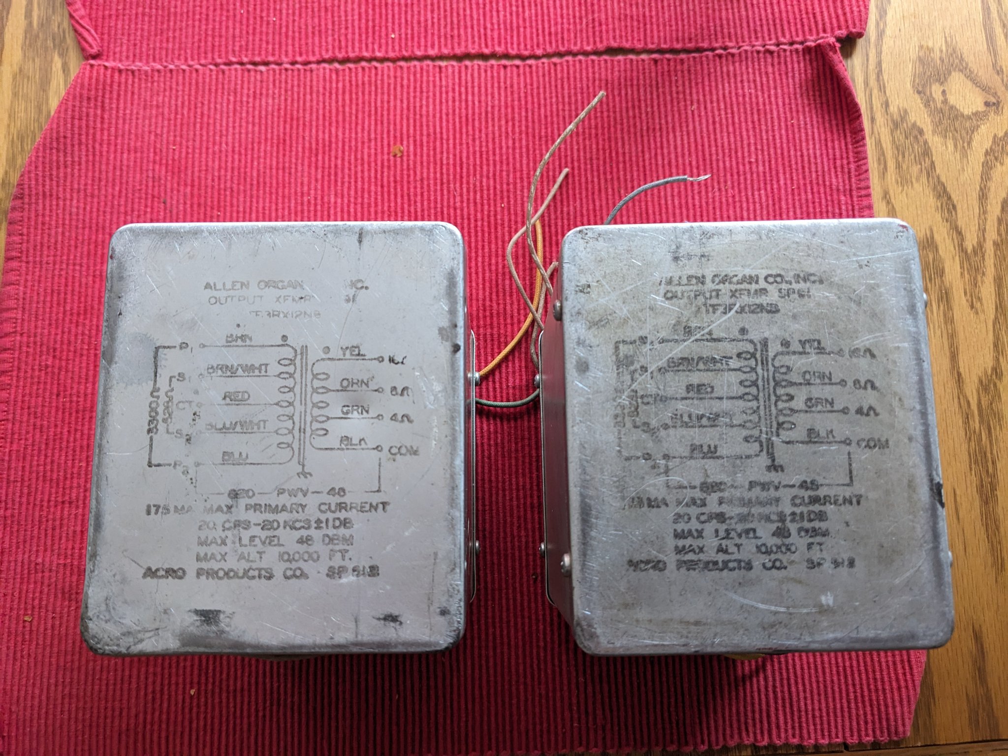

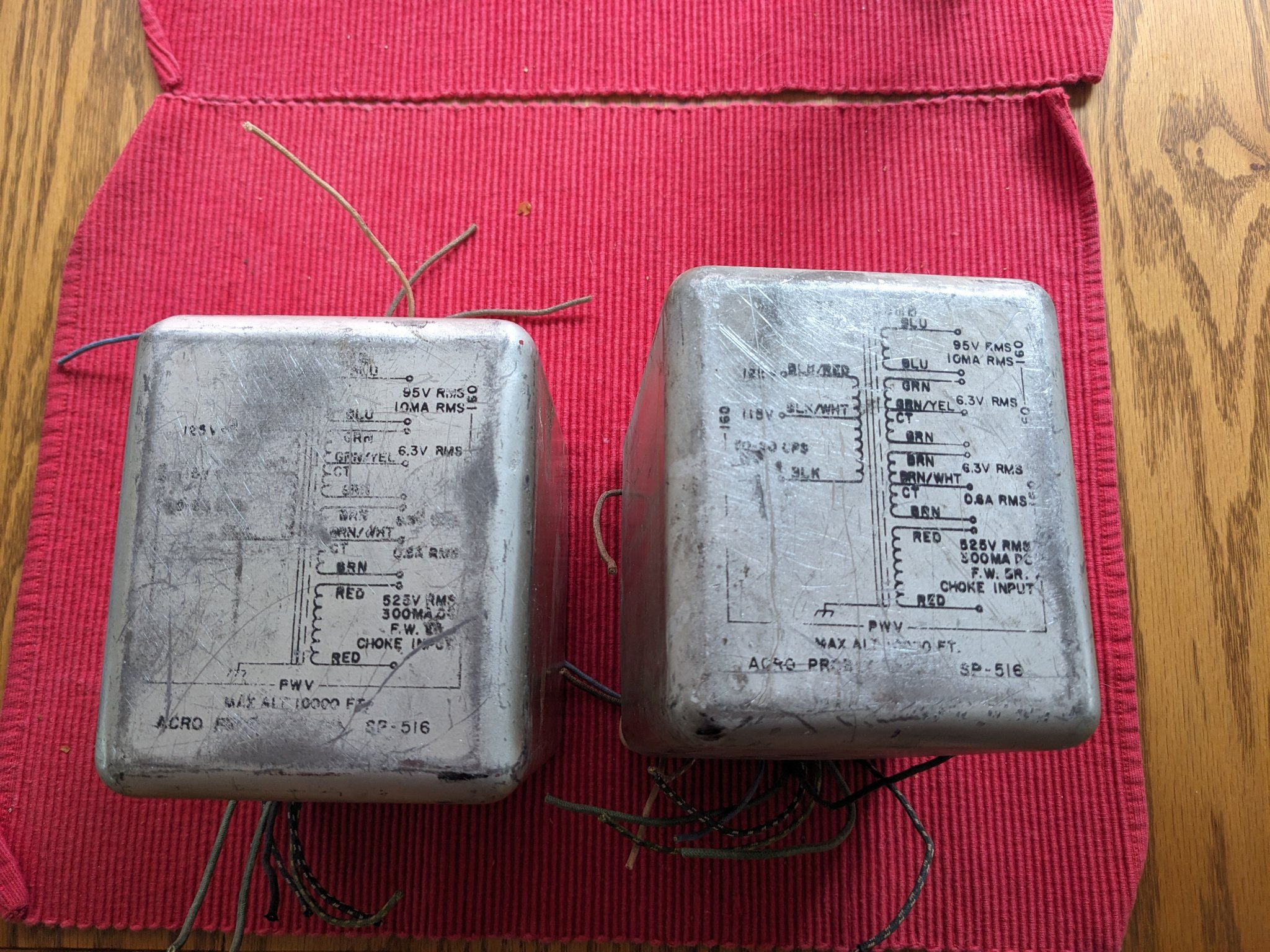

One of my potential plans is to use the iron set from Allen Organ 75s, which were 6550 amps with big Acro OPTs (3300ohm primaries, originally for 6550s).
The power supply for the original amps shows 455V, using the PTs into a SS full wave, choke input. But the primaries are 115V and 125V, and because my line tends to run 120ish or a little over, I'm thinking that an essentially the stock supply would put me around 475V (or a bit more, lighting fewer tubes), though potentially needing some caution on the filaments. I could buy new PTs, but it would seem a shame to split up the gang. (I have the chokes, too, though they aren't pictured.)

Yes, I did use 6550s as per the BOM with 150k R6/R7 and 24k R17/R18 with 500V HT.
It sounds like your transformers will be fine. The additional 5V of mains voltage is only ~4.5%. That'll only be an additional 0.3V on a 6.3V secondary.
