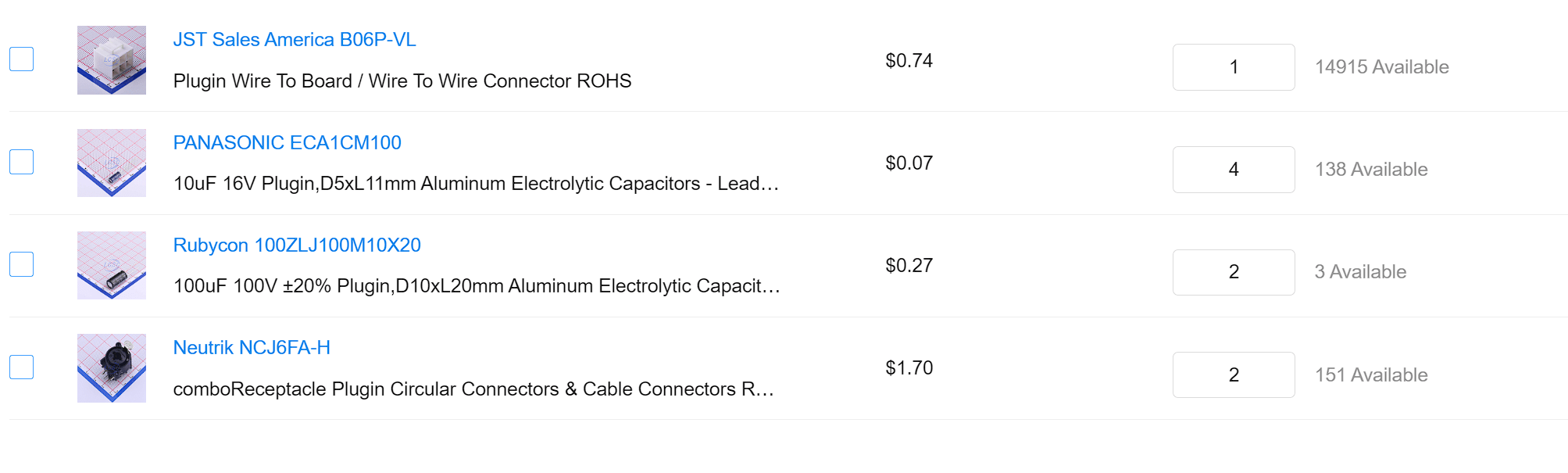

I'm trying to see if there is a way to buy the stuff from one place. Given that I need PCB from jlc. I searched their parts and found these:
I have 1K metal resistors at home. All the others I found some in DigiKey and Mouser. I guess is there a "simpler" way that I don't need to manage multiple orders?

I am trying the PCB assembly service from JLC. They ask for BOM and CPL files. I think I picked all parts from their library so that is done. For the CPL file, does the software generate these? I'm doing the no buffer stereo input board.
I just read it is a list with the center coordinates of each component. I do not have that.

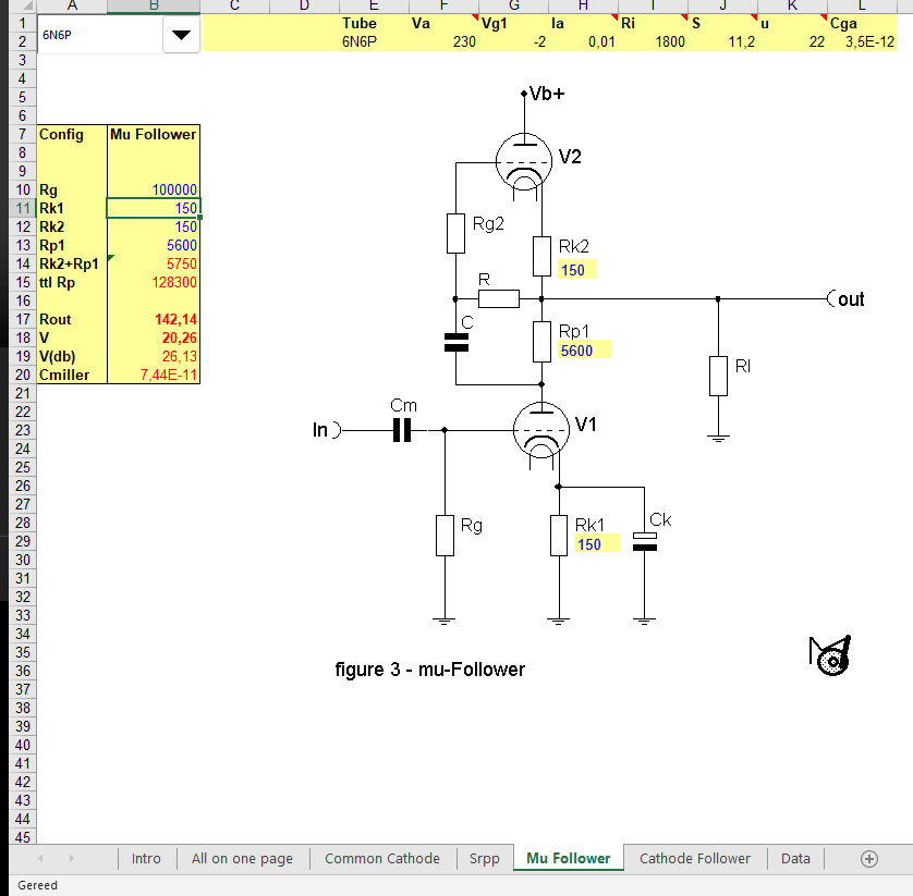

A buffer with at most 200Ω is unavoidable. Even a well regarded and popular preamp, Shiit Freya+ or Kara have 600Ω output impedance balanced, shouldn't even drive the Purifi load well at 4.4Ω (only 7:1 ratio).
You can build your own preamp with this,
https://www.diyaudio.com/community/...c85-6922-6dj8-etc-mu-follower-or-srpp.388295/

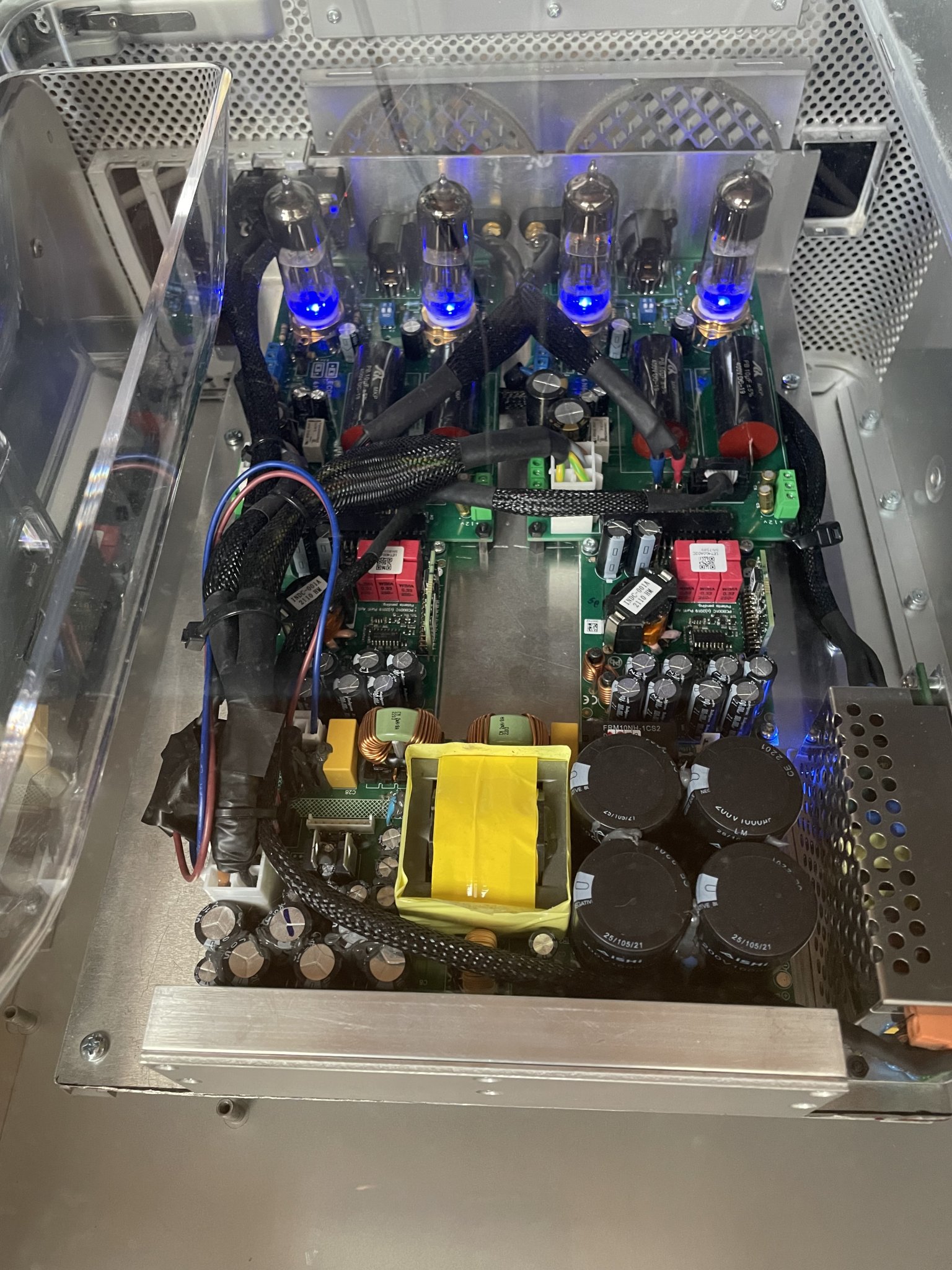

I would like your 1ET400A design to be compatible physically with Eval1 available casing, such as soundimports or ghent.
So far the only way is an open installation. It is difficult to make a custom case.
First get/build your optimal sounding amp. Then (let)build the housing.
Or as I and a view more people do. Build the power amp as just amp and powersupply in one housing.
And inputselect/volume control/preamp in an other housing.
