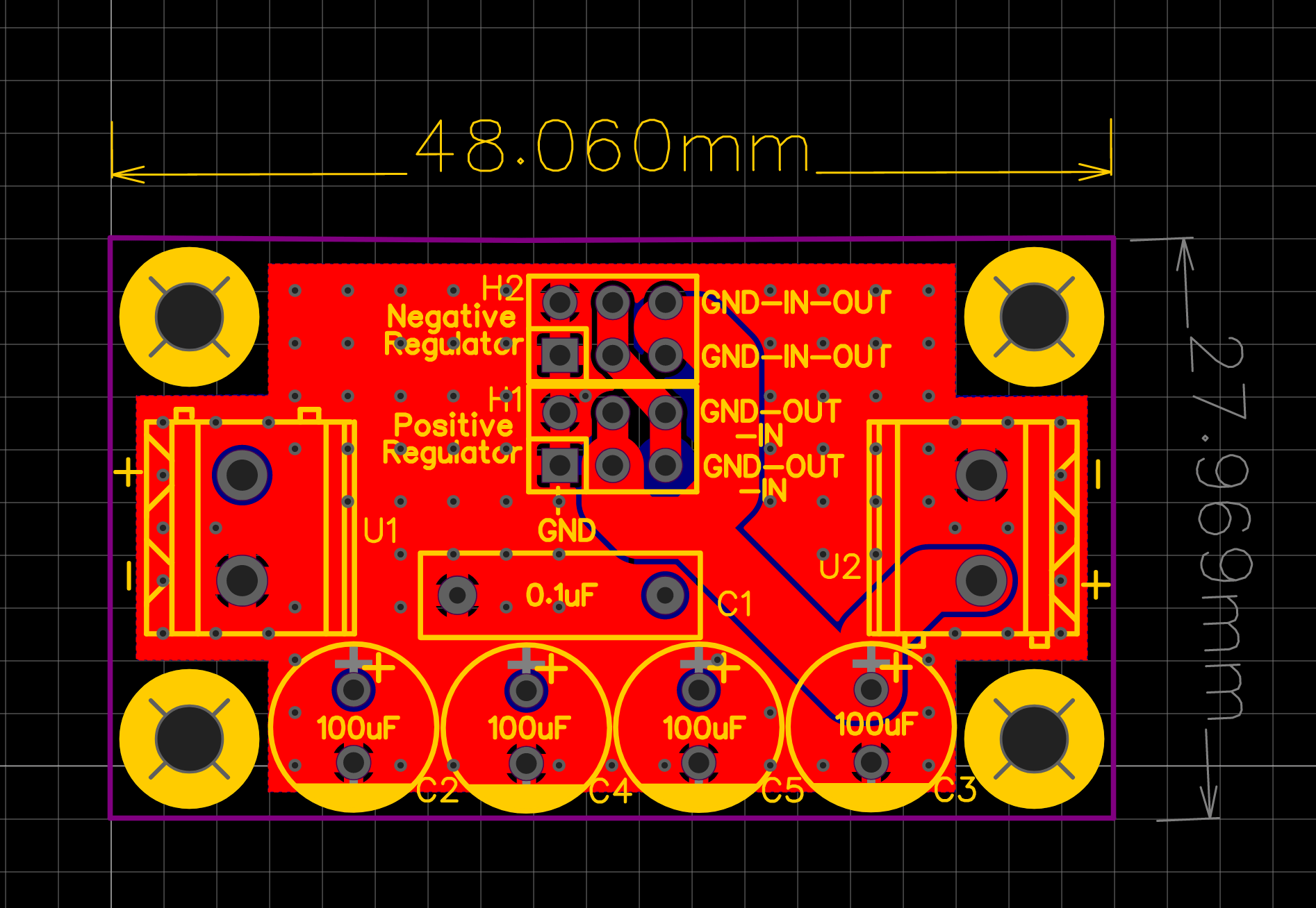

this is how it currently looks:
3 input caps + bypass, 1 output cap
caps are 100uF since they need rated to be rated for 50V if you wanna have some margin with 20-30V.. i will test 16V 470uF SEPC oscons in this position too since i mostly need under 10V
Also since its probably best to always have caps at the "destination" it makes sense to insert more input capacitance than output caps

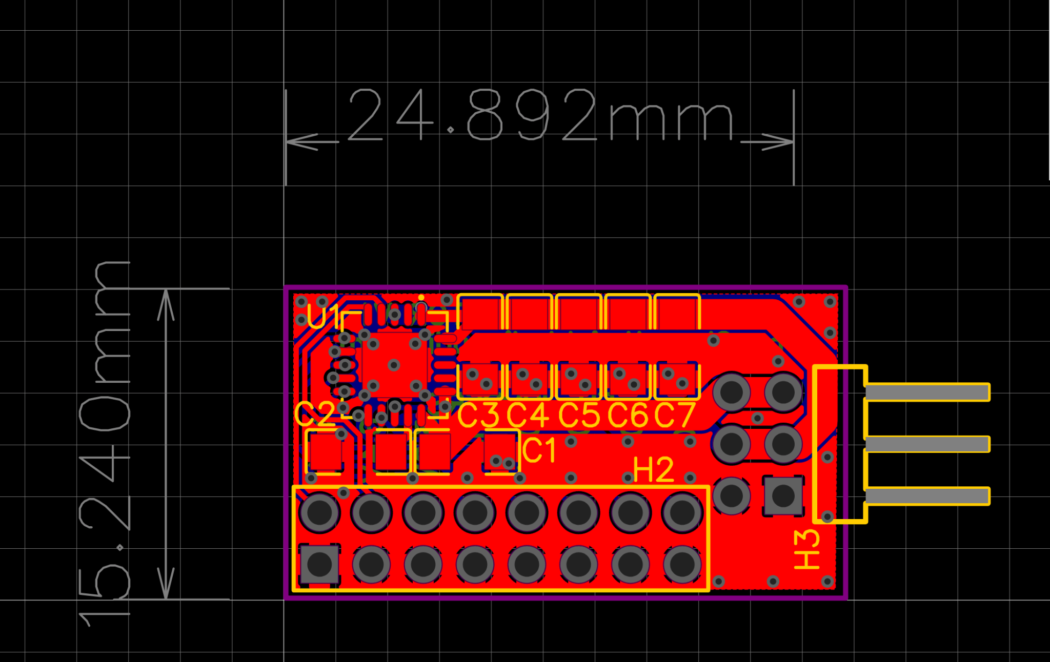

together with this goes this regulator:
(mind the 6pin pinheader instead of 3 pin.., sparkos and similar ones can be still used with no problem)
That's fine for your own use but not sure there'd be much interest from other members because:
Not easy to use a heatsink
No On board bridge rectifier and main smoothing cap,
For me, no CMC choke option.

if you wanna use heatsinked regulators you have to put them with the heatsink on the regulator dauther board, since the pinout now (GND/OUT/IN and GND/IN/OUT for negative regulator) isnt combatible with for example the LM317, its now purely a universal "baseplate" for some regulators...Not easy to use a heatsink
you can still put a heatsink on the regulator board, there is no point with this pinout to offer heatsink option on PCB
im still looking for a higher ampere regulator, so i might make one with heatsink in the future but as you see the baseplate is fairly small with not much clearance to the screw terminals... you got 24mm in between, sparkos should fit just fine
i made another board for this, i could make it a combine board but then i would still need this baseplate here to run regulators seperately, i find it kinda more appealing todo it in seperate boards, lets you easly exchange just part of the design, tho i agree a rectifier/smoothing/regulator board could be done too, i have to see, i just added a fuse and multiple wima capacitor footprints to the rectifier boardNo On board bridge rectifier and main smoothing cap,
like i said, as im unsure how it affects things i rather let it out and do it on a seperate board, so i dont have to redesign a "all in one" board 5 times, but just redesign the specific kinda "universal" board, is there something wrong with this aproach? i dont think cables between boards matter that muchFor me, no CMC choke option.
i mainly design these boards for myself, i just share them here to get ideas and maybe someone else is interested too 🙂That's fine for your own use but not sure there'd be much interest from other members because:
There's nothing wrong with what you have designed if it works for you but for under £5 and a 3week wait, you can get one of the ebay ones.
Th cmc choke option is for when a wallwart smps is used as the raw DC supply otherwise not needed.
I appeciate it's good to design your own pcbs - I've done many covering a wide range of devices but if I was to make one which I thought might appeal to others, I'd give it features not found in other similar products. If I used SMD devices I'd use the LT3042 (0.8uv RMS noise, 79db PSRR)

i just choose the TPS regulator for now since they are available for cheap at lcsc.com (the supplier of jlcpcb) and are close with 4uV noise and offer 1A instead of 200/500mA, the LT3042 and LT3045 seem a bit pricier and not as available

ah i ask because the datasheet states this:
"Regulator output. A capacitor greater than or equal to 10 μF must be tied from this pin to
ground to assure stability. A 47-μF ceramic output capacitor is highly recommended to be
OUT 1, 20 O connected from OUT to GND (as close to the device as possible) to maximize ac
performance"
