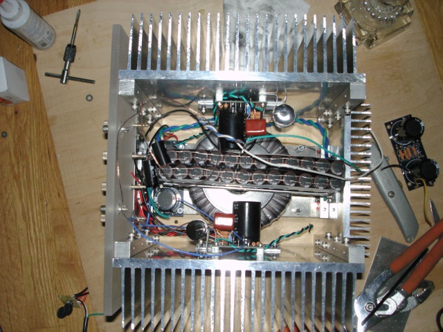

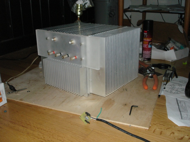

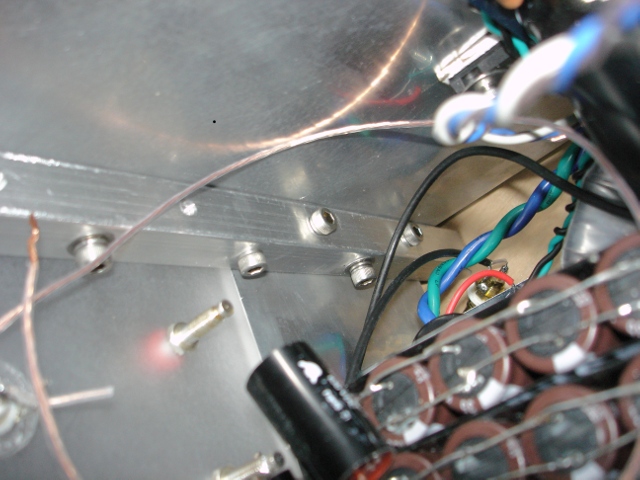

I think the chassis is easy! just bolt bars to the corners of your heatsinks, bolt a front and back and top and bottom to those bars.. 4 sheets, 2 heatsinks, 4 bars, some drilling and taping..
My last one practically built itself while I was sleeping.
I just attached a couple of pictures.. It's not quite finished. I'm wiring it all up this evening.
