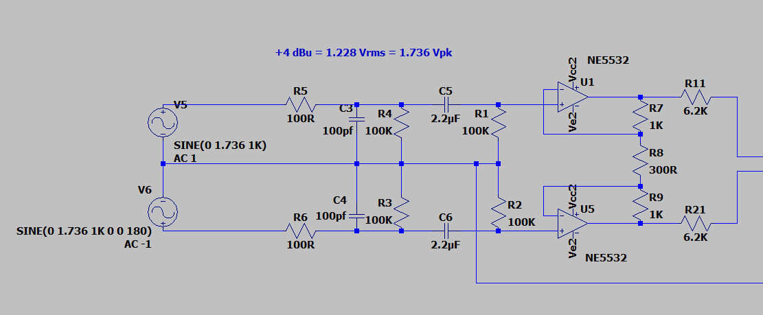

So if I wanted to simulate +4 dBu level for the balanced connections, should I convert 1.228 Vrms to Vpk? That is 1.736 Vpk - which is what I need to use for my simulation?
