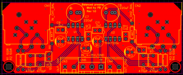

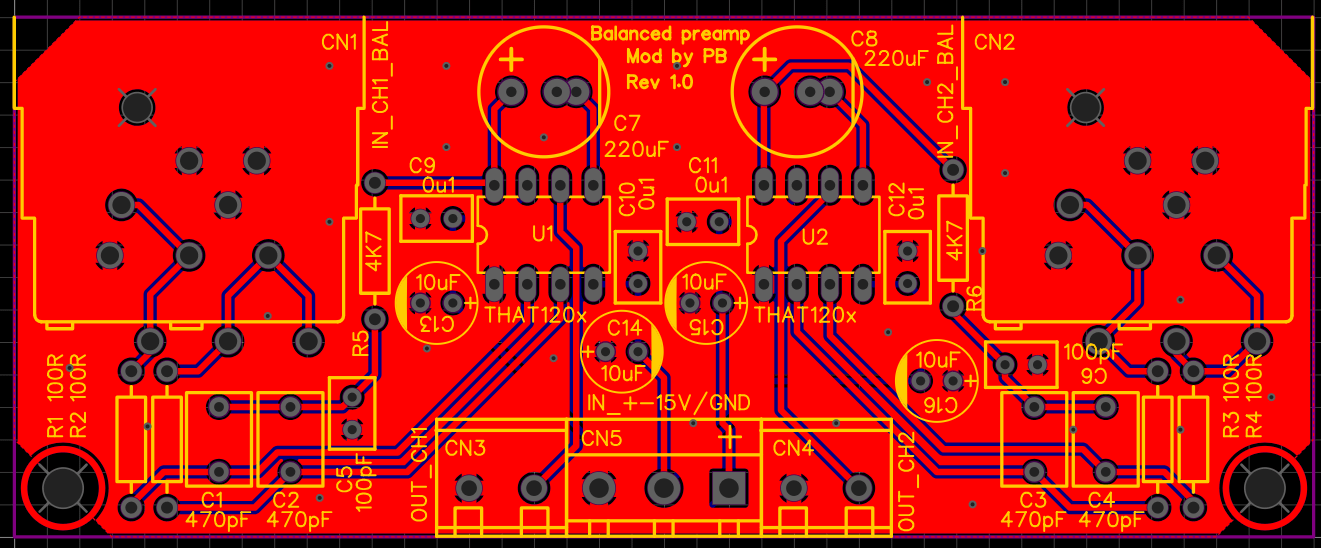

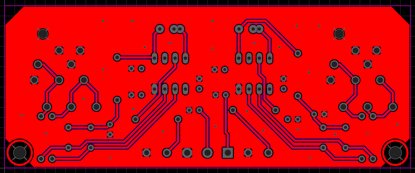

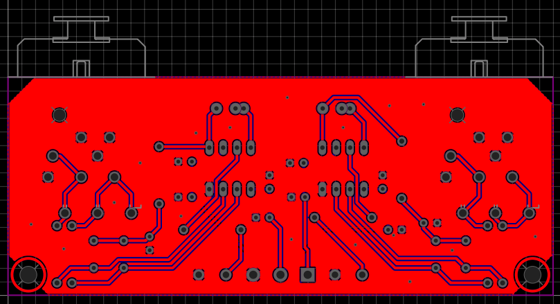

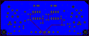

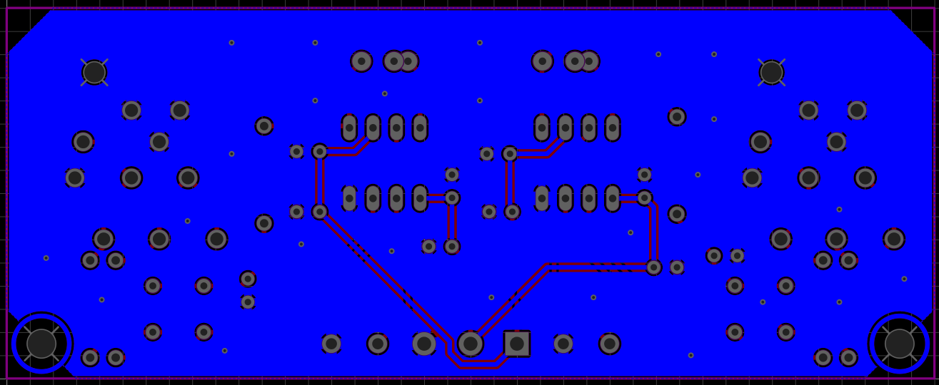

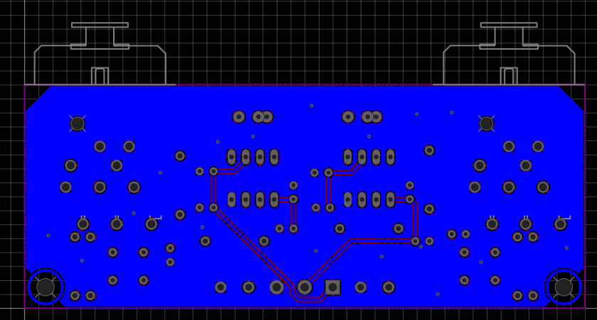

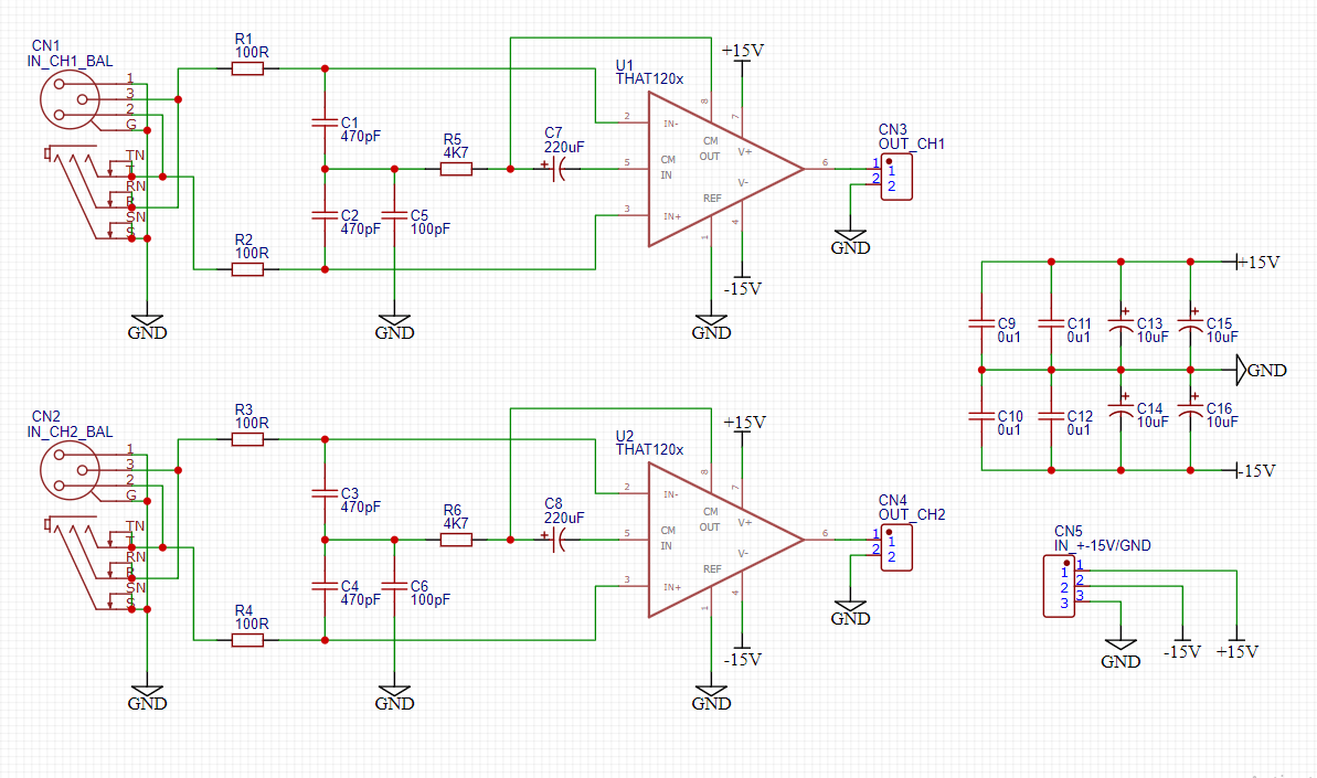

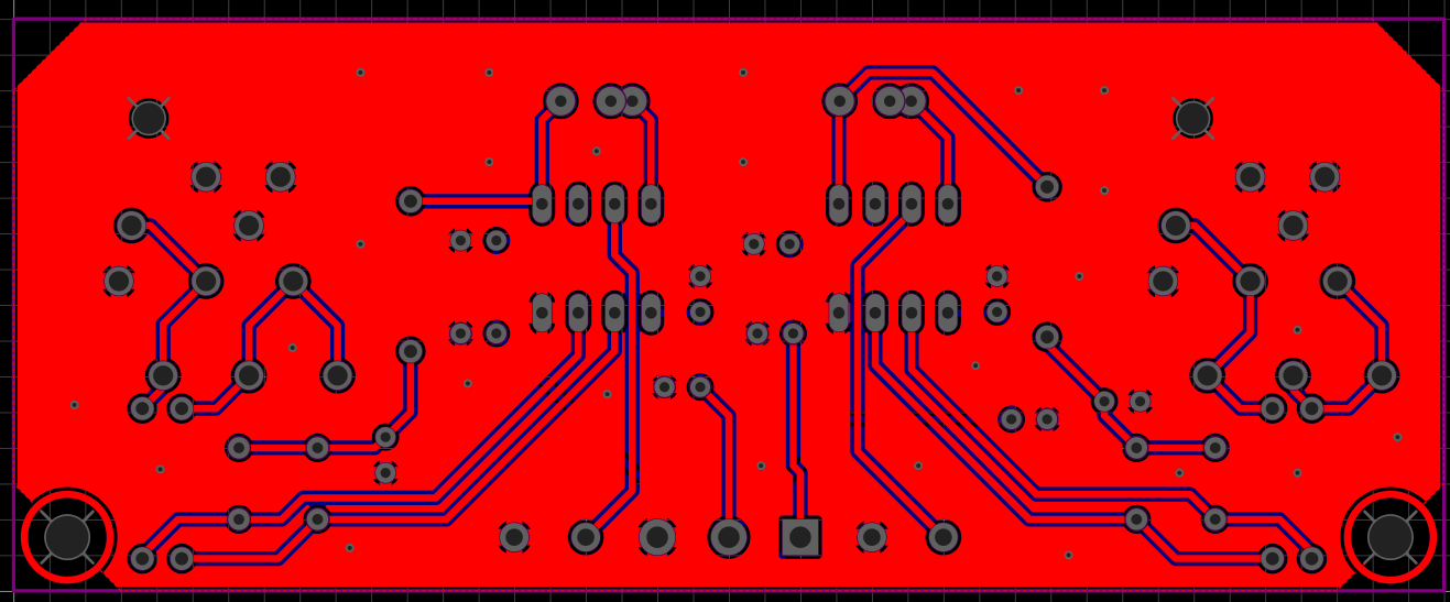

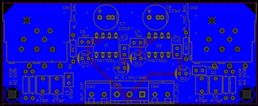

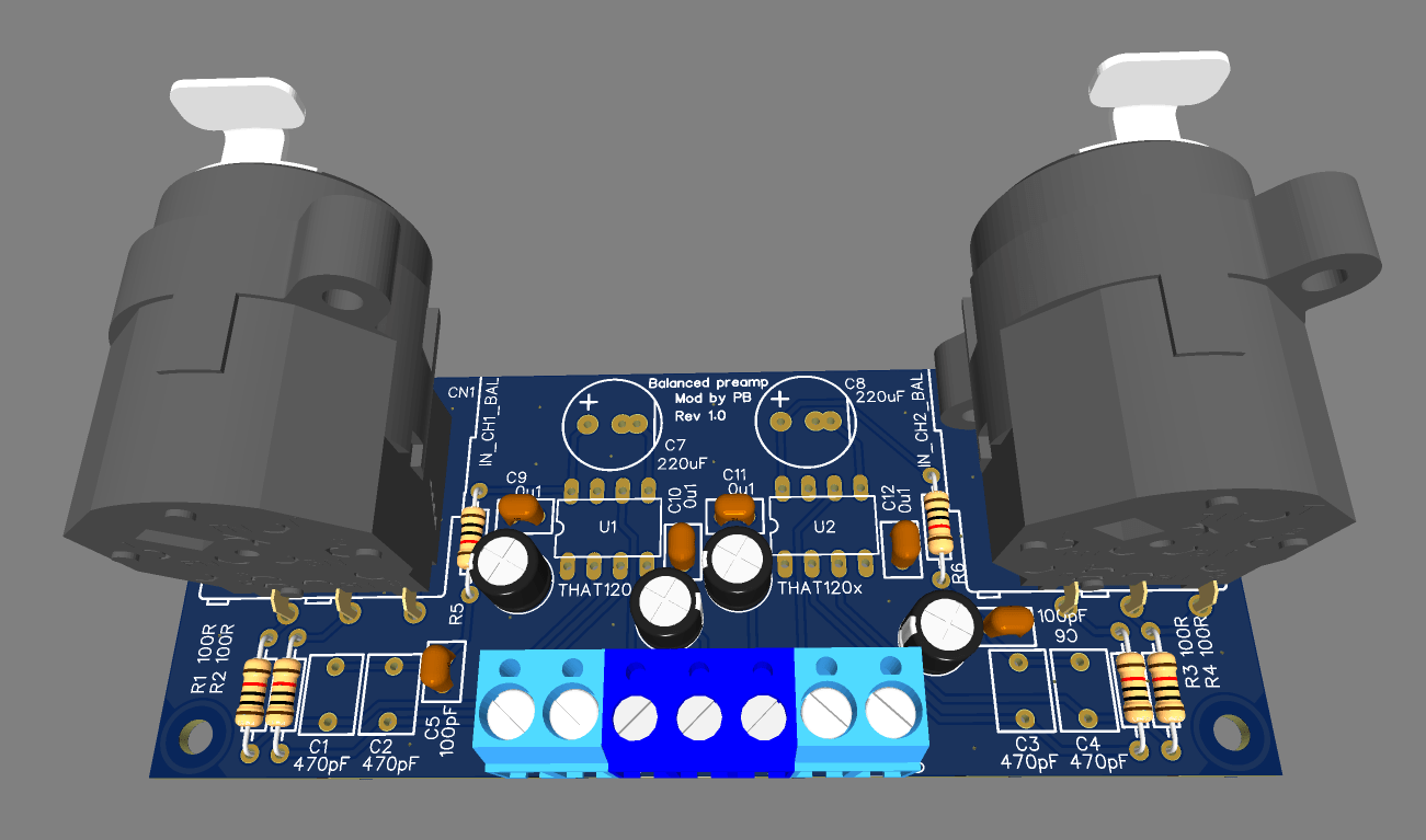

While designing LM3886-based amplifier I desired to have balanced inputs. Few options were considered, but I ended up going with balanced input line receiver based on THAT chips. Below are attached schematics and gerber files for those interested.
PCB has a dedicated space for the XLR / TRS combo connector by Neutric - Mouser part # 568-NCJ9FI-H.
Another cool feature of the board is that both chips are bypassed by both ceramic and by aluminum organic polymer capacitors.
There is no power regulators included on the board - it will need regulated dual +/- 15V power.

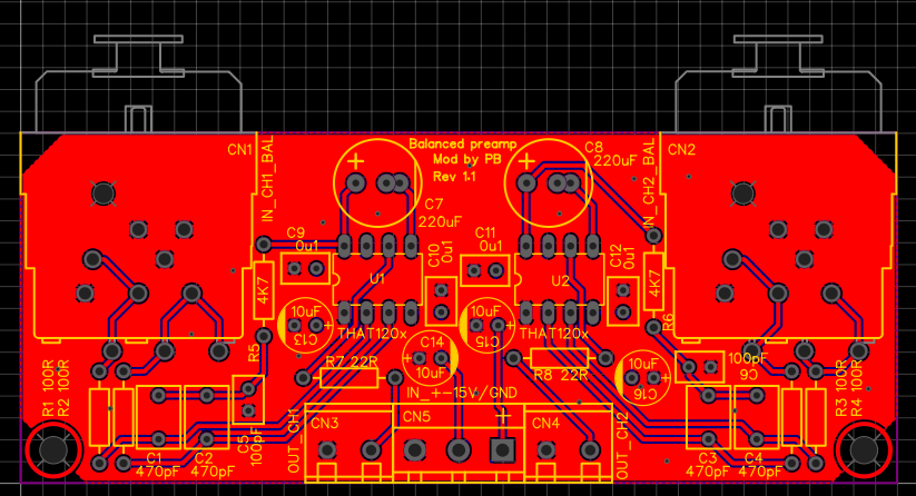

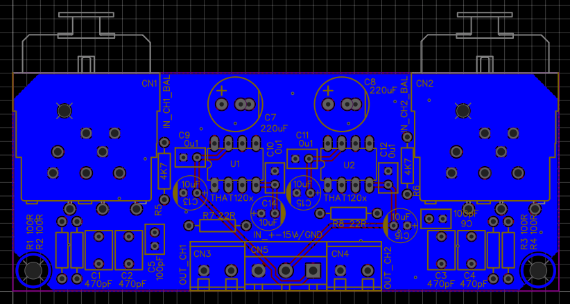

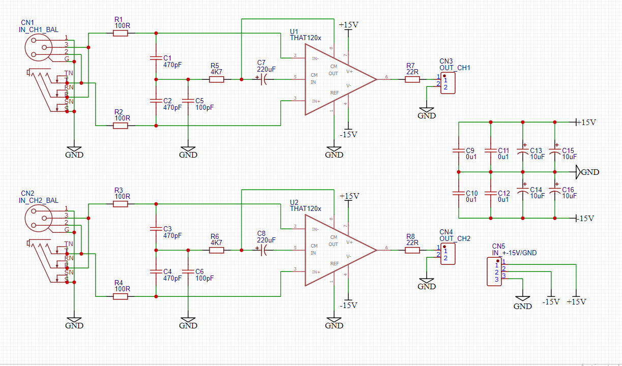

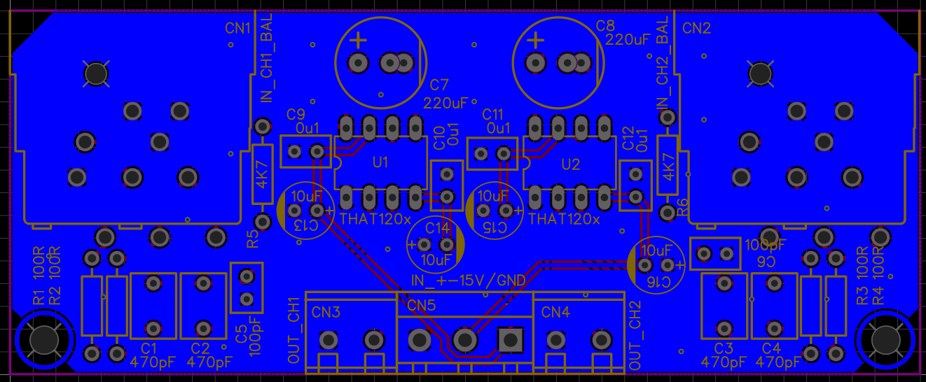

One point to watch out for is the absence of series output resistors on the opamp outputs.
Most designers know that that is inviting instability once you put on output cabling (and possibly load) capacity.
Something like 47 or 100 ohms output series R is normally used to isolate the opamp from capacitive load.
Jan
Reactions: pbilous
THAT120x receivers are able to drive up to 300 pF capacitive loads according to the datasheet. However, attached is the rev1.1 with output resistors. 🙂
